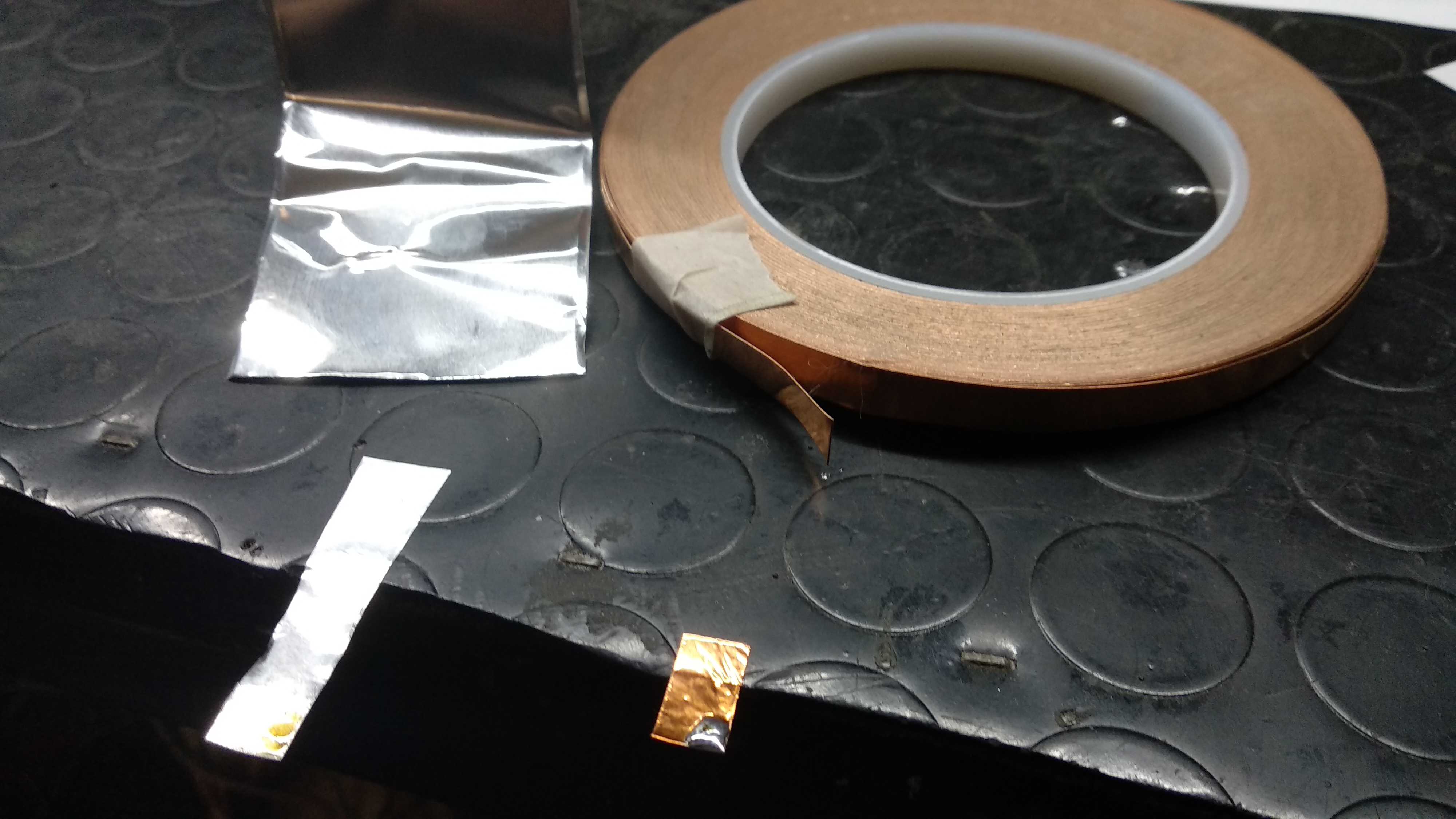

                        As for the coil my plan is to try a 40cm OD coil with double enameld 0,4mm wire,the shielding is that frighttens me because i've never succesfully done one..I was reading Carl's notes on Hammerhead article about coil shielding,the Scotch24 is the optimal choice,unfortunatelly they dont have it in stock...I have 2 adhesive tapes,one with aluminum and one with coper but when i tried once to shield my coil its detection ragnge went down dramatically..How much space should be between coil windings and shielding material?
Name:	Shielding Material.jpg

                          I never found shielding to help on the coils I have built. So my three coils (30cm mono, 25cm DD & a 20cm Concentric) are all unshielded.
                          I had a thread to discuss this but it never went anywhere and everyone just quoted what has been written.
                          I also test coils with temporary mounting, foam board and wood, before doing all the work to encase them. This allows changes and re-testing.

                            As a rough guide, when searching for gold nuggets (8-10us delay) the coil must be shielded. This will provide electrostatic shielding between the coil and the ground, and also stops electrical noise.
                            Use > 15us for the beach, and 30-50us for coin shooting.
                            Longer delays (typically transmitting at 100-400pps) do not need to be shielded.
                            [ATTACH]46340[/ATTACH]
                            Wind spiral wrap on top of the coil before adding the electrostatic shield.

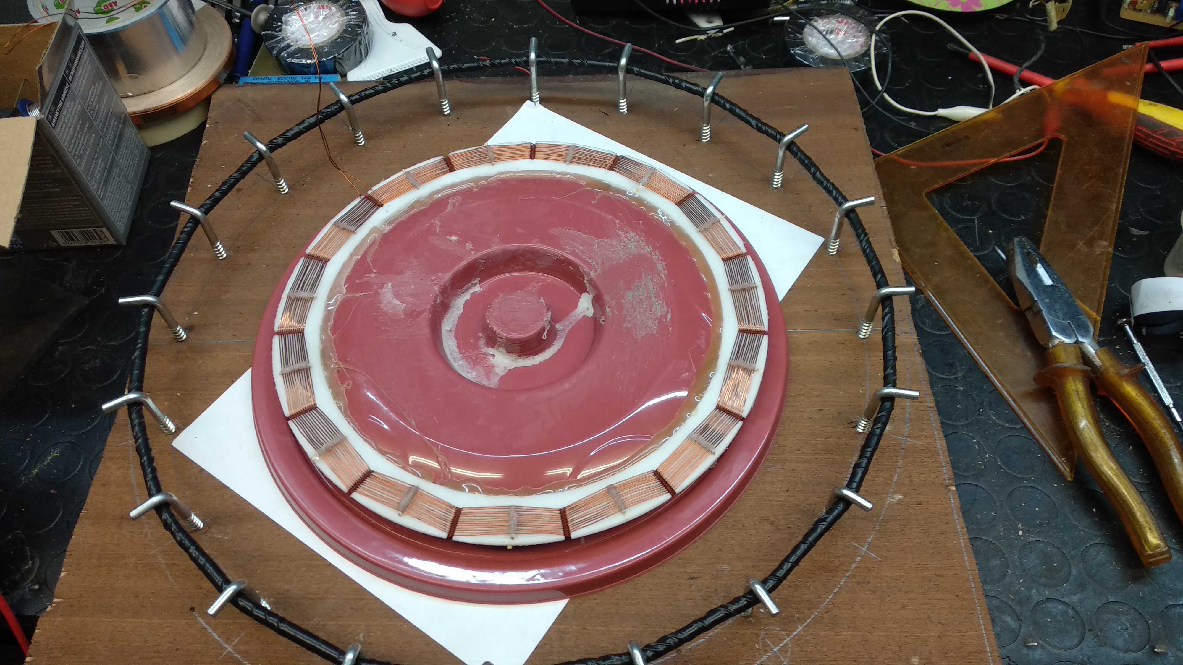

                              I've just finished a simple 36cm OD and man thats hard to keep it rigid...I wound 18 turns of 0.4mm double enameld wire,stabilised with electrical tape,then plastic spiral wrap and then another layer of electric tape..Still did not figure out how to make it rigid,tommorow i plan go to a friends router and engrave a circular pattern on wood,stabilise it in there end then epoxy it...
                              I wont dare the shielding at the moment but i thing i will have to because the inductance read about 400uH,shielding will lower that right?
Name:	Mono 36cm OD vs Spider 24cm OD.jpg
