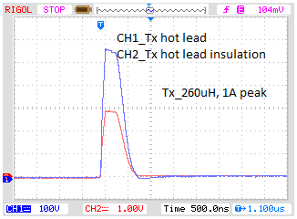

        Look good. The pictures in reply#22 showed damping adjustment but the Tx current was a lot lower than it should be. Fixed the problem and recorded again, scope probes connected to Tx hot lead and hot lead insulation. Amplifier out is most important. I like looking at coil decay and amplifier out when adjusting damping. Is underdamped, overdamped or critical damped best? Scope probe connected to Tx hot lead can have a small effect on damping so I usually connect the probe to the wire insulation. Also don't have to remember to switch probe to X10.
          ... scope probes connected to Tx hot lead and hot lead insulation. Amplifier out is most important. I like looking at coil decay and amplifier out when adjusting damping. Is underdamped, overdamped or critical damped best? Scope probe connected to Tx hot lead can have a small effect on damping so I usually connect the probe to the wire insulation..
          What do you mean by hot wire insulation?I measure with score ground to TP5 and probe to R4 (near trimmer side),im confused...
          Here is a video as godigit1 said ch1 yellow (probe to R4 trimmer side and ground TP5) and ch2 (probe to TP3 ground TP5)...With 2,2 kohms pot
          Also notice on R4 hot side voltages goes up to 600V...I thing im violating irf840 characteristics?

            Hot wire is the coil wire connected to MUR460 diode. I use twisted pair so it is easy to clip probe to wire coating(insulation). Coax center wire has a thicker coating, might be harder to clip to. Maybe less signal.
            I use a 11N50M2 MOSFET rated minimum break down 500V same as IRF840. I get 550V and you get 600V. Don't know how much higher than minimum to expect.

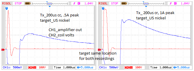

                  What do you mean by waste energy? I have thought signal strength is proportional to peak current. A test with .5A and 1A peak Tx current. Damping was adjusted for peak volts to not reach MOS FET break down with .5A peak current. My tester controls Tx current either .5A constant current or 1A constant rate. Think double the signal with 1A peak is due to double current not constant rate vs constant current. One way to keep peak Tx below break down is to limit current to (break down volts/damping resistor). Any other ways? Someone posted in another thread awhile back, time at breakdown doesn't effect signal strength. My test shows different, am I doing something wrong?
                    When the MOSFET is switched off, you want the all the energy stored in the coil to contribute to the collapsing field and provide maximum energy transfer to the target(s). If you exceed the MOSFET breakdown voltage then some of that stored energy will be dissipated (wasted) within the MOSFET. So, if your MOSFET has a breakdown voltage of 500V, keep the flyback below that figure.

                        Still not sure your definition of waste. Did a search and one definition is serves no purpose.
                        Someone posted in another thread awhile back, time at avalanche doesn't effect signal strength.
                        I could read your statement that energy dissipated at avalanche is wasted(serves no purpose) and doesn't add to signal strength confirming the posted statement. Is that what you mean? Not suggesting operating at avalanche is ok, just thinking it's not wasted energy.
                        Avalanche current does go through the battery so it does increase average battery current. If I did the math correct at(1000 pulses/second). Average coil current is 100ma and avalanche current adds less than .5ma to battery current in my example(damping adjust3).
