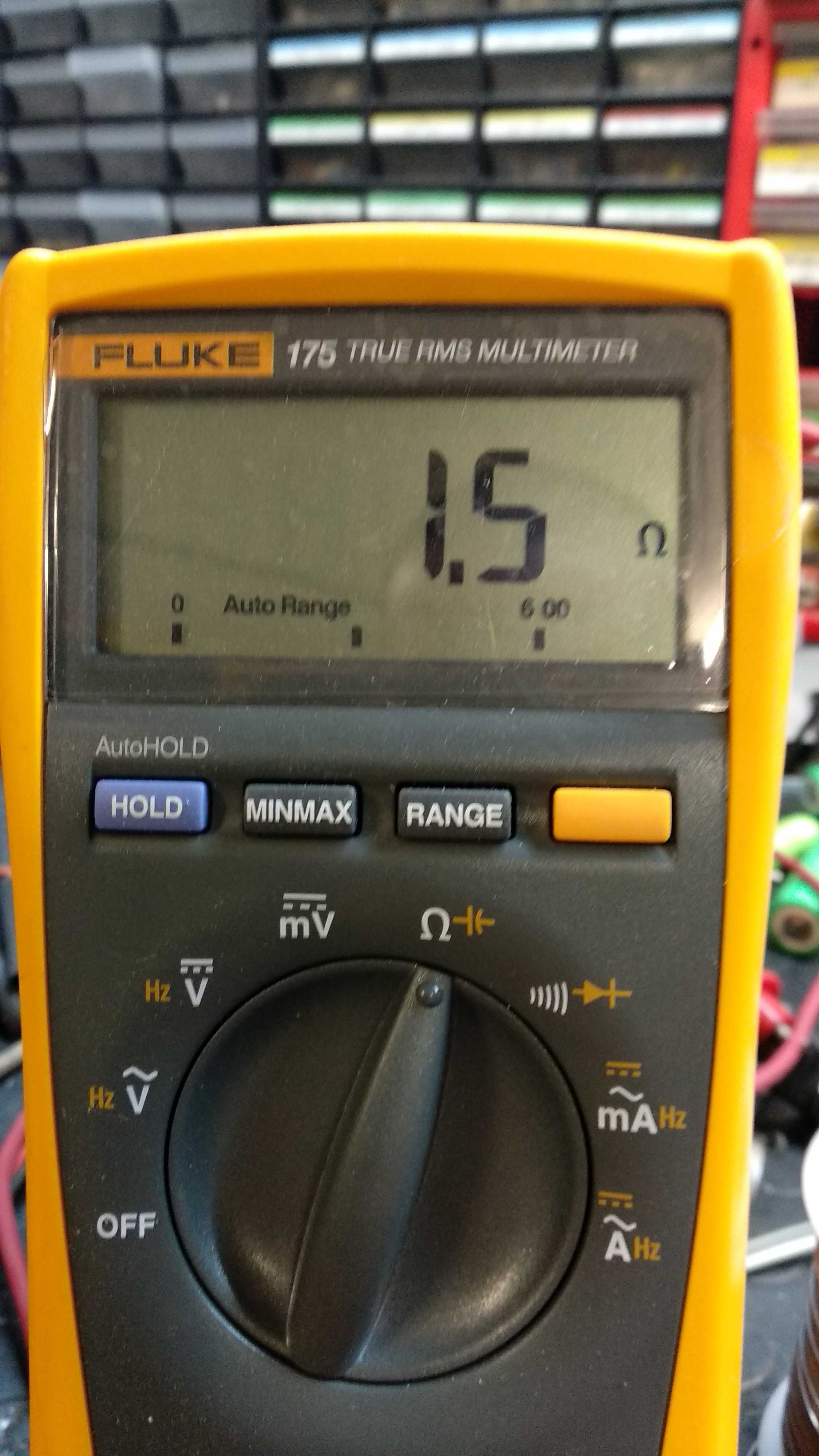

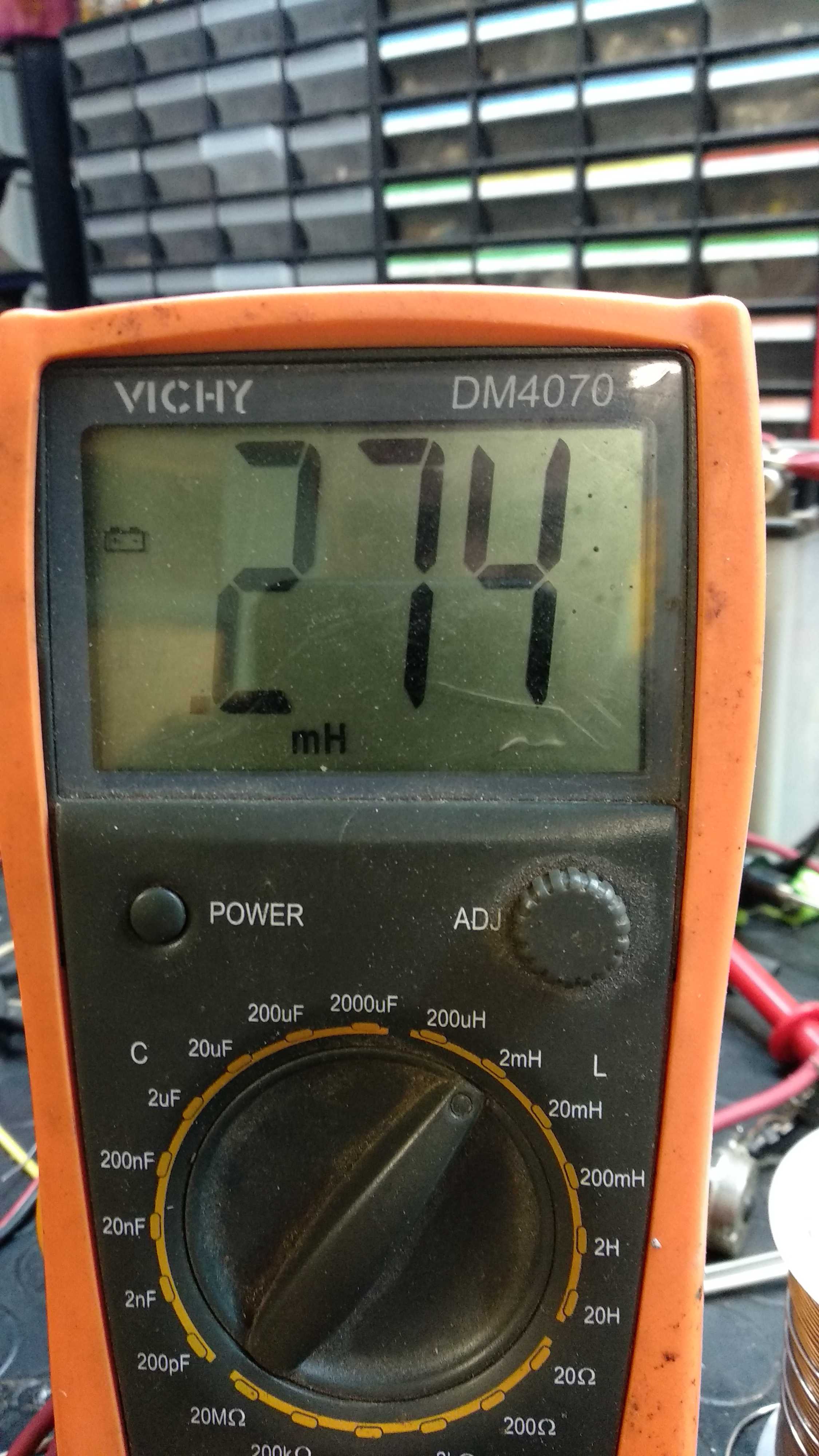

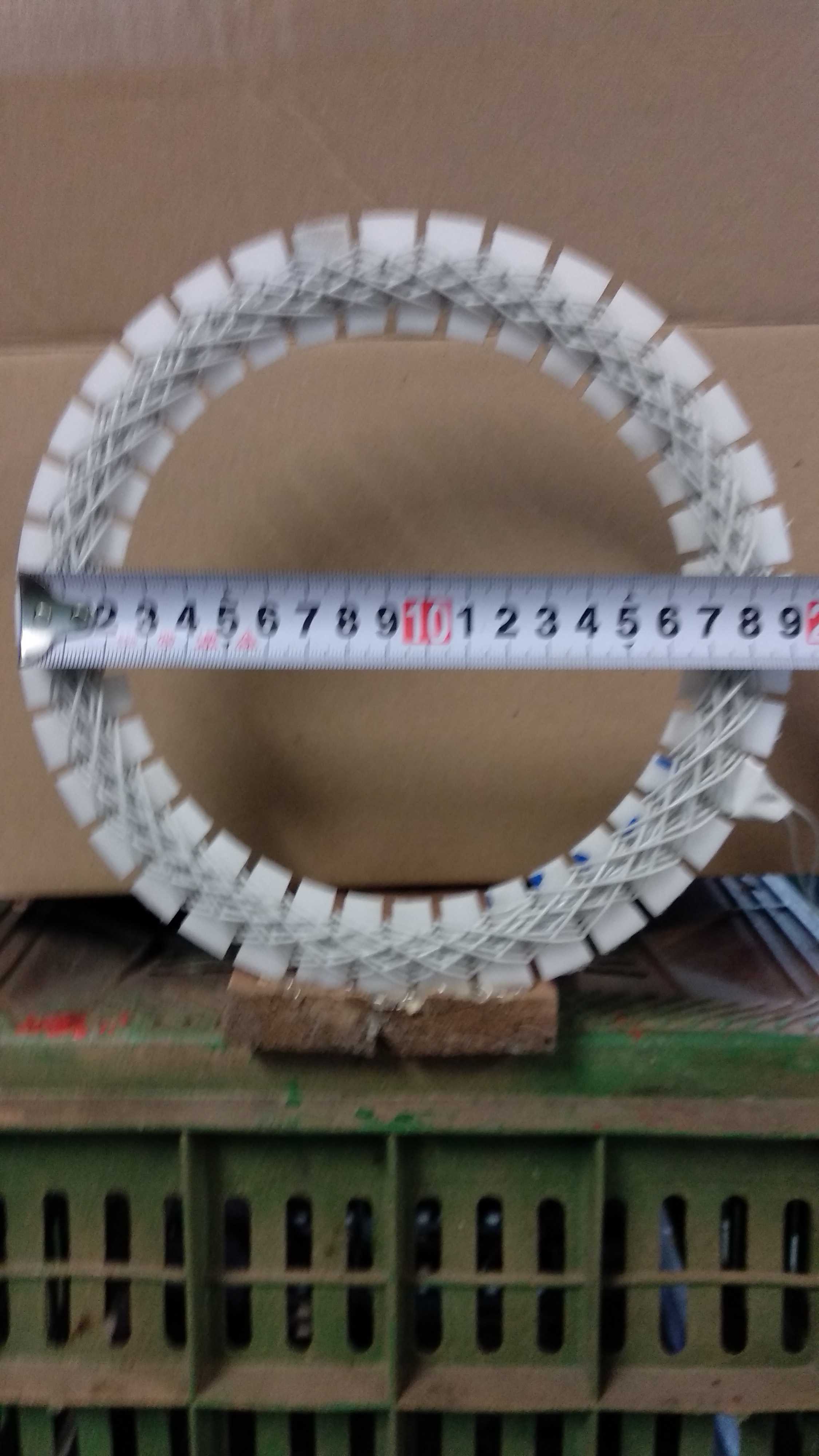

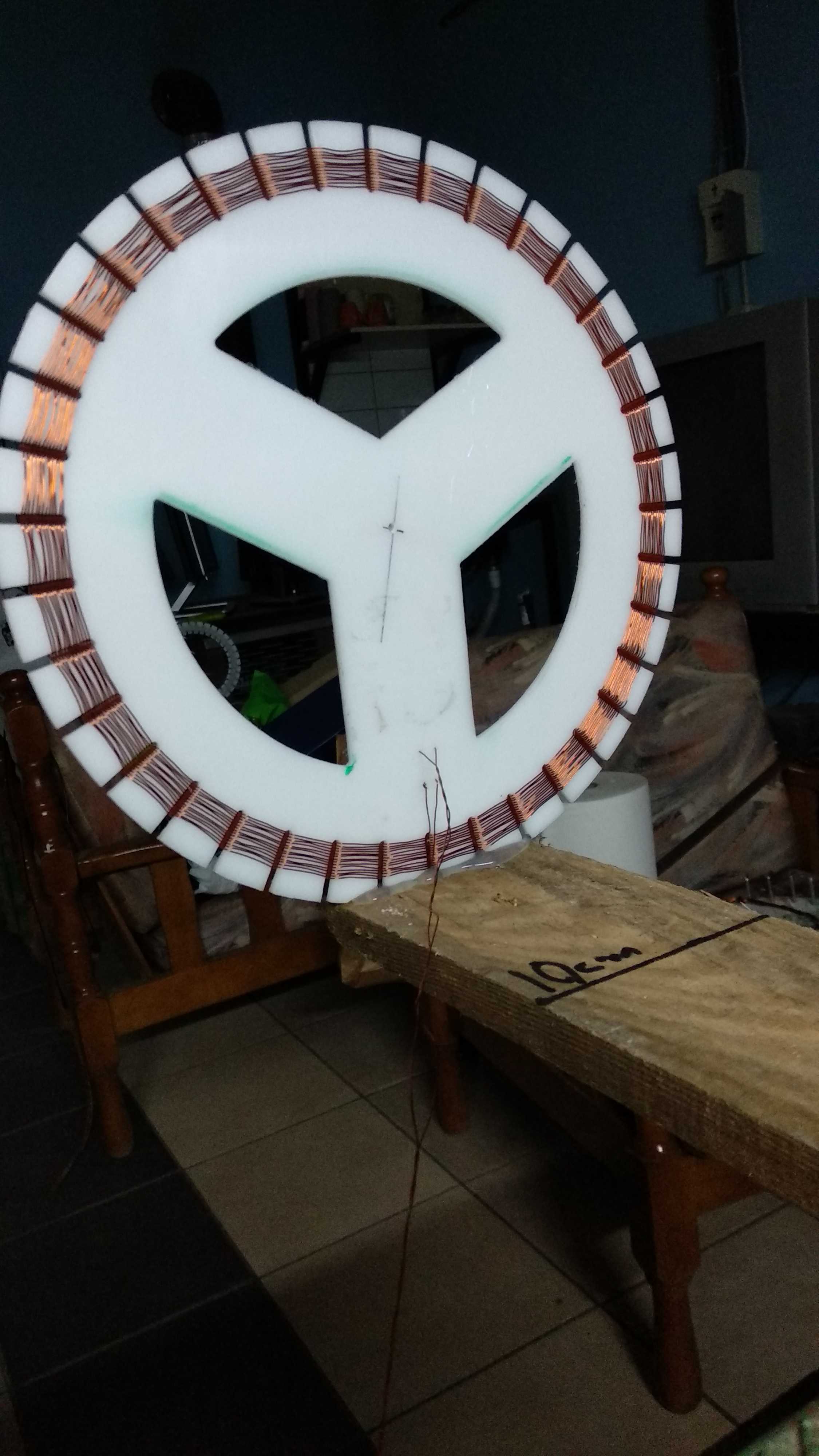

        Hi guys,i dont know if i should be sad or happy..I still cant understand the hole dumping thing,please forgive me but my knowledge is incomplete in this area.
        I've just connected the 3dss i made from 0.64mm ETFE cable.Here are the results:
        Sad because i couldnt get the right size at outter diameter of 20cm.
Name:	3DSS wrong OD.jpg
        Sad because i couldnt get the right inductance at 300-400 uH
Name:	3DSS wrong  Inductance.jpg
        Sad because i couldnt get the right resistance 3-4 Ohms
Name:	3DSS wrong Resistance.jpg
        Happy because the coil works GREAT!!!! I detect and 1966 English gold coin at 25-30cm,i detect my chain with cross at 10cm and generally i detect gold!!!!!The can of soda starts at 65-70cm!!
        Although i am happy i would like to learn,why all went wrong and the detection came out right?

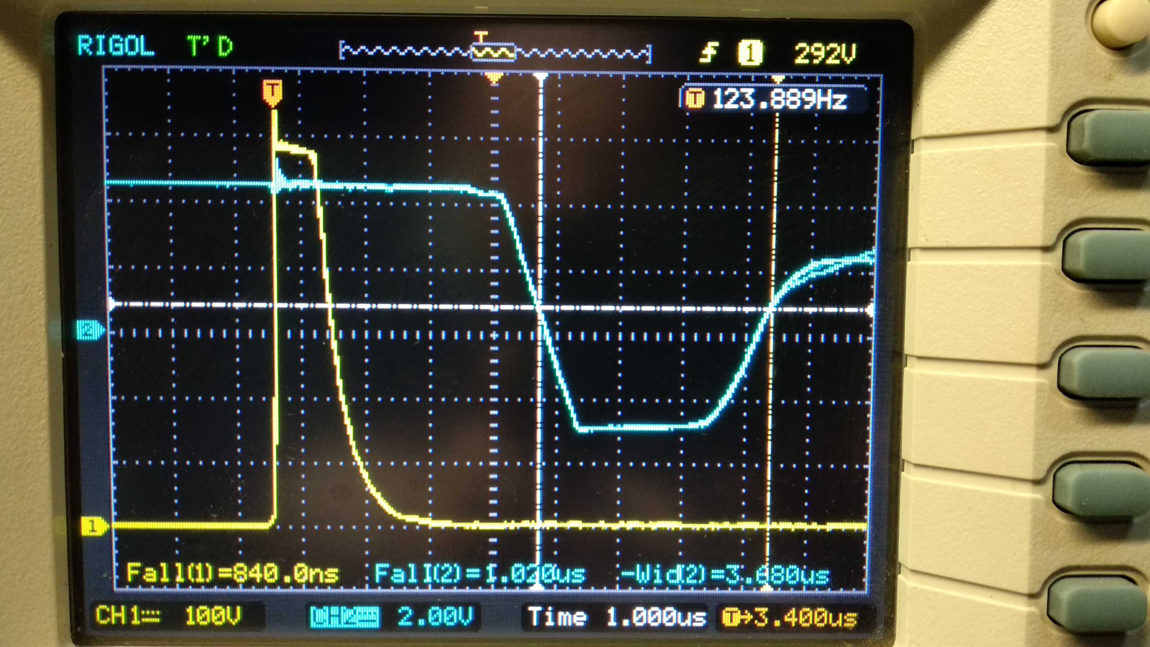

        Hi godigit1,thanks for your reply and the usefull intel..I would answer to your question (are you looking for the ability to test below 6 us) if i could but i dont,what do yoy mean by 6us?
Name:	CH1 Coil CH2 TP3.jpg
        How does this coil seems to you?

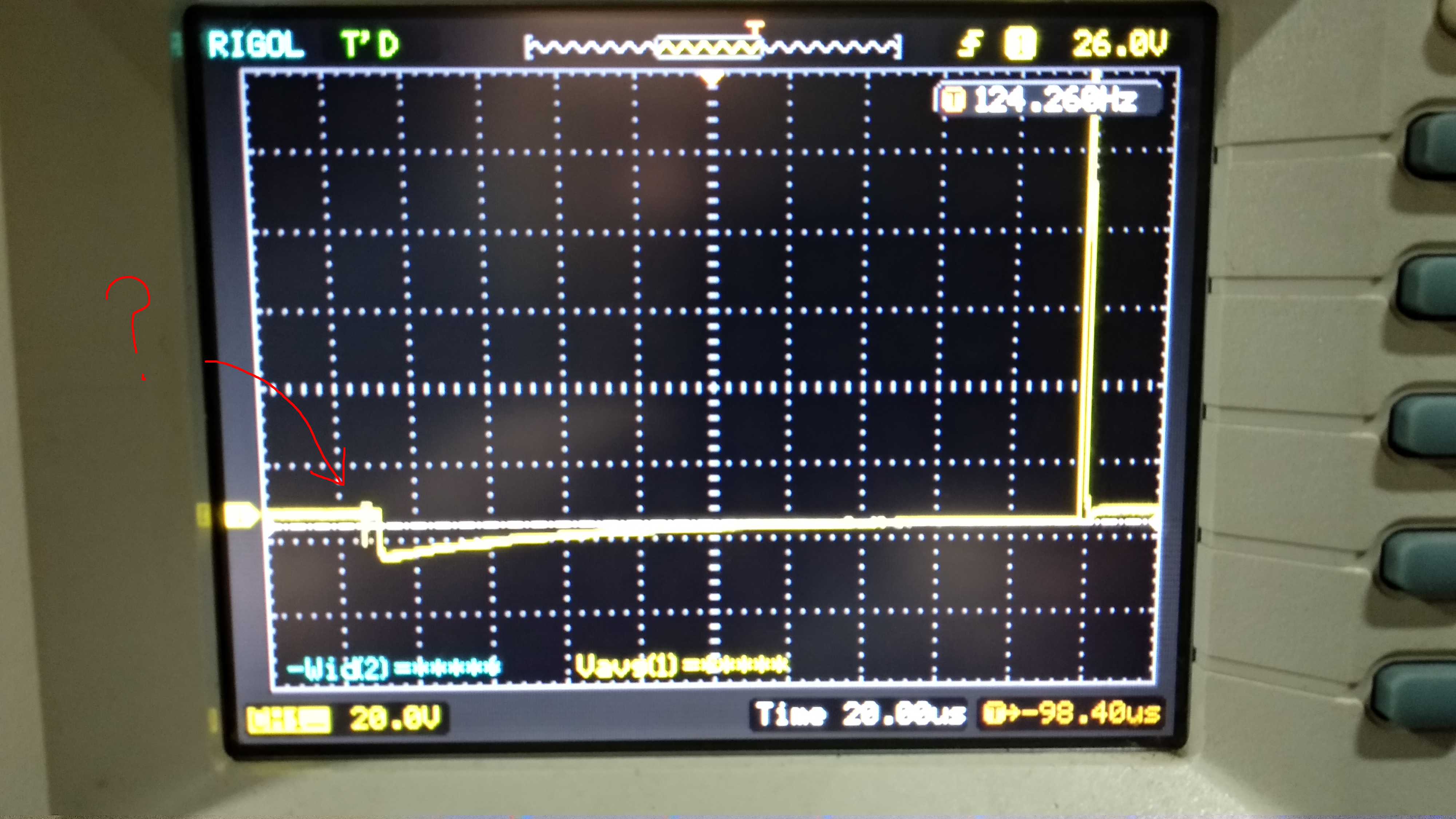

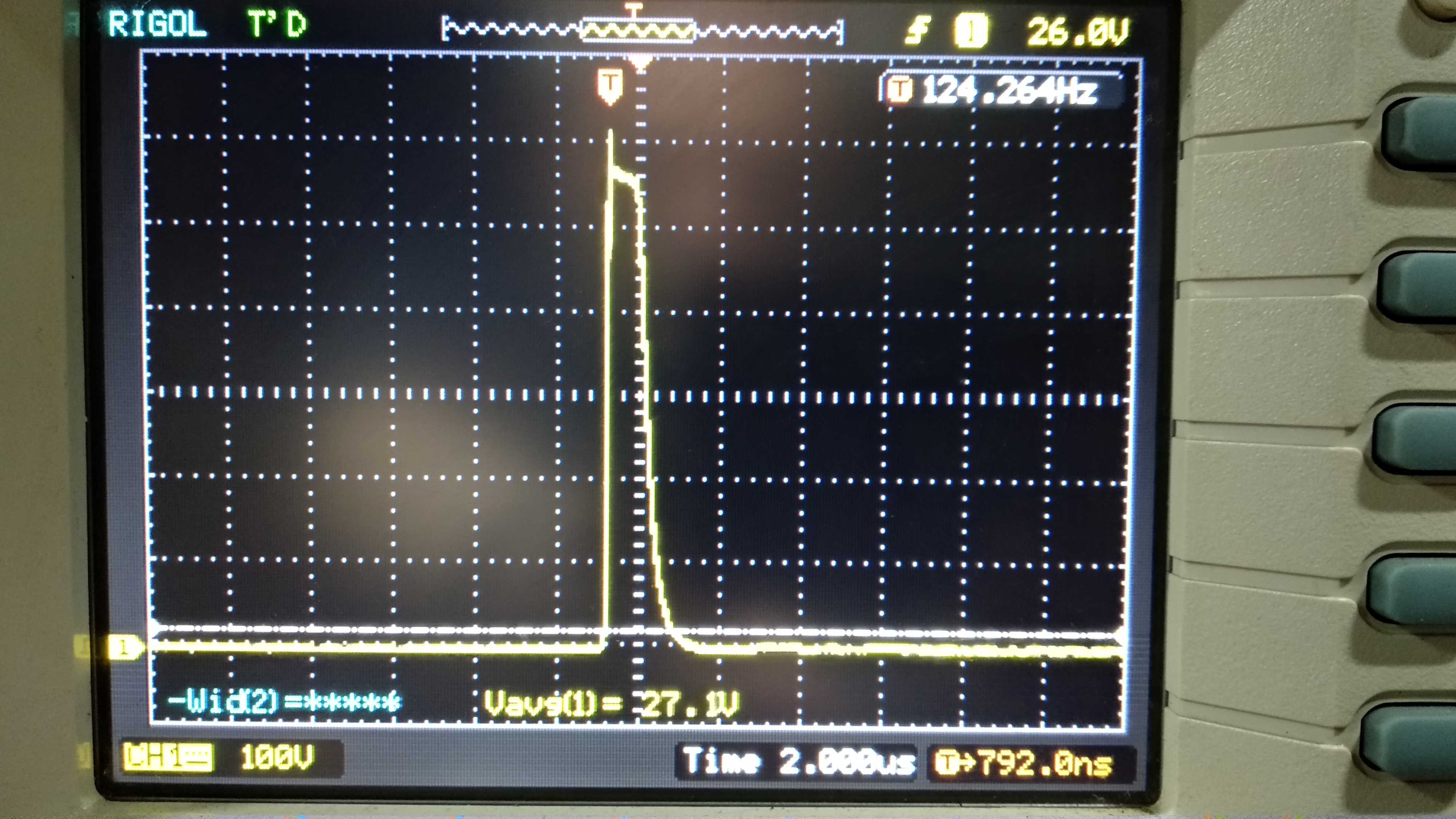

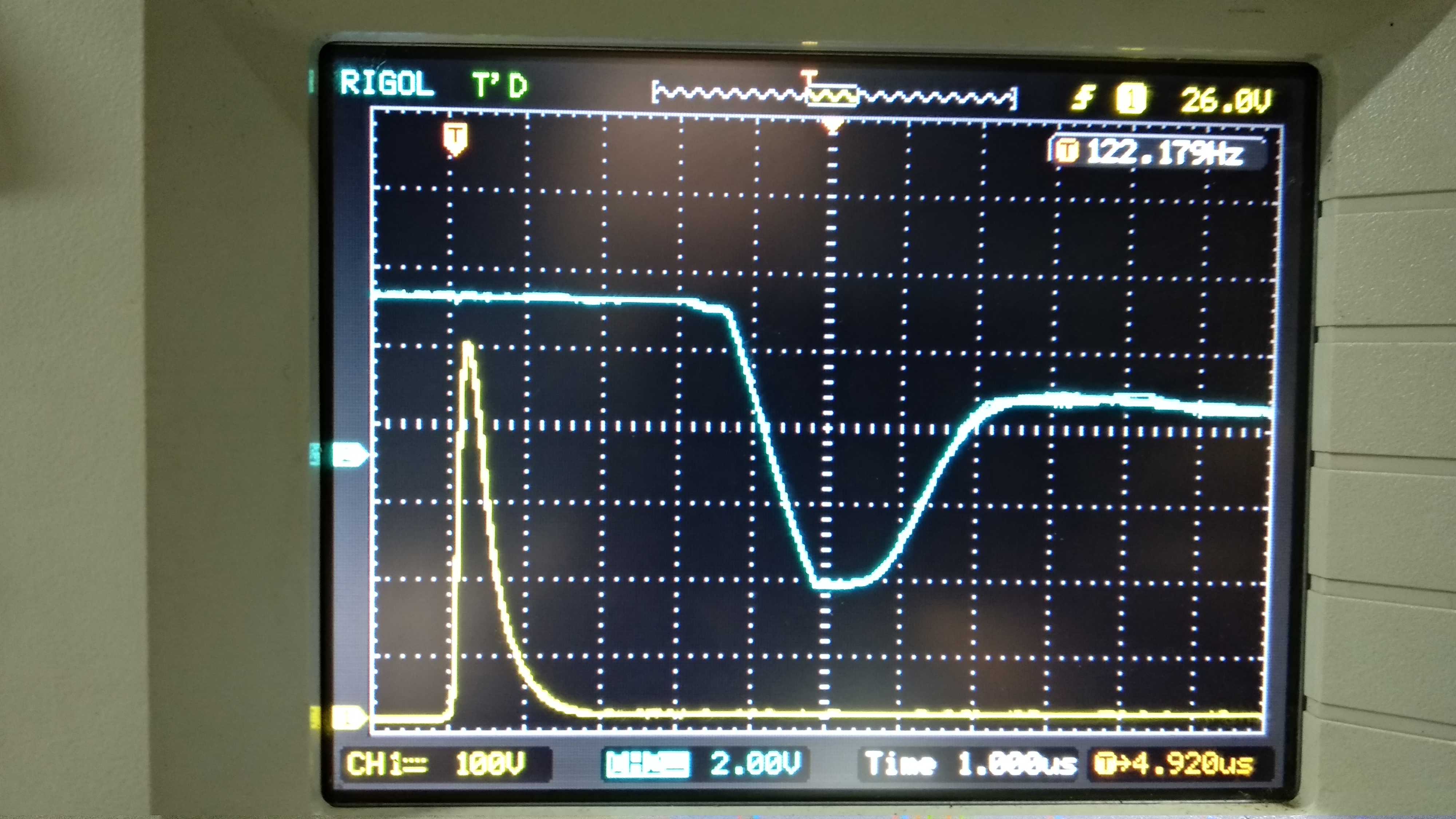

              • #67
                Hi Mushaba,
                From the Build doc:
                "Monitor the signal across the damping resistor using an oscilloscope with x10 probe, where you should see a flyback signal of about 350V or higher."
                I dont know if your still on the Hot of the coil or not? But look at the damping resistor at . R4 pl2 side .
                Does your signal there still flat top at the end of the spike?
                I just got over being sick, and just got two MPP running again so tonight I can check mine at the hot side see if that is there as well. Ive never tested that way but Im always learning.
                To me your coil looks slightly over damped. Back things off to 5us and take a shot turn off averageing if you have it on.

                    • #70
                      Also I just got to thinking, you and I have the same inductance meter. I have found mine to be unaccurate by about +-30% down in the uH ranges its good higher.
                      I found this out when I sent Green some coils for testing a couple years ago and he measured different values than I did.

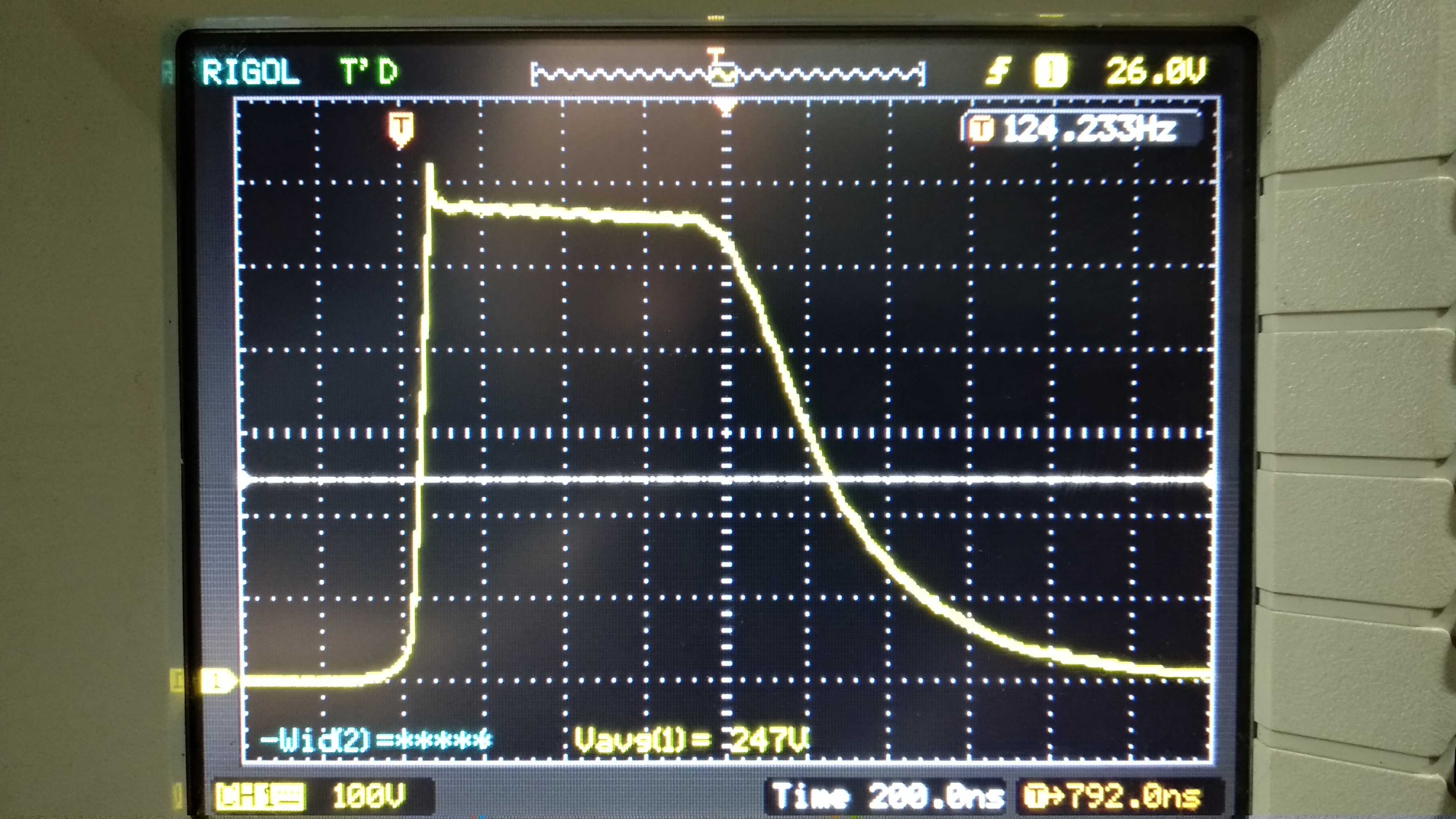

                        Hi godigit1,Thans for your reply and help.yes
Name:	R4 PL2 Side.jpg
Name:	R4 PL2 Side Detail.jpg
                        What is that negative voltage,what is happening there?
Name:	R4 PL2 Side All.jpg
                        What is your final Resistor value?.
                        Hope you get well soon!!I must do something wrong at the damping process,i connect a pot instead of R4,i didnt see differences if i connect (the resistor parallel reistor+pot)..When the output (TP3) has the smallest (negative) duration i disconnect the pot measure the resistance and put a resistor to place...The above pictures are with 3300 Ohms R4..
