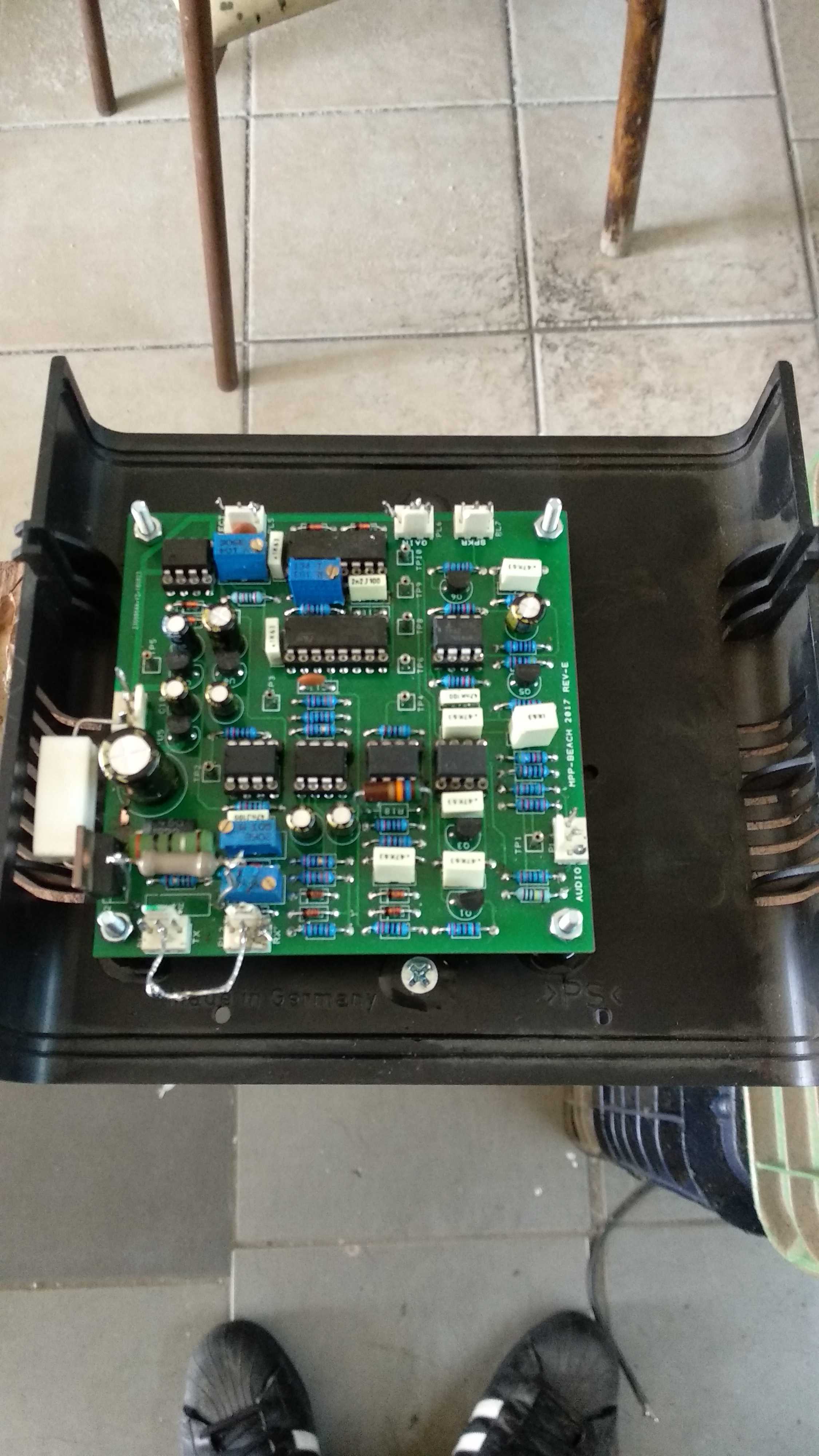

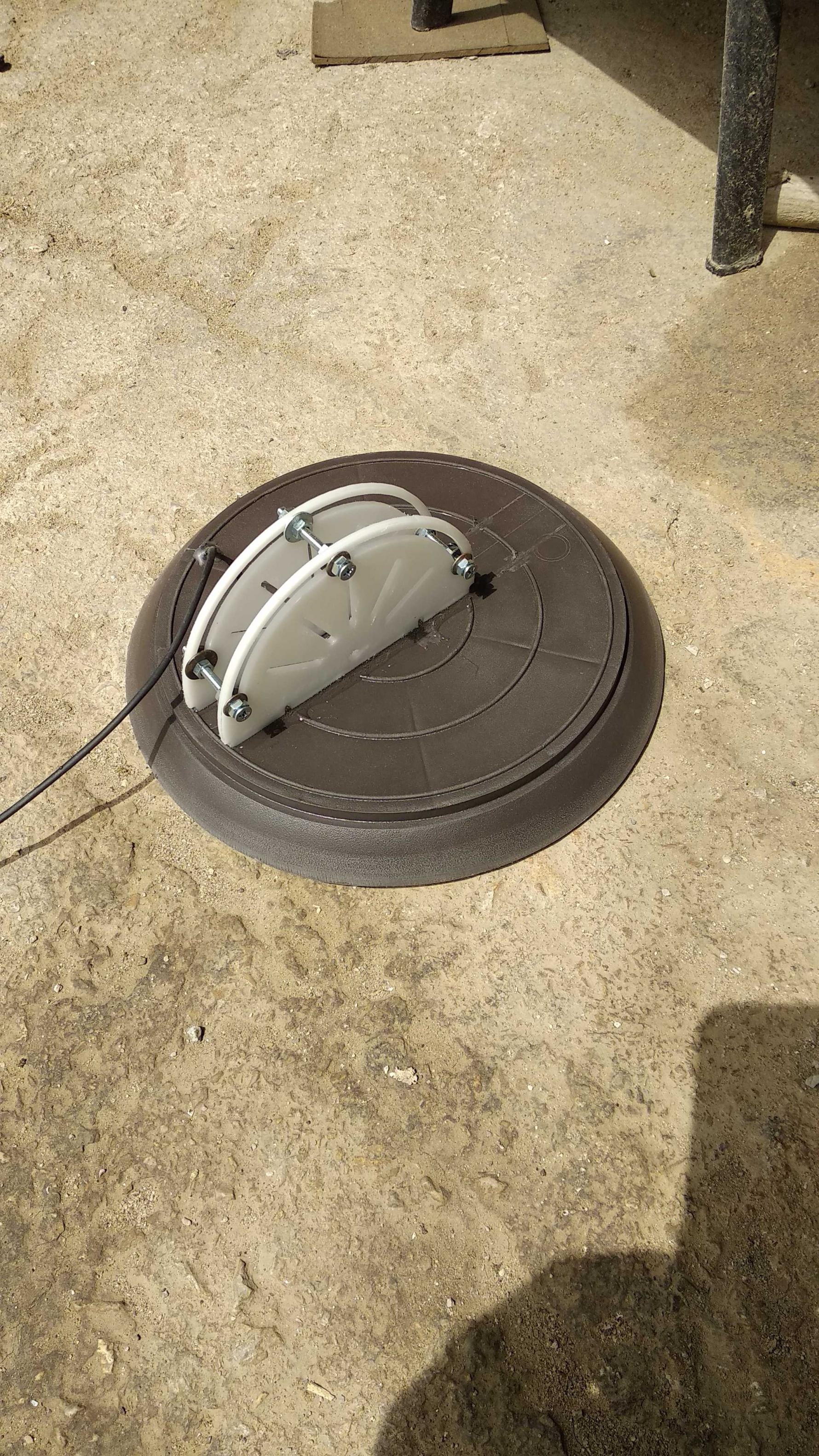

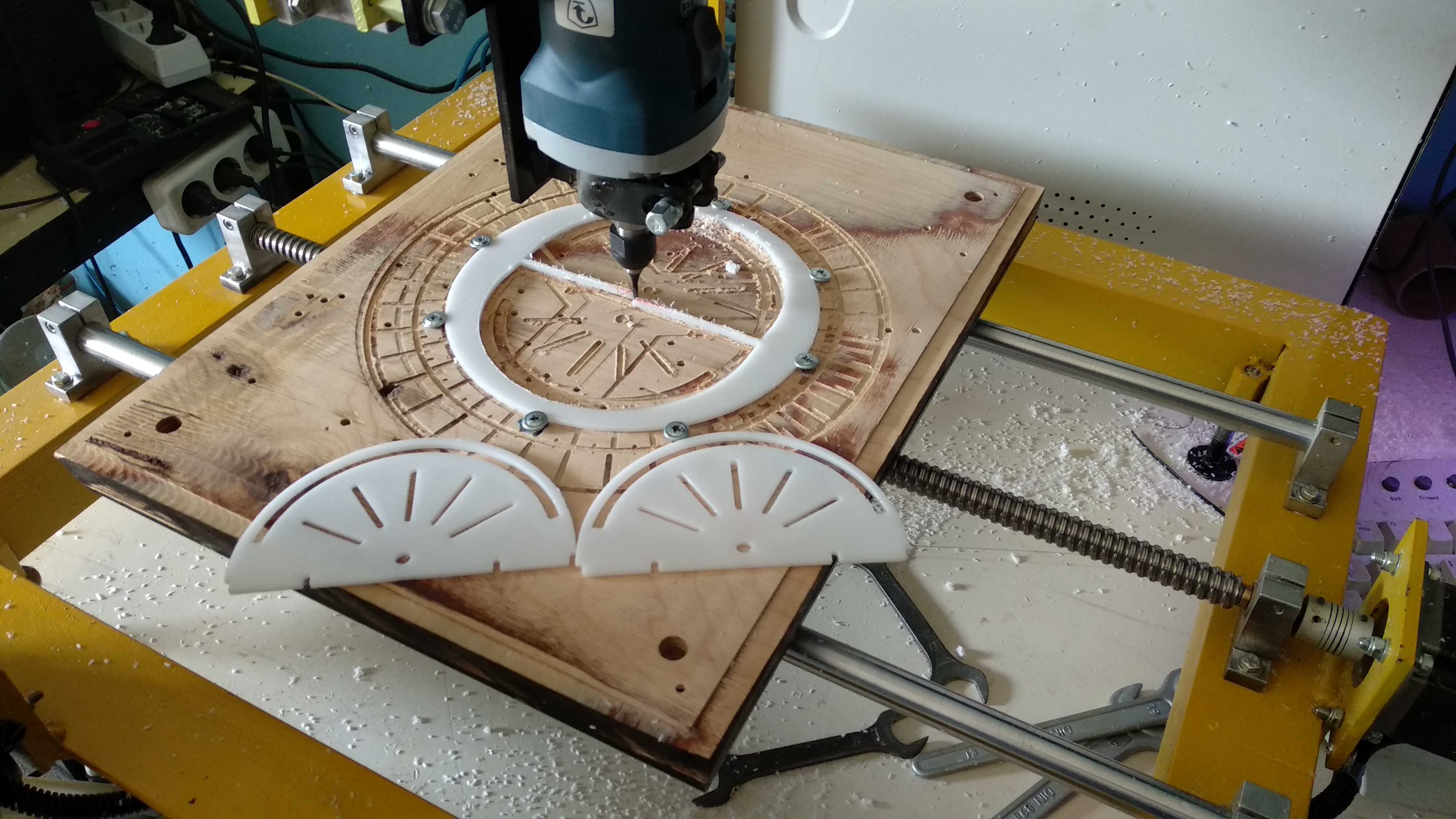

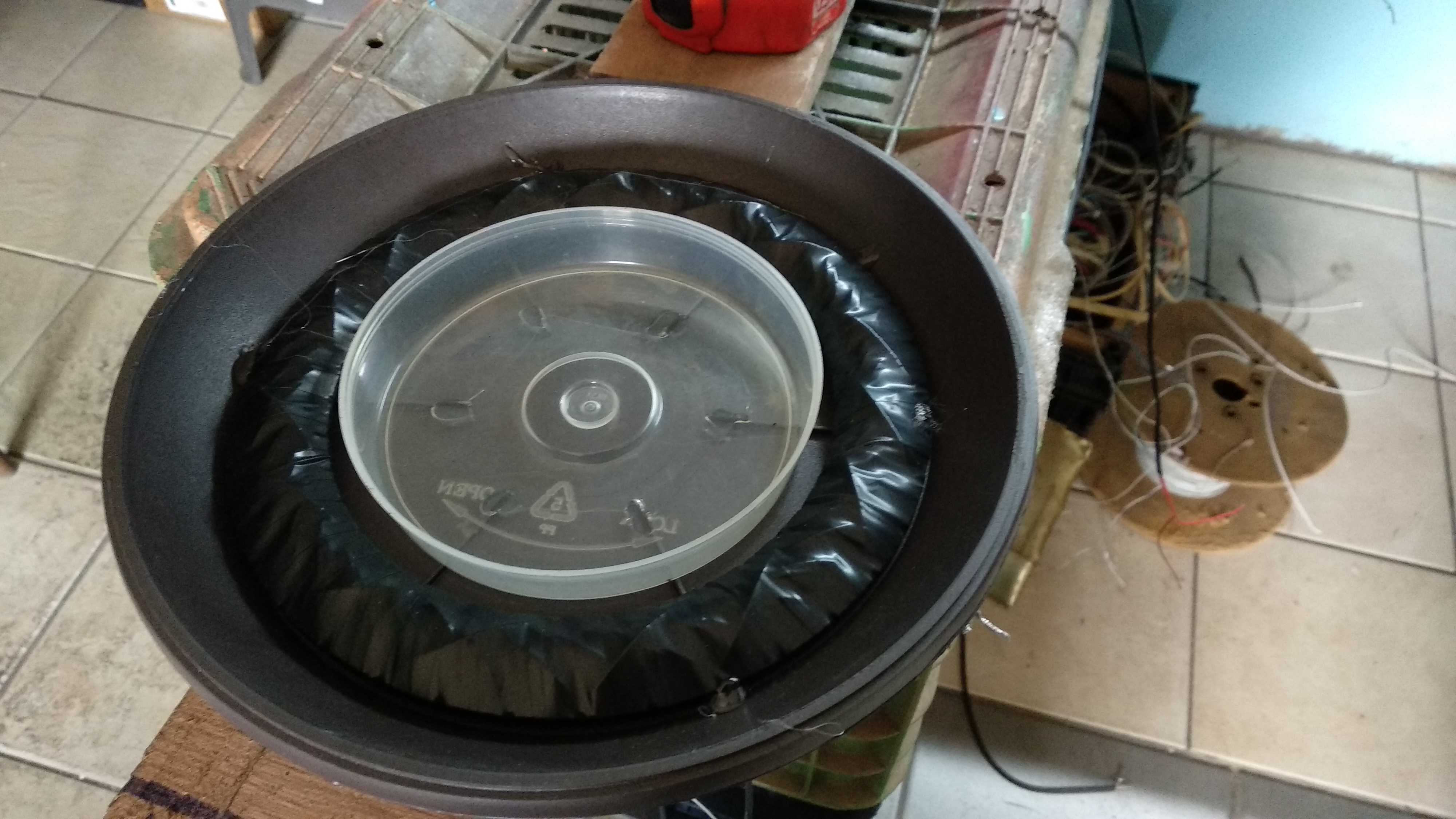

              • #97
                Hello!!
                Back again,last 10 days were crazy around here left me no time to work with my MPP..
                Read a lot all post from this topic and lots of others,still some things blur to me so be,ready for some rookie questions again
                1)To calculate my TC i should measure resistance of the coil plus the "current setting"resistor (R10).Also plus the 5 Ohms resistor i added to reduce my spikes before the mosfet goes into avalance. Made a coil (3dss 24mm OD) 390uH 1.4 Ohms. 1.4+3.3+5=9.7 Ohms. The TC=40.2us mutiplied by 3 so tx pulse should be around 120us.I added the 1 Ohm resistor to power supply of the mosfet and the current flats out at 100us give or take. Now to criticaly damp(maximum reading at coil side and no ringing at amp out side) i use a 5k pot,is it right or wrong??My damping comes out at 1.8k
                2)I want to place the damping resistor inside the coil housing (parallel with coil ),will it affect the coil reading?Because of solder (as a metal) ??How come VLF machines i've seen have aluminium brackets and mounts and they are not mess up the coil readings???
                3)Found that Vishay has a 1N4448 named diode similar to 4148 with half the recovery time (2 ns) do you think is worth the trouble?
                4)Also found that RG62 has half the capacitance of the RG58,think im gonna use that..
                5)Made the Krinaz mod for the audio threshold (removed the 1K from each side and put 470K and 100k trimmers,)the adjustment is much stable.Also placed a 5k trimmer in series with R21 for sensitivity adjust,at the air tests i didnt see much difference..
                6)Last but not least about timmings..The "cycle" beggins at TX Pulse rising,then we have a delay for coil to settle down,then we sample,then we delay a little more and finally we get the 2nd sample.Adding all time i think there is plenty left for us to increase the frequency of the Tx pulse right?I have set about 2,5Khz..I assume it will be more energy consuming,mosfet will get slightly hotter but what is the factor of selecting the frequency?Also noticed that if we change the frequency of the tx pulse we should have the EFE and the SAT circuit quicker (i didnt do that)..
                Your advice for once again is needed!!Thanx!

                • #98
                  1) Calculations are good and a 1.8k damping resistor indicates low C in the coil and cable.
                  Later you can try experimenting with other pulse widths but a 120us pulse will be good for many targets.
                  The important thing is not the allow the MOSFET to avalanche.
                  2) I would not put the damping R near the coil. Best place is inside the coil cable connector at the circuit housing. Then you can switch coils since the damping R is matched to each coil.
                  Any metal near the coil increases the decay in a PI detector. VLF detectors can get away with this if tuned with the metal near the coil.
                  3) Don't know so try it and let us know.
                  4) Lower C cable is good.
                  5) ok.
                  6) Experimenting with the timing is good. In theory the faster the pulse rate the faster the integrator output raises which means more sensitive.
                  Is the MOSFET getting warm now? If not then faster pulse rate will not be a problem, it just increases the pulse duty cycle which means a higher average current draw, shorter battery life. This probably will not be a problem if you get 6 hours instead of 7 hours. It is not hard to measure the average current draw with a DVM. Just put a 1 Ohm resistor is series with the battery and measure the Voltage drop which then equals the current.
                  I run my HH2 at 1500Hz with a 100us pulse, about 800mA peak, and the average current is 180mA. I get a good 5-6 hours with a 3-cell, 1800mA-Hr LiPo battery.
                  Construction looks good. Do hope those are temporary metal bolts on the coil mount.
                  Note: A lot of PI builds try going for the Fastest coil and shortest sampling delay. This is needed IF looking for small gold nuggets but not if looking for coins, jewelry, etc.
                  I typically run a delay of 15usec with bunch wound coils and find even small 2gm ear rings.

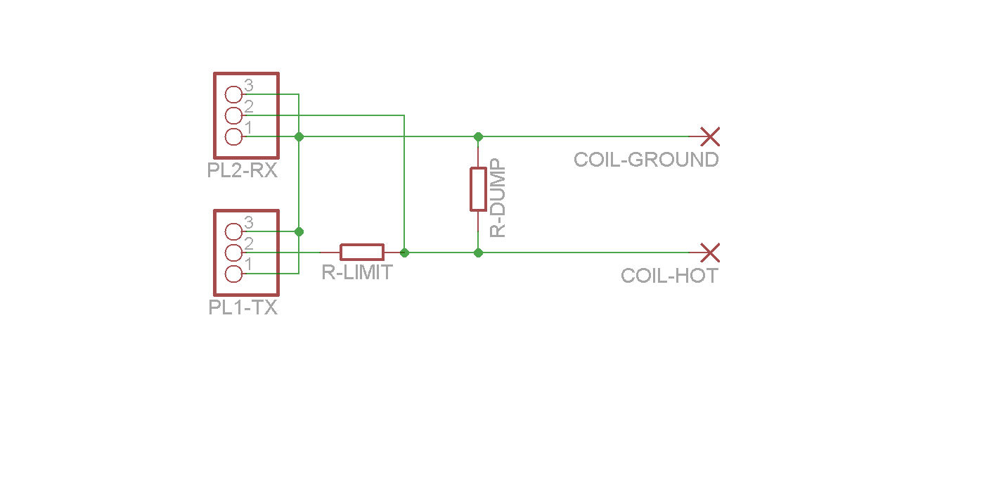

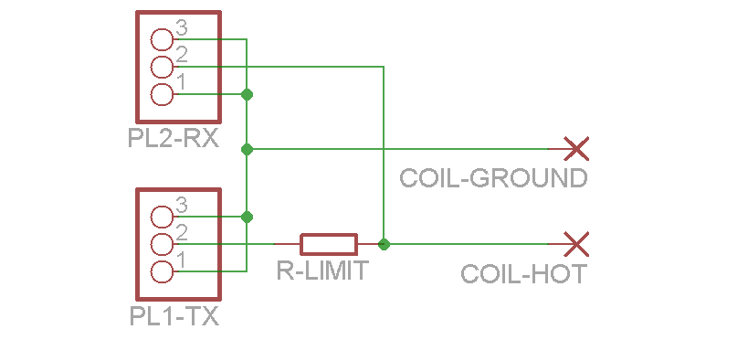

                          Hello waltr,i have the R-Limit 5 ohms in series with coil to control MOSFET not to go avalanche and that solution you gave me serves me very well!!!!I start to believe i have some problem in my board or my coil has low resistance because all others finished the MPP hadn't problem with MOSFET spikes.
Name:	R Limit.png
                          So PI fans are doomed to use non magnetic materials as chassis..Yes i plan to put the Rdamp resistor in the coil connector side.
                          Yes they are temporary bolts to hold parallel the plastic mounts until i glued the on the coil housing..
