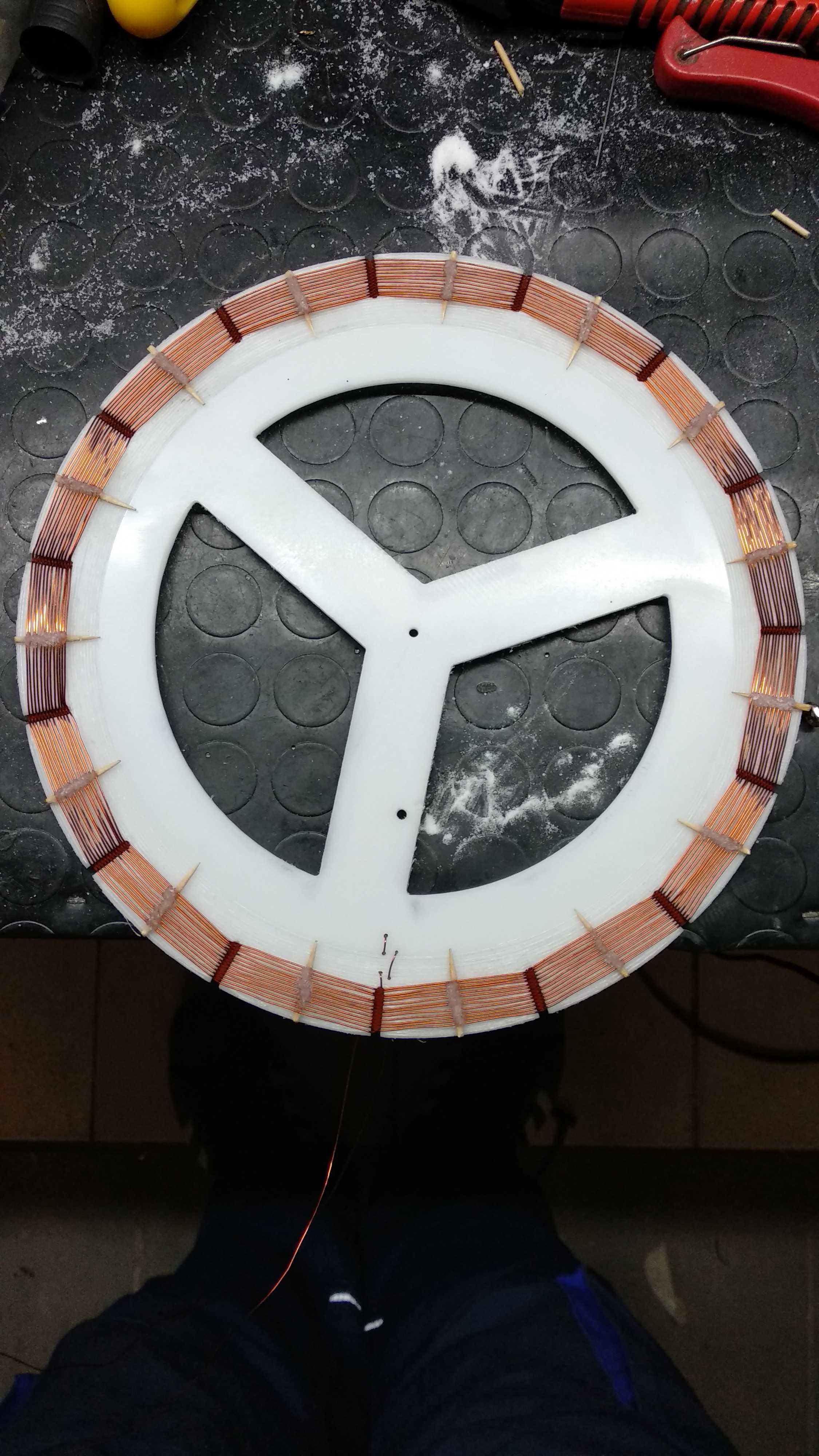

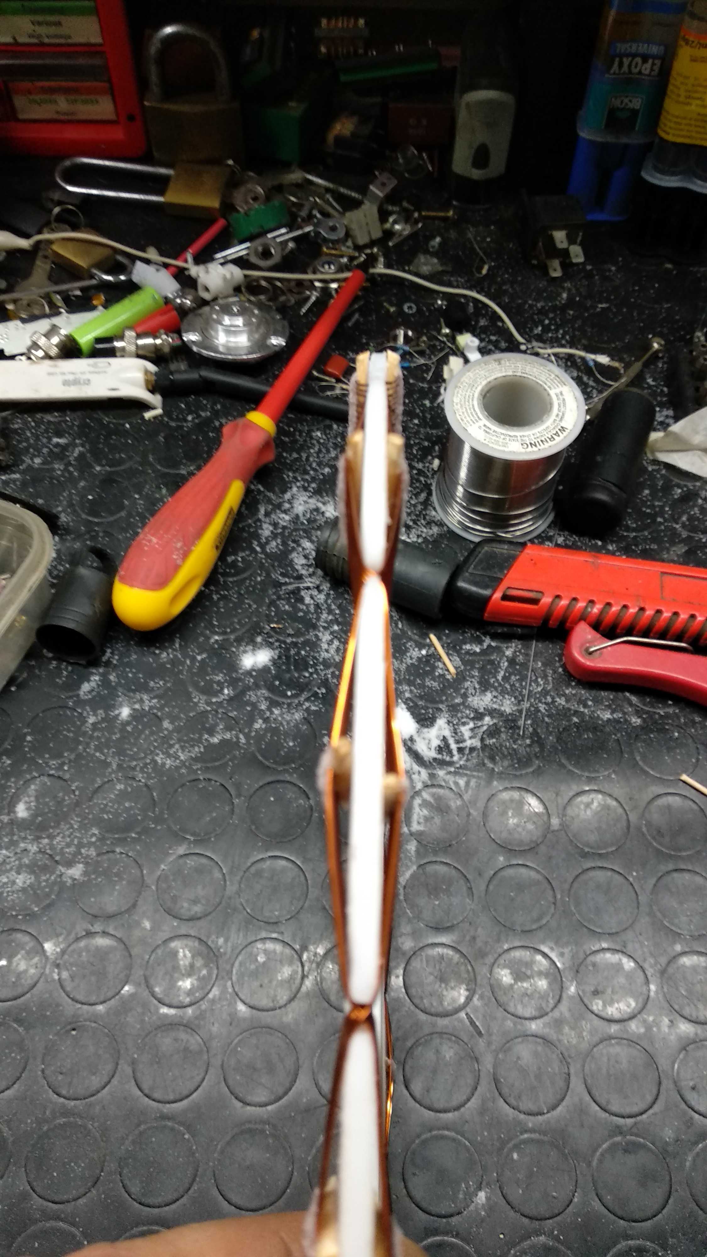

          • To excercise yesterdays lesson about coils and Rdump calculations i wrapped a new coil
Name:	Spiderweb ID22cm  OD24cm  320uH 2 Ohms.jpg
Name:	Spiderweb ID22cm  OD24cm  320uH 2 Ohms Sideview.jpg
            Measured SRF with oscope and probe loop precedure,counts 2.38MHz
            Rd=pi*L*SRF --> Rd=3.14 * 0.00032 * 2380000 --> Rd=2391.4 Ohms
            Rd*Rd= L / 4*C --> C= L / Rd*Rd*4 --> C= 0.00032 / 2391.4 * 2391.4 *4 --> C = 0.00032/5718794 --> C = 5.59 e-11 --> 55pF
            Conclusion:As SRF goes higher the Rd goes higher therefor capacitance goes higher.So we supose to lower the SRF but how???

                No, the capacitance goes lower if the SRF is higher. The equation of resonance for an LC is: fc = 1 /[2PI*SQRT(L*C)].
                So if L is constant and Fc increases then C must have decreased.
                "lead" is the wires or cable from the coil to the circuit. This 'lead' has capacitance and becomes part of the coil (RLC) when measured or installed.

                  So capacitance is 14pF...How low must it be to consider a coil "fast"
                  • Originally posted by mushaba View Post
                    I would consider that fast.
                    A coil with an SRF greater than 1MHz is fast.
                    The coils I use with my HH2 have SRF of 300-600kHz and not fast so first delay is greater than 12-15usec.

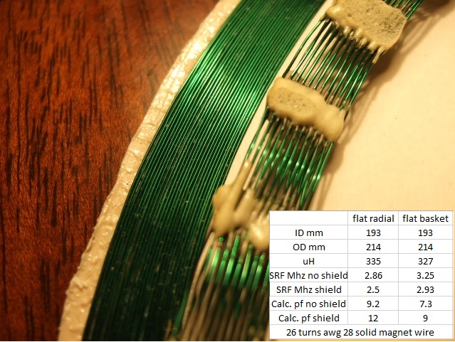

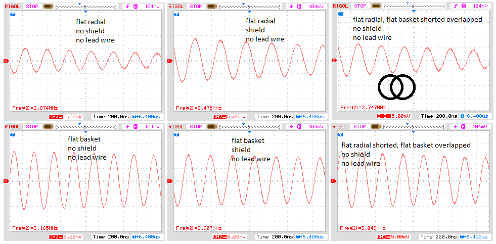

                                1. Picture of two coils I posted awhile back. SRF measured the way I suggested with scope connected to amplifier out of operating PI. Lead wires used between coil and circuit that I have measured have a capacitance of a least 1pf/inch. A 3/4m lead would have 3times the capacitance of the coil. Don't know how fast a 20cm diameter 300uH coil could be made. I think anything around 3MHz SRF without the lead is fast enough. Interested in the specs of coils others have made. Repeated the tests today using procedure reply#110 with scope lead clipped to ground lead making a pickup loop. I've been shorting the not wanted coil when measuring SRF of IB coils(separate Tx and Rx). Tried again today wit the flat radial and flat basked overlapped. Reads close to single coil reading. Maybe there is a better way?
