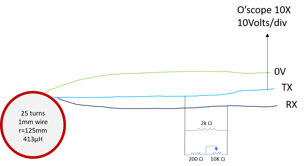

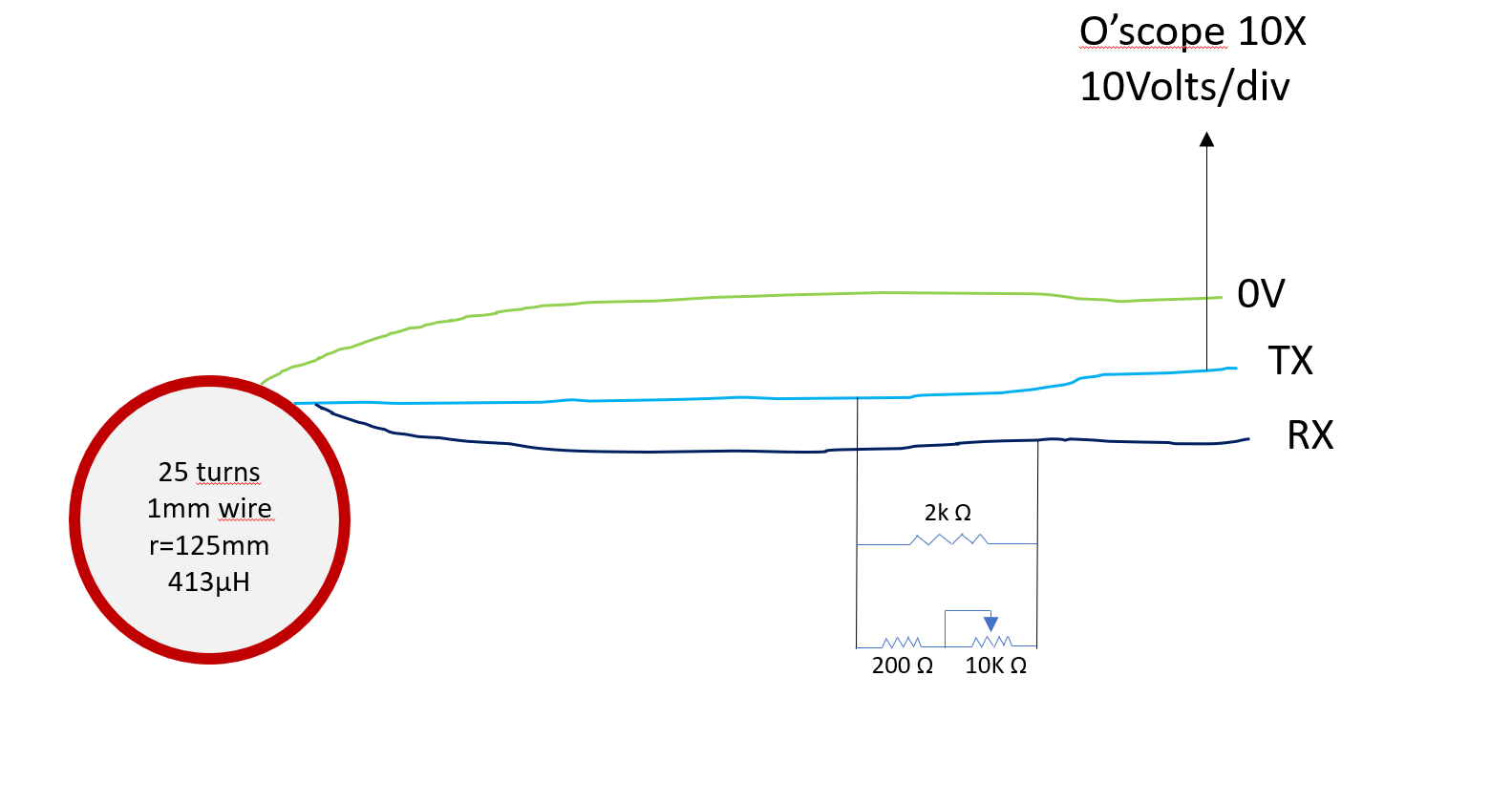

                            I need a 2w resistor for damping the high voltage it's right ?
                            Can you confirm that my montage is good for damping calculation and o'scope measurement please ?
                            Thank again for your help this forum is really helpfull !!
Name:	Damping calculation montage.png
                              [ATTACH]49762[/ATTACH]
                              Your diagram is very confusing. It looks like you've taken the two wires from the coil and shorted them together.
                              However, I think you're confused by the fact that the MPP can use either a mono coil or a two separate TX and RX coils.
                              Your coil is a mono coil, which means that the same coil is used for both transmit and receive. There is not one wire designated TX and the other RX, as shown in your diagram.
                              Forget about the electrostatic shield for the moment. Connect one wire from the coil to PL1 pin2, and the other wire to PL1 pin1 (or pin3). Then short PL1 pin2 to PL2 pin2.
                              The damping resistor goes between PL1 pin2 and PL1 pin1 (or pin3).
