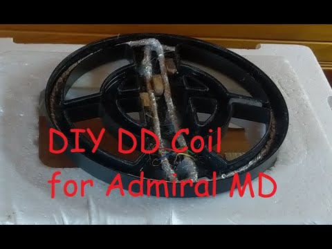

    • has anyone made a very big coil for admiral, 40-50cm ?
      • HI All
        at the beginning of last month
        I made a 45 cm header.
        real tuning and phase adjustment yet
        I didn't.
        27cm from hood
        much deeper
        I saw that.
        as soon as possible
        I will try.
        Best regards
        Gurdal
        • I made 32cm DD the depth of the coins is more or less the same but deeper for larger objects
