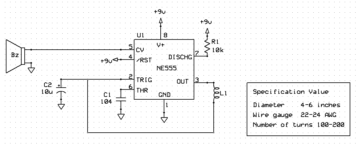

        Since I am the proposer of this idea; I will give an illustrative example.

            I appreciate your efforts,ivconic.
            I disagree with you on one thing.
            detector with the fewest elements.
            I think it doesn't matter what element is used.
            All forums are full of simple detector schemes.
            A professional detector will motivate everyone.​

              Your competition is a good idea. I agree with Profesor that the Internet is full of very simple metal detectors. So there is no real point to ask people to design more. It would be better to have more info on the specifications what the detector should have. Then people are more interested.
                A competition forum is a good idea. I agree, a "simple-fewest-parts" design isn't much fun, and Thomas Scarborough has a monopoly in that area. But other designs ─ whether complex or not, whether cutting-edge or not ─ might be interesting. Even subcircuits could be included. A competition for a tone-ID add-on for a Tesoro Bandido, or an all-analog ground tracking circuit (that would be hard).

                        Yes, you are actually right when you place remarks about "as few components as possible".
                        We already have such schematics everywhere.
                        I was just wondering how it would be possible to make a functional detector with as few components as possible... and to make sense and make a difference,
                        and if it wasn't just the usual meaningless schematic.
                        My example with the NE555 is not the best illustration of what I actually wanted.
                        The idea should be fully functional, have good GEB and DISC (in case of VLF I/B) and if PI; to have at least adjustable sample delay, if not GEB too.
                        But... let it still be an attempt with as few components as possible. A bit trivial and meaningless ... now that I read what I wrote!
                        Who adds unnecessary components anyway? (Although it's not that there aren't such cases! lol)
