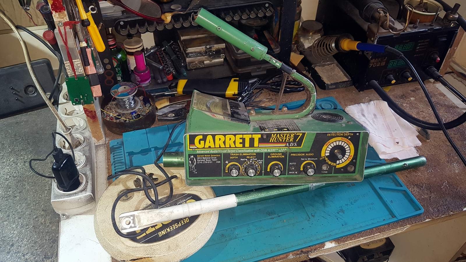

          While I was writing the last post, the postman called, bringing me a "new" toy for the long winter days.
          I talk about it all the time. It's a hobby and it's motivation. Because this machine is a mess, there will be a lot of work to fix it.
          And of course; project analysis, the way things were done there, learning from old knowledge.
          It's one thing when you just look at a schematic that someone published, it's another thing when you have a living thing in front of you.
          Many good things are "buried" in such old machines and left to be forgotten.
          We give up that treasure of knowledge too easily, we rush too quickly into "new" things that are just a pale copy of the old knowledge.
          That's why metal detectors are specific, different from other technologies, real progress can only be expressed in a few parts per thousand for a period of 30-40 years.
          Of course, taking into account only vital and useful functions, without a bunch of irrelevant "whistle and bells"...
          The opposite of, say, personal computer technology. 20 years ago I was impressed with a 150Mhz machine... today I have an 8 core processor and I'm not impressed one bit...
          Of course, this is just my opinion. It would be unnatural for everyone else to agree with it.
          ​Click image for larger version  Name:	20231202_105357.jpg Views:	0 Size:	396.1 KB ID:	417244​

                ...this is your bench after testing that for a while ...it needs 6 batts ???...
                Oh yeah, the power supply is pointless on those models.
                But I had a model "5" some time ago and I found a good solution by experimenting.
                A stepup converter that increases the voltage from one battery to (minimum) 32V, then an additional voltage regulator to 9v and it all works perfectly correctly.
                I've already tried that, so I'll do the same on this model.
                Otherwise, it is really impractical to put so many batteries in the detector. But that is from a time when there was clearly no saving.
                And IMHO, there is a much more important reason for that; S/N ratio. Various voltage regulators are known to be a significant source of noise.
                The ideal power supply is directly from batteries without regulation. But the downside is the voltage drop on such a battery...
                In any case, the remark is valid.
                A step-up "by definition" can be a source of noise.
                But if the conversion works at a high frequency, there is less chance that it will significantly interfere with the operation of the detector.
                I didn't notice any deterioration on the "5" model. We'll see what happens with this one.
