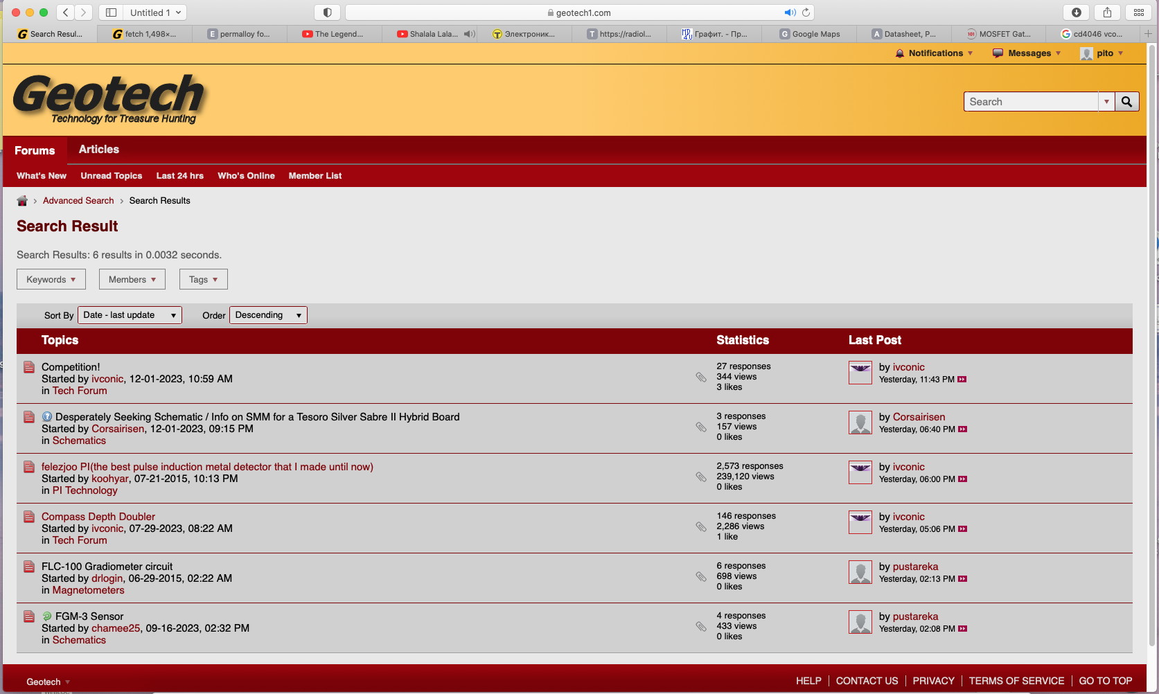

                      Where is the button - start new topic ?

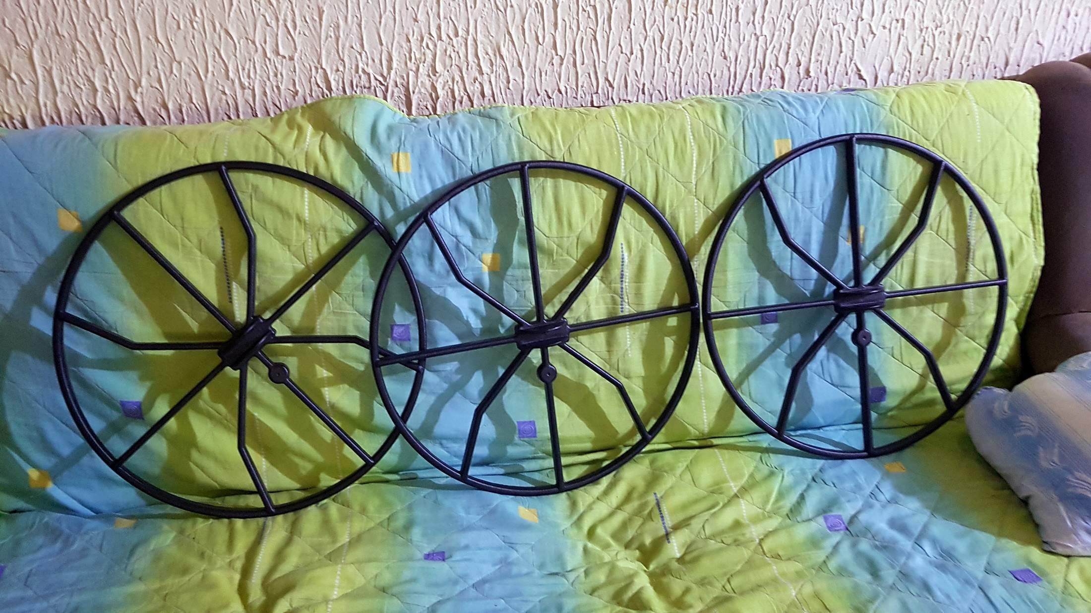

                          Some time ago I acquired (from a friend from another country) 3 coil enclosures with 56cm diameter.
                          And since then I've been trying to make a good coil for those cases/enclosures. Alas... I fail. I tried with wires 1mm, 0.8mm, 0.5mm and now almost with 0.55mm.
                          I use regular Cu wire. No litz, because I can't find it.

                              My English vocabulary is poor, I always forget the right term, when I often mentioned "PVC litz" - I actually meant "stranded" wire.
                              But I have to find a thinner "bundle" because the "channel" in the plastic case is the limiting factor, there is not enough space for thicker bundles.
                              We'll see, I have 3 enclosures. It would be nice to make 3 good coils.
                              Click image for larger version  Name:	20231028_203751.jpg Views:	0 Size:	540.4 KB ID:	417377​​

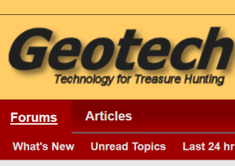

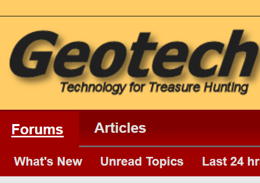

                                Not available from a search result. You need to go to the "Forums" view by clicking "Forums":
