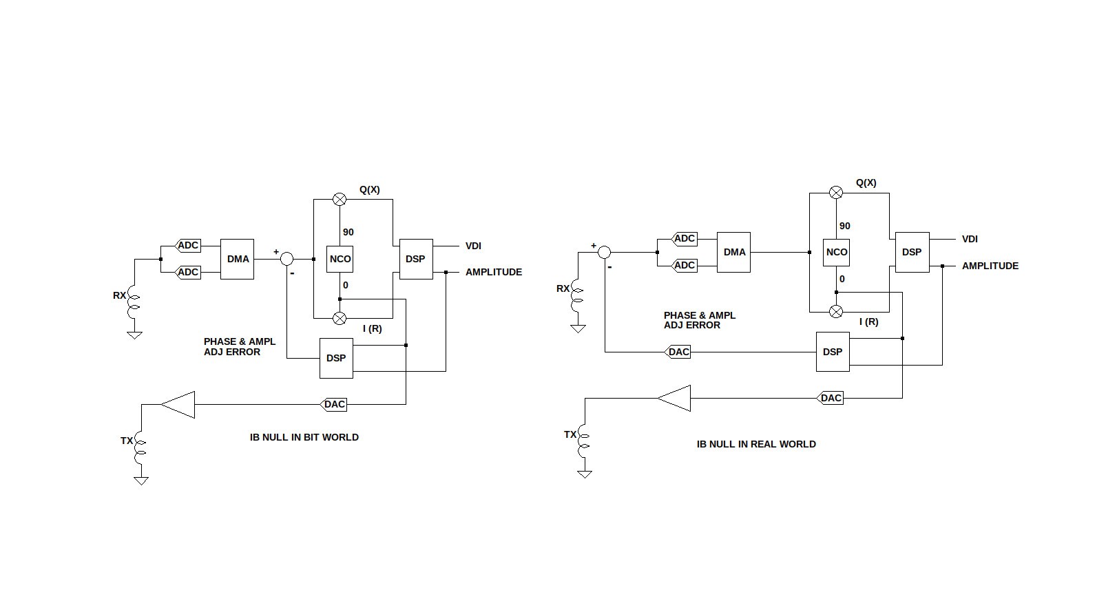

    Here is my entry for the nulled loops competition. It uses the ARMD project core and balances the loop via two possible methods. ( internal to the DSP ) or external.
    Note in external mode the RX coil "sees" the correction signal !!
    The balancing is very simple in reality. We already calculate the signal magnitude and we know the NCO phase and amplitude so its a matter of a null feedback loop.
