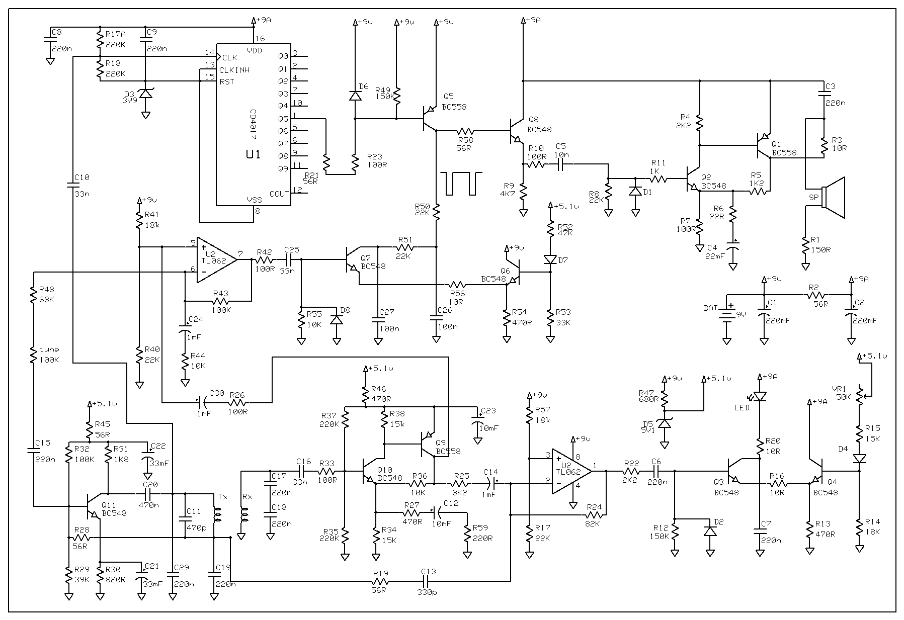

    So the challenge here is this: think of ways to implement e-nulling. Remember that you want a good null before the signal even enters the RX preamp so you can get a decent first stage gain without risk of overload. Also think about how a multifrequency coil might be e-nulled.

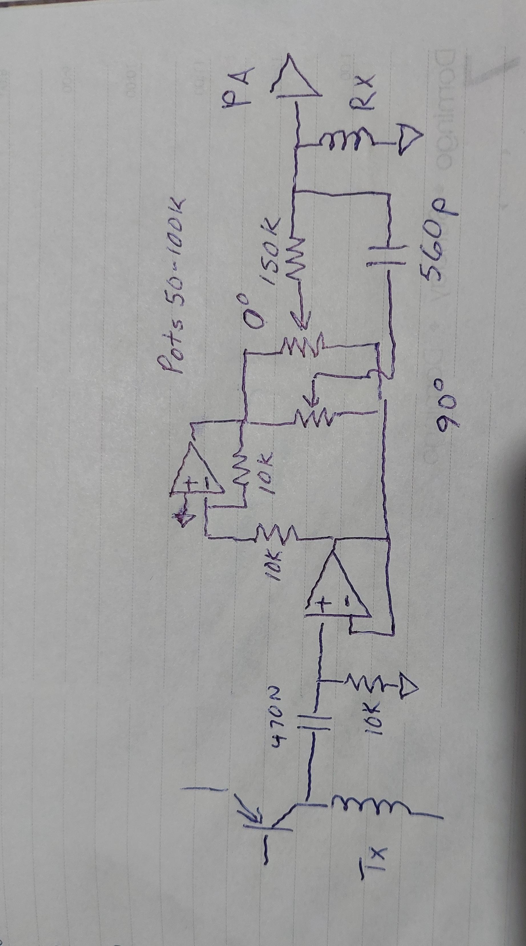

    This circuit is manually adjusted, but the goal is to replace the pots with digipots. The most common digipots are 3-5v which limit the signal that can be processed. There are hv pots which can probably overcome any problems.
    The tx signal is fed into a voltage follower and an inverting amp. The pots are attached to the outputs. One pot controls the in phase through a resistor. The second pot controls the quadrature phase through a capacitor. I have a working test circuit, but I am away until the end January and can provide more detail now.
      Click image for larger version  Name:	phase10.gif Views:	0 Size:	1.9 KB ID:	417977​
      This one is working very good, pot = 100k, R= 10k, C = 1nF for 8kHz, on the front I added a potentiometer for amplitude regulation.

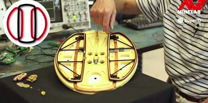

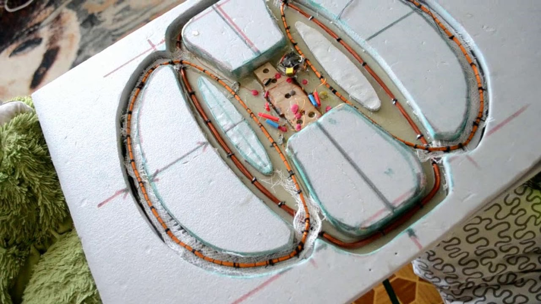

              What I posted can be automated. The Nautilus 2b, Tyndall Electronics used two digipots to null the coil. No micro was involved. It used cmos up/down counters and a halfwave rectifier to sense the rx voltage. I had a 2b and started reversing the nulling pcb, it was a rats nest. I ended up selling the unit before making a schematic. The Nautilus did not use a opamp inverter. The tx oscillator was configured as a Hartley using a center tapped coil. The nulling pots were placed across the tx leads giving 180 degrees of adjustment Most of the posted schematics are incorrect in this section.

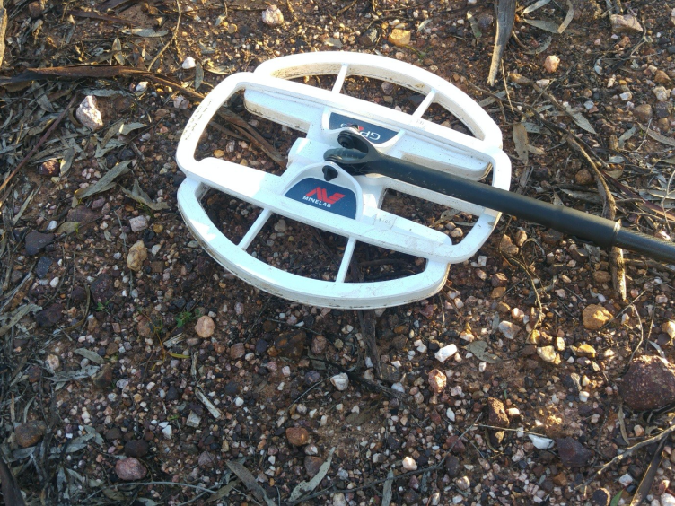

              Another interesting coil setup is the Minelab Gofind.
                Pity you didn't trace it out!

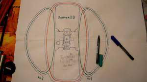

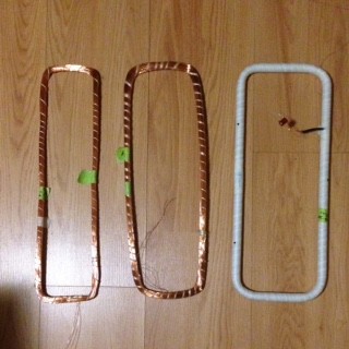

                  Patent #1 = Supper D
                  Click image for larger version  Name:	image.png Views:	0 Size:	1,013.7 KB ID:	418004​ Click image for larger version  Name:	image.png Views:	0 Size:	62.4 KB ID:	418001 ​Click image for larger version  Name:	image.png Views:	0 Size:	1.04 MB ID:	418002​Click image for larger version  Name:	tx4b.jpg Views:	0 Size:	28.3 KB ID:	418003​Click image for larger version  Name:	image.png Views:	0 Size:	1.04 MB ID:	418005Click image for larger version
                  In my case ground cancelation 90%
                    Patent #2 = Needs program modification

                              I think I might be able to draw a layout of the auto null board based on the photos.
                              A schematic can then be drawn. It should be easy to discern what chips were used.
                              The component values aren't important. Just to grasp how the circuit is doing it's job.
