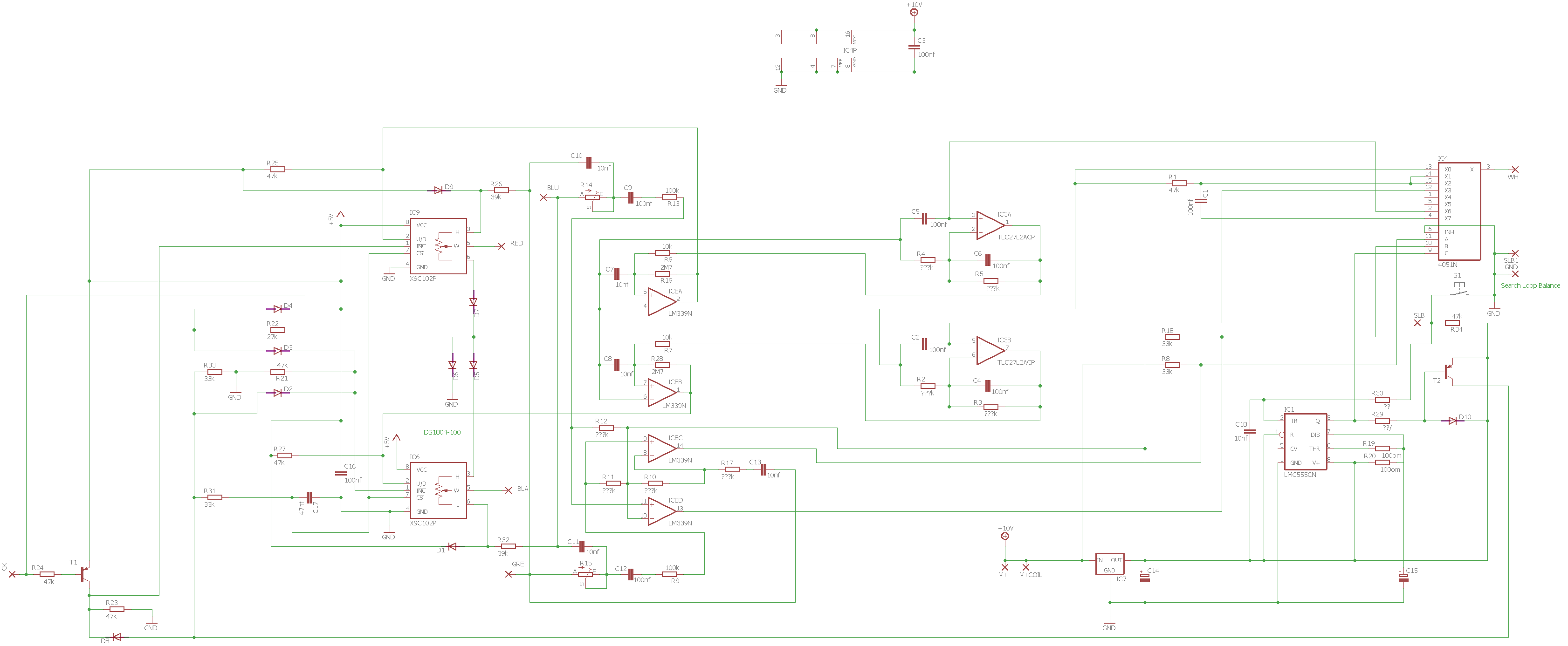

    ​ I've already done it, but I didn't recognize all the elements :-)​ Click image for larger version

      Thanks for posting Mario! It will make a good study.
      The digipot center taps labeled red and bla go to the preamp pcb in the coil. Where one goes to a series cap and the other to a series resistor. These are both connected to the rx coil entering the preamp. A small micro controller could probably replace most of the comparators and op amps.
        Thanks for sharing your excellent work!

          There is no +5v path to CD 4051 in the top Autotune diagram! hidden​ under the layout and I couldn't track it.

          This is how I made a DMC clone. The detector "detects metal", unfortunately I cannot cope with BG, it does not remove ferrite and DISC does not work well.​
          I don't know what frequency the receiving coil should be tuned to because it probably causes incorrect operation of the BG/DISC​

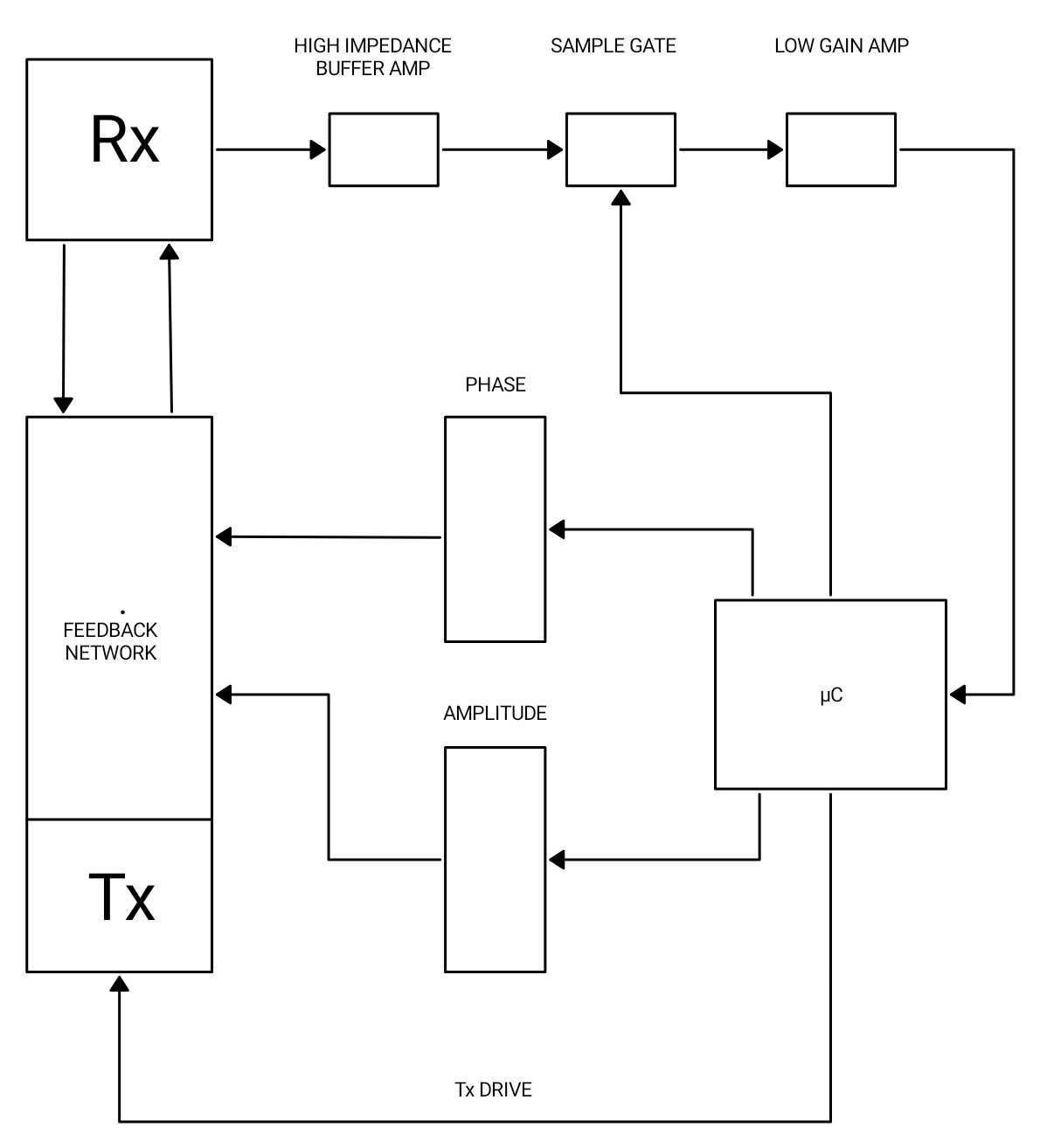

                            the Rx signal is fed through a synchronous sampling gate and digitized. The software controls the sampling duty cycle.
                            The μC determines the zero crossing point of the sampled waveform's trailing gain section and phase compares this to the reference signal (Tx) zero crossing point.
                            Any phase shift beyond a prescribed angle will trigger a hold and inhibit for AIB in the software until the phase angle drops below the prescribed amount. Then AIB resumes.
                              Block
                                Mario-j23, pin 6 and 2 of 555 IC should be connected.(Not visible on photos as it is connected beneath the chip). Configured as astable. This drives the INC pin 1 on the X9Cxxx
                                Now I think the auto-SLB push button is a normally closed type.
