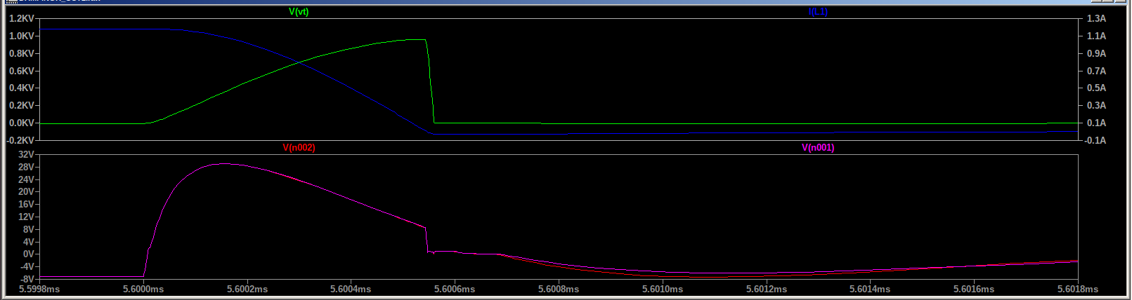

    Playing around with a "practical circuit" but now with "real component models" meaning that the circuit is actually buildable ( and thats the next step ). We see some interesting artifacts that will be used to make it work.
    As Carl mentioned the coil is going to change inductance with ground / hotrocks / targets so the plot below is a coil stepping in 30 microhenry steps so we can see the result ( in real world I only see the coil change 2 - 3 microhenries over ground unless you put the coil on a sheet of steel etc.).
    What is interesting is that we get a "pivot" point for the coil current and an "error bump" voltage when the coil is not at zero current. The error voltage is proportional to how far the coil is from damped. This is an immediate opportunity to sample the error voltage at the pivot point time and the feed back loop will be a Voltage to PulseTime conversion ( voltage to freq perhaps ?? ) to normalise the damping point when coil inductance changes.
    As you can see the error voltages are big enough ( more than 1 volt per microhenry ) for an error control loop to work off.

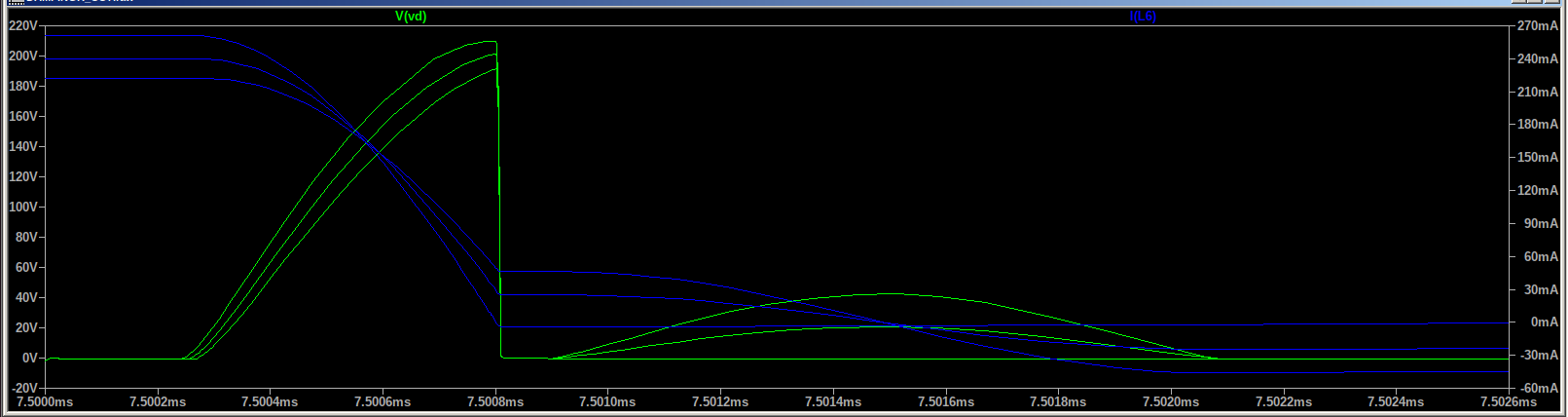

    • #47
      Added the RX front end for feeding into the first amp ... the pic below shows the current being damped from 1 amp in around 600 nanoseconds and we have a target response starting at 680 nanoseconds. ( rather a large target coupled in at 10% so we can see it note ... this would be the input to the first amplifier )
      I am a bit surprised but this is actually looking good so far ( remember we are on simulation here ... pudding tastes best on eating not on reading the recipe ).

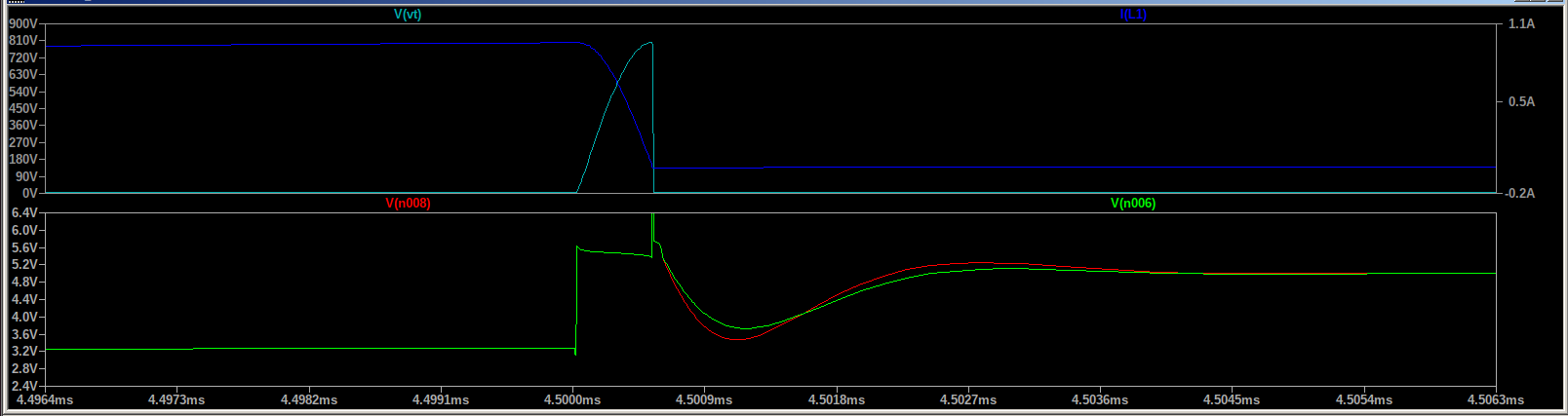

      • #48
        ...added a separate analogue ground and now getting some really nice target responses. Target coupling is 5%. Damping in 618 nanoseconds @1 AMP peak 800 volts. No amplification.
        Click image for larger version  Name:	image.png Views:	0 Size:	35.3 KB ID:	419300​

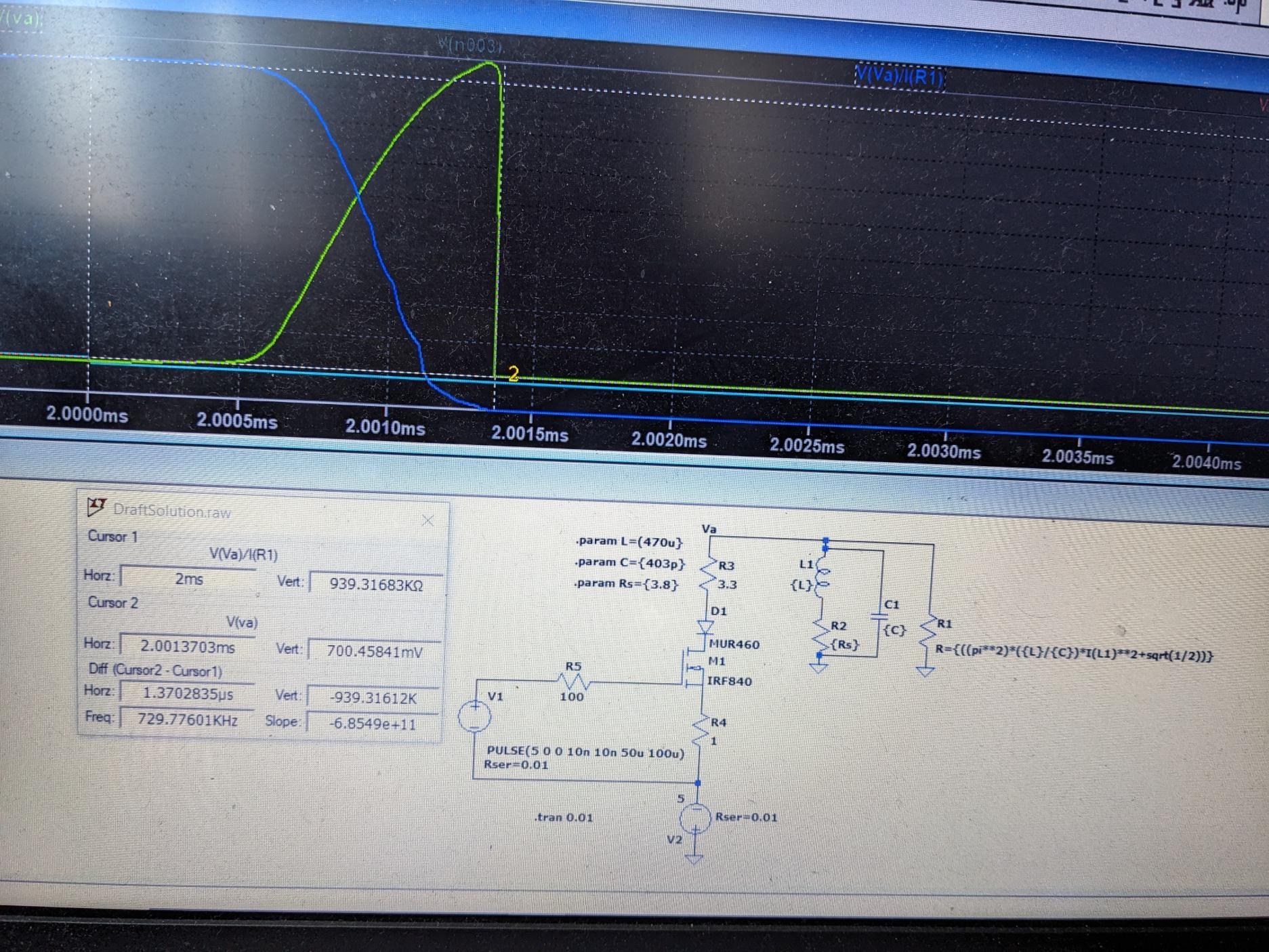

          • #50
            This formula does not work if you change the coil or pulse repetition rate so it works only for this set of operating parameters and is not a universal solution as the current changes with these two variables.
            • #51
              Changing the coil parameters for my crappy 25 way screened cable concoction meant decreasing the repetition rate from 10kHz to 1.6kHz.
              Rs=3.8
              L=470u
              C=403p (calculated)
              Pulse period=625uS

                • #53
                  Ok I can it get to work at different rep rates but only with 1.37uS damping time with these mods (harder driven Voodoo TX cct)

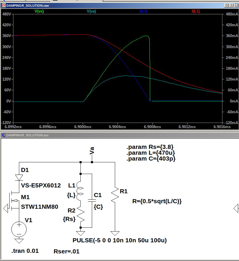

                    • #55
                      Rs=3.8
                      L=470u
                      C=403p (calculated)
                      Pulse period=625uS
                      Your coil works perfectly with the formula .... There is no time term in the equation so repetition rate has nothing to do with it and is theoretically being damped in 750 nanoseconds.
