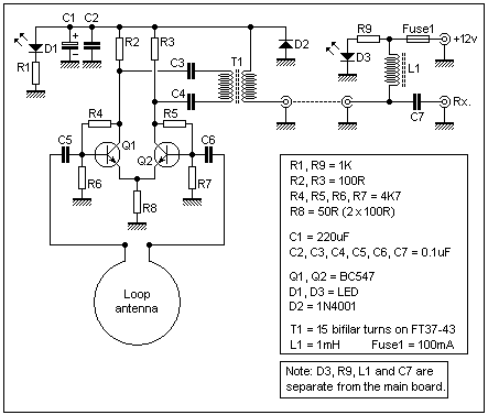

                          Instead, AD797 consider an active antenna design​/Discrete components
                          Click image for larger version  Name:	image.png Views:	0 Size:	7.7 KB ID:	421683​ Click image for larger version  Name:	image.png Views:	0 Size:	33.1 KB ID:	421684​
