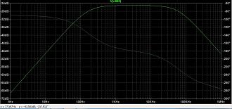

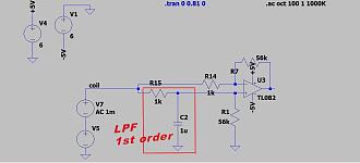

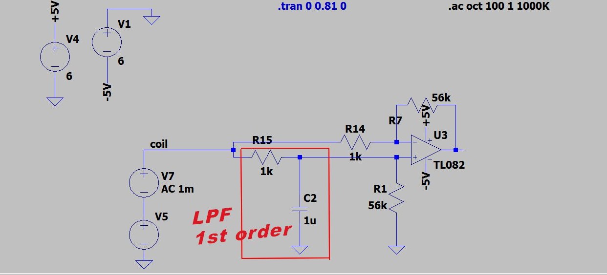

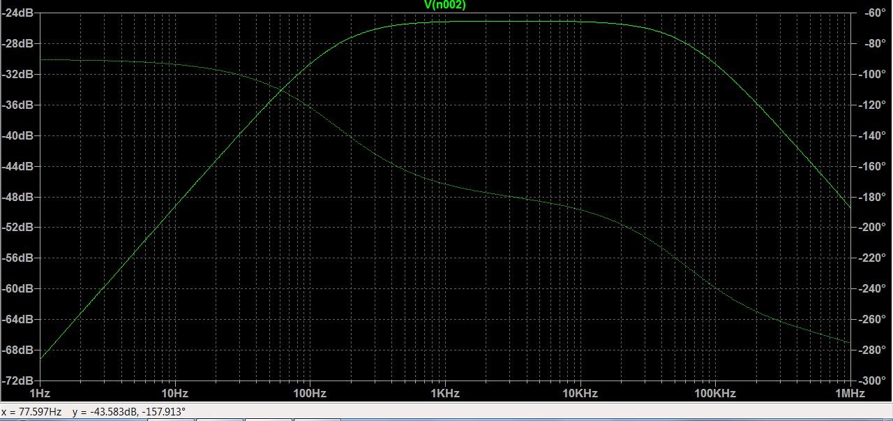

                  1.When designing a band-pass filter before demodulation, you need to find out what Spectrum the target signal has. When I mentioned the bandwidth, I meant the Spectrum of the target signal. If the target's constant time is 1u, then its Spectrum starts from 1 MHz and above.
                  Harmonics of the pump signal are the spectrum of the pump signal but not the target signal.
                  2.The filter you mentioned above as a band-pass filter BEFORE demodulation is definitely a high pass filter.
                  My problem is that after this filter, a clamping circuit to some level (for example, ground level) is needed.
                  Another problem is frequency-dependent phase shift in the filter.
                  And yes, the filters we are discussing here are frequency domain filters, but oddly enough, the way we process signals is time domain, we use integrators which are time domain tools.
                  3.Regarding the schematics you provided: this is my version. I think it’s less complicated, although with the same phase shift drawbacks

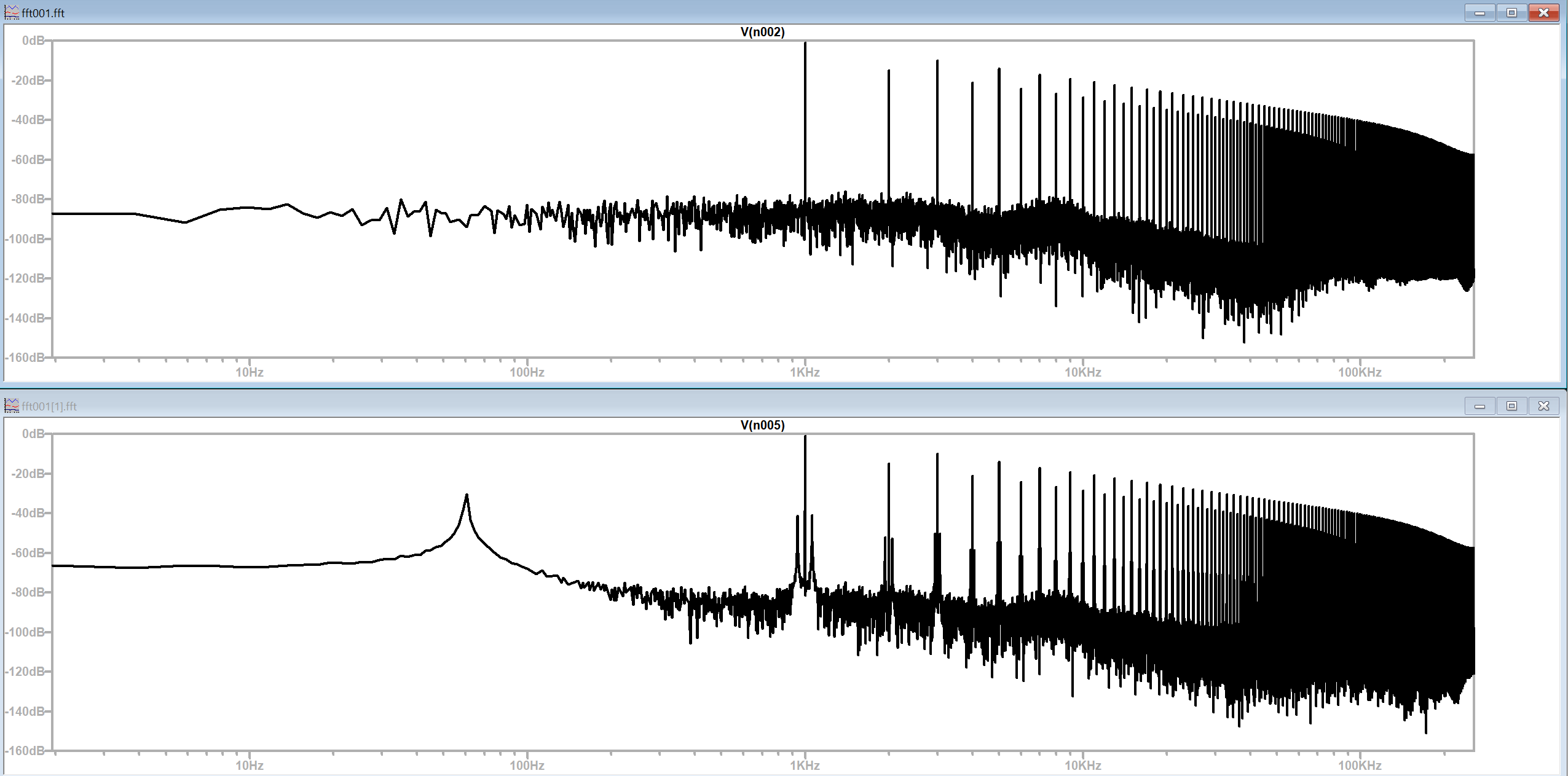

                    I dont think you understand what the problem we are solving is .... The target spectrum can only be in response to the TX signal .... A simple bandpass filter you propose can remove low frequency components but it cannot remove modulation components due to noise / earth field etc.
                    Below are two spectrums from a simple PI operating at 1 khz. One of the circuits is exposed to 60 Hertz mains hum .... you can see it in the primary spectrum spike at 60 Hertz but you can also see modulation sidebands on the components of the RX signal. The filter you propose will never remove the sideband modulation from the RX signal components.
                    The demodulating bandpass filter I use does solve this problem.
