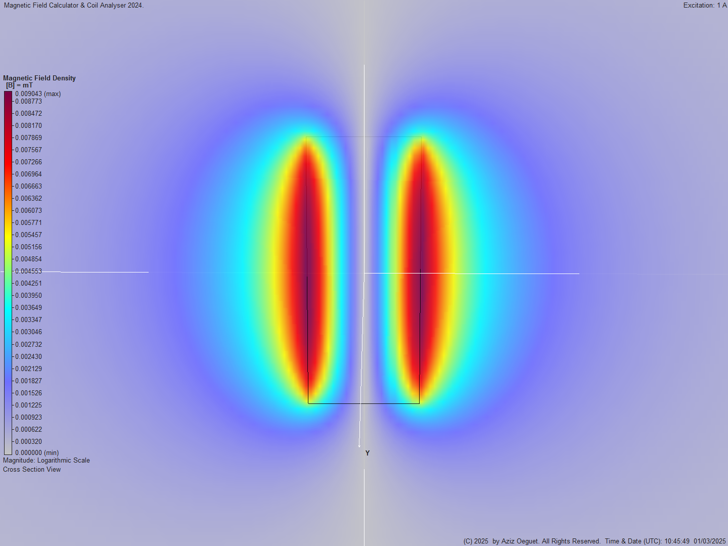

      finally, I see what is really happening to the "edge effect". Did you know, that surface currents through a finite length straight wire produces a zero B-Field inside the entire conductor (all current is flowing at the surface of the current). This is the reason, why the internal inductance gets 0. You probably never seen such accurate and good visualisations of the effects. I have to implement a lot of code yet.
      Wire: 10 cm length, 40 mm thicknes, 1 A current
      Surface current model. All current is flowing at the surface of the conductor.
      Click image for larger version  Name:	SurfaceCurrentStraightWire.png Views:	0 Size:	501.3 KB ID:	431735 You see no significant B-Field inside the conductor cross section. See at the edge effect and the continuity of the B-Field density.
      For this simulation, I had to break the wire into many thousands of filaments.
      Test passed! (Physics works )
      Stay tuned... more to come later

      • #48
        This is only true for a perfect conductor (σ = ∞) or when f = ∞.
        • #49
          It's called the Meissner Effect.
          • #50
            So if we immerse the coil in liquid nitrogen ...
            • #51

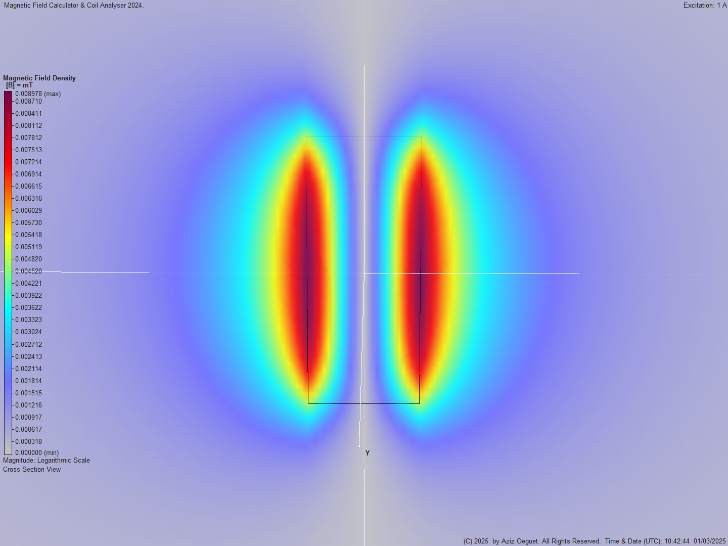

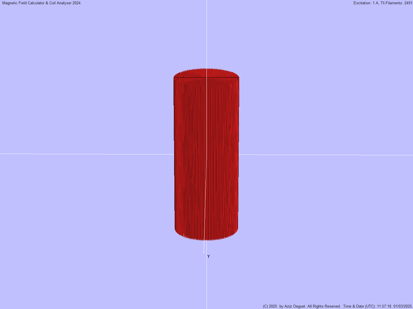

              Hi all,
              now let's look at the uniform current density for the same straight thick wire. The simple and fast algorithym produces discontinuities in the magnetic field at the endings and beyound that. This is owed to the fact that the amperes law isn't defined outside of the straight wire. Particularly beyond the endings. If I break down the piece of straight wire into many many wire filaments (2491 in the follwing example), I get finally the correct magnetic field everywhere. The discontinuity disappears.
              Wire model consists of many many wire filaments:
              Simple and fast wire model (only 1 wire filament):
              Now the wire model with many many wire filaments:
              Look at the above picture: There are minor differences.
              It seems, that the amperes law is only valid for long wires (length much greater than the thickness of the wire). It lacks at the endings of the wire and beyond that (not defined).
              The "edge effect" has not been investigated till now. Let's wait 10 - 20 years until someone publishes a paper. And a good formula for more accuracy.
