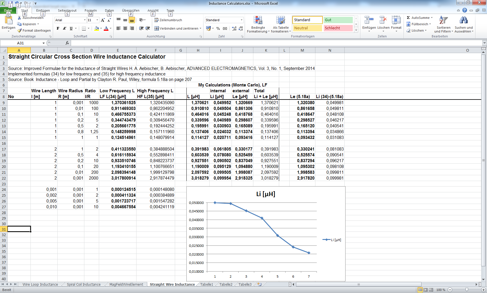

        Hi all,
        where is the wall for my head again? One more Give me more!
        I can not extract a good formula for the partial internal inductance Li for a straight wire, if one of the formula is obviously flawed (Lt not exact).
        But the partial external inductance Le for a straight wire in the formula 5.18a/5.18b is really exact! All my EMF simulations convergate very well to the formula result.
        Li = Lt - Le still delivers inaccurate results. So it doesn't make to find a fancy formula for it.
        The fkn exact Li formula is a function of wire length and wire radius. Only two parameters.
        I show you my results (see attachment). My calculated values are only 4 digits accurate.
        I probably have a bug in my software. I'll have to check it again.
        Cheers,
        Aziz

                Hi all,
                I have been thinking about the mysterious results. I have still no idea or know the reason for. But let's look at the external inductance (Le) formulas for a straight wire of lenght l and circular cross section of radius r.
                The book ("Inductance - Loop and Partial", Clayton, formula (5.18a) on page 207) for the external inductance (Le) states:
                Le = (µ0/2pi) * l * ( ln( l/r + sqrt( (l/r)² + 1 ) ) - sqrt( (r/l)² + 1) + r/l )​
                or
                Le = 4pi*10-7/2pi * ..(rest of the formula)
                Le = 2e-7 * l * ( ln( l/r + sqrt( (l/r)² + 1 ) ) - sqrt( (r/l)² + 1) + r/l )​
                Rosa ("The self and mutual inductances of linear conductors", publication year 1908 states in formula (9) for the total inductance (L):
                L = 2 * ( l * ln( (l + sqrt(l² + r²)) / r) - sqrt(l² + r²) + l/4 + r)
                Lets form Rosas formula a bit and subtract the internal inductance part of the formula to get the external inductance Le. The internal inductance ist the summand l/4 in the brackets. We leave it. And we take the 10-7 from µ0 into account.
                Rosa Le = 2e-7 * ( l * ln( (l + sqrt(l² + r²) ) / r) - sqrt(l² + r²) + r)
                Book: Le = 2e-7 * l * ( ln( l/r + sqrt( (l/r)² + 1 ) ) - sqrt( (r/l)² + 1) + r/l )​
                They look quite different but they shoud be the same by forming it. Lets form the books formula:
                Le = 2e-7 * ( l * ln( l/r + sqrt( (l/r)² + 1 ) ) - l * sqrt( (r/l)² + 1) + (l*r)/l )​
                Le = 2e-7 * ( l * ln( l/r + sqrt( (l/r)² + 1 ) ) - l * sqrt( (r/l)² + 1) + r )​
                Le = 2e-7 * ( a - b + r )​
                a = l * ln( c )
                b = l * sqrt( (r/l)² + 1)
                c = l/r + sqrt( (l/r)² + 1 )
                I have taken out the summands and replaced them by a, b and c for simplicity. Let's form them individually.
                c = l/r + sqrt( (l/r)² + 1 ) = l/r + r*sqrt( (l/r)² + 1 )/r = (l + d ) / r, where d = r* sqrt( (l/r)² + 1 )
                lets form d further
                ​d = r* sqrt( (l/r)² + 1 ) = sqrt( r² * ( (l/r)² + 1 ) ) = sqrt (e), where e= r² * ( (l/r)² + 1 )
                e = r² * ( l²/r² + 1 ) = l² + r²
                put back e and d to get the c again:
                c = (l+d) / r = (l + sqrt(e) ) / r = (l + sqrt( l² + r² ) ) / r
                c = (l + sqrt( l² + r² ) ) / r
                Let's form b now:
                b = l * sqrt( (r/l)² + 1) = sqrt( l² * (r²/l² + 1 ) )
                b = sqrt ( r² + l²)
                Let's put b and c back into the formula above:
                Le = 2e-7 * ( l * ln( (l + sqrt( l² + r² ) ) / r) - sqrt ( r² + l² ) + r )
                Lets look at Rosa's formula:
                Le = 2e-7 * ( l * ln( (l + sqrt( l² + r² ) ) / r) - sqrt ( l² + r² ) + r )
                Q.E.D. Ok, both formula are the same.
                Rosa's internal inductance formula Li is (remember, we have left the (l/4) summand for the external inductance calculation):
                Li = 2e-7*(l / 4) = 1e-7 * l / 2, for l=1 m for the unity wire length:
                Li = 1e-7/2 = 0,050 µH or
                Li = 50 nH
                There we have it. My personal headache.
                My own calculations approximate very well to the external inductance Le so it must be correct. Lets assume, I'm calculating the internal inductace Li totally wrong.
                But if I take a look into the publication ("Improved Formulae for the Inductance of Straight Wires") and implement even the correction with Taylor Series method (formulas 49, 50, 51, and 52) to get a better inductance calculation, and subtract the calculated external inductance Le from it (formula above), I get nearly the same shape of the behaviour.
                Click image for larger version  Name:	Headache1.png Views:	0 Size:	216.2 KB ID:	430552
                WTF? Let's assume, they calculate it right. But I get the same shape with a scaling factor to my calculations (see attachment on the graph above on the bottom left side).
                Let's assume, there reference for the error calculation is not correct and they calculate the wrong way. But I get nearly same results behaviour.
                Let's assume, there reference is wrong, they and myself are doing it wrong way. -> Rosa's internal inductance Li must be right.
                So who is correct? I have headache.
