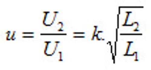

      Above is the formula for calculating the coil coupling coefficient k between two coils. L1, L2 is the inductance of the coils, U1 is the self induction voltage of L1, U2 is the induced voltage in L2 due to current flowing thru the coil L1. I can calculate L1, L2, U1 and U2. K is then trivial.
      k = U2 / (U1*sqrt(L2/L1))
      This way I get more accurate results with no bug happening.

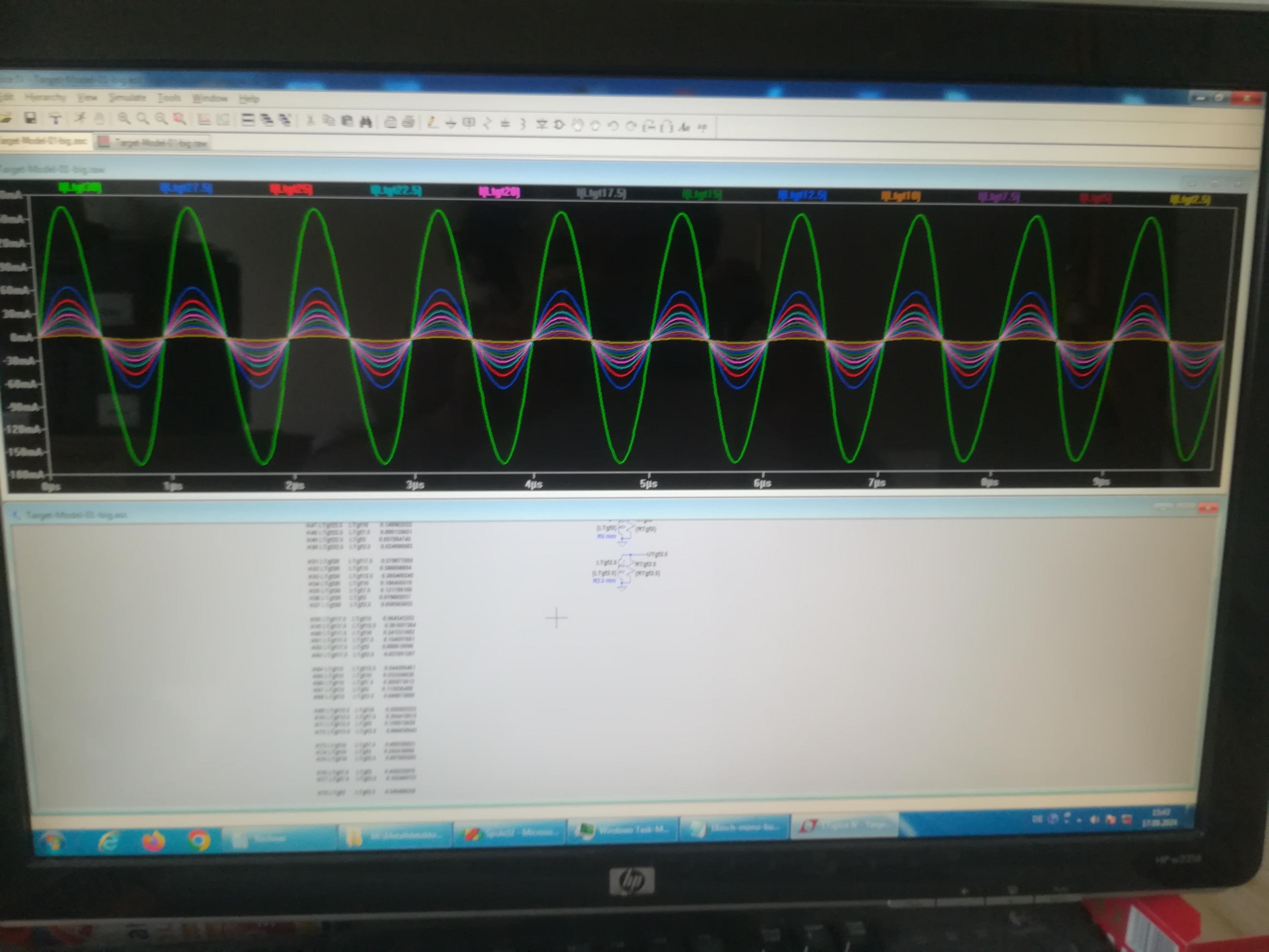

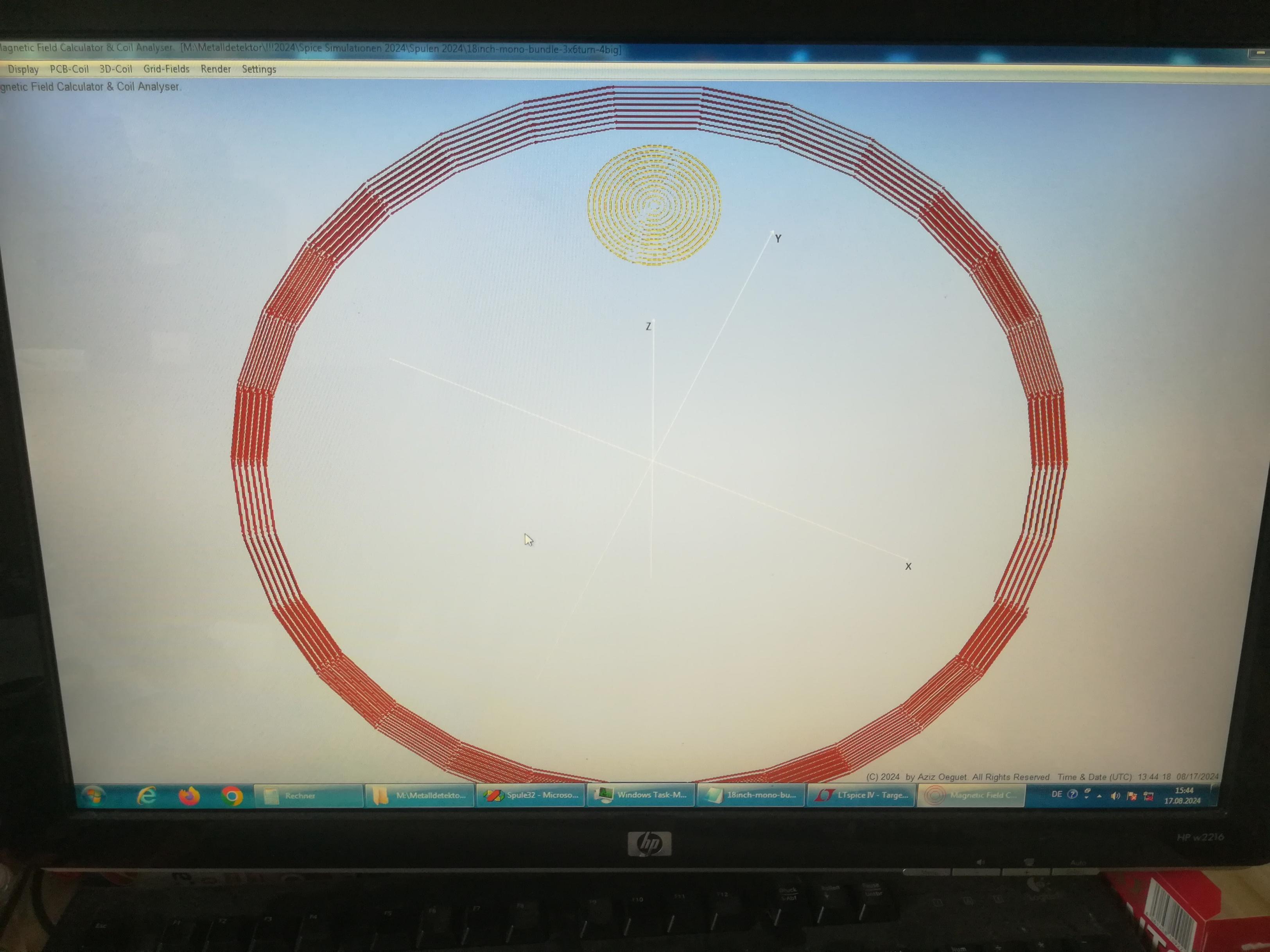

                Some pre work ..
                  Oh man!,
                  the quality of the pictures are really bad. They have been made via smart phone camera. So excuse me for not having made the simple screen shots. I have moved my development platform from a two core Windows XP to a fast four core 64-bit Windows 7 PC. My old favorite Photoshop LE 5.0 software doesn't run on the newer PC and I have to look for an alternate image editing software. Unfortunately, I'm getting old as my equipment gets old too and I face problems with software requiring new operating system, new PC hardware, new software etc.
                  But I like to use old systems. I'm still using the Microsoft Visual C++ 6.0 from year 1998 for my coil software developments. All the new compilers require Windows 10 or 11.
                  Next time, I will deliver you better screen shots.
