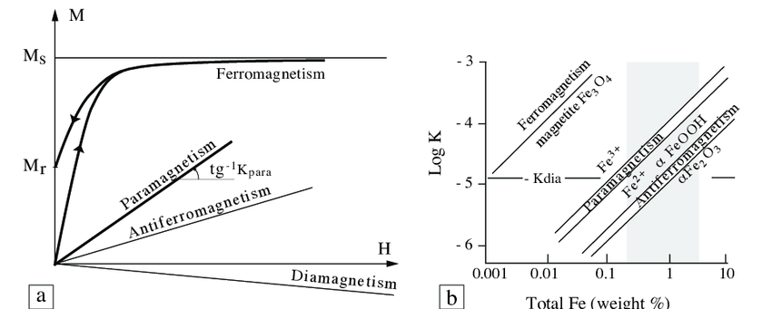

                • #98
                  ... just to save you some time .. here is the graph.
                  There are 2 zeros ( one on the X axis and one on the Y axis ) ... and they are both at the same point which gives a beautiful symmetry if you know how to use it.
                  lets compare how various materials respond to magnetic fields ...
                  They all have symmetrical curves as per the first figure and theres a linear response in the Log Linear percentage ... so a GB point can be calculated on these factors. This is just maths ... "the method" is what is patented as you cant patent the maths.
                  The use of a "symmetrical" TX waveform ( sin square triangle .. whatever ) greatly simplifies the task. Makes you realise that mono pulse PI detectors have their work cut out to achieve a GB.
                  Some may now have tweaked that this is a magnetic permeability question. Since the u (mag perm ) can be determined without regard to conductivity​ ...the conductivity part ( target detection ) is not affected by the GB part .... the target loss in the GB condition is due to the loss of GB signal which you dont want ... not target signal.

                      • This might be more illustrative ....
                        1 . The detector needs to solve GB so that the magnetic permeability of ground produces no target signal.
                        2. The detector needs to detect targets by their conductivity AND / OR permeability as long as the permeability of the target is not the same as the ground which is Gbed out.
                        Everything has a permeability ... ground / metals / air / water etc etc BUT they are all symmetric to the origin on the graph and that is the key to the patent.
