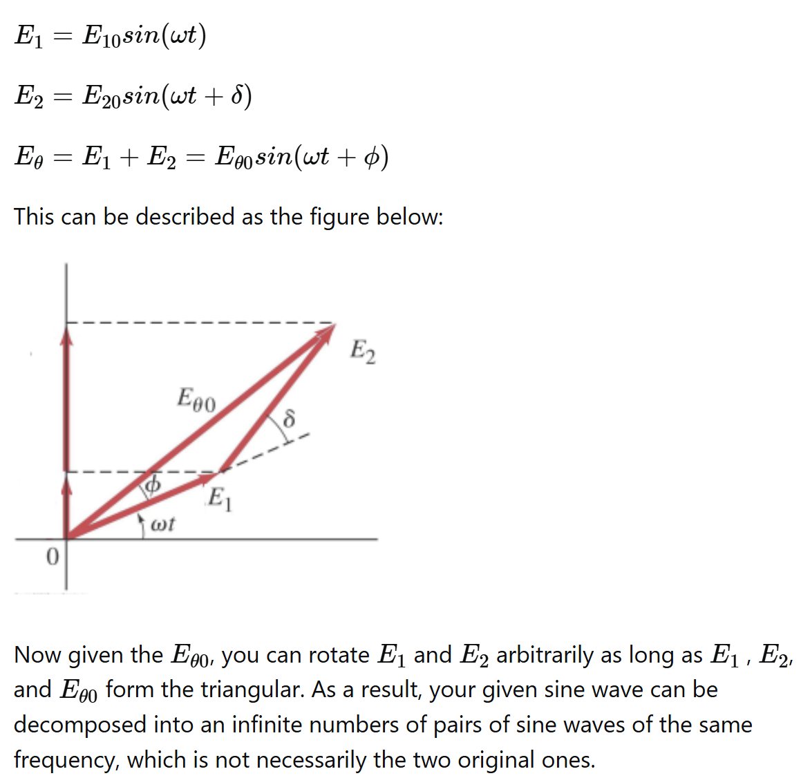

          Even though you see diagrams for discriminating metal detectors as a polar phase diagram with a single vector drawn on it the signal from the RX coil is actually a composite vector made up of multiple sinewaves with the same frequency but different amplitudes and phases.
          For example a simple one for an RX coil on an IB .... with two phases that we might call IB ( tx imbalance ) and GR which is a ground response vector.
          E1 might correspond to the GR and E2 to the IB vector.
          The result is E0 the resultant vector.
          So my solution rearranges ( using hardware) the below diagram to do the following things ..
          1. Solve E1 and E2 phase and amplitude using only E0 and knowing how a ground signal will affect the result.
          2. Use a method to solve for E2 such that any changes in E1 will have no impact on E2.
          All the designs I see in VLF for instance aim to solve for E0 and calculate a VDI which is resultant of superimpose vectors E1,E2 .... En in a real system
          The solution is to NOT use an FFT / Goetzel etc ... hint hint.
          Below is just a general representation of the problem ....

            Ha, ha you shot me.
            If you say the principle, it will be very interesting.
            But think about it - is it wisely to share it now?​
            PS: Oh, yes, you did it

              LOL ... in short maths is not patentable ... methods are.

                And why multiply the "soil response" by the sine of the ground angle?
                  VDIs are mostly taken from the 2nd derivative which will have removed all of E2 and most of the static effect of E1. You'd think that leaves just the target vector, except that mineralization can also rotate the target vector in a dynamic way. I don't know if any detectors try to correct for this, I expect that MF models attempt to do so.
