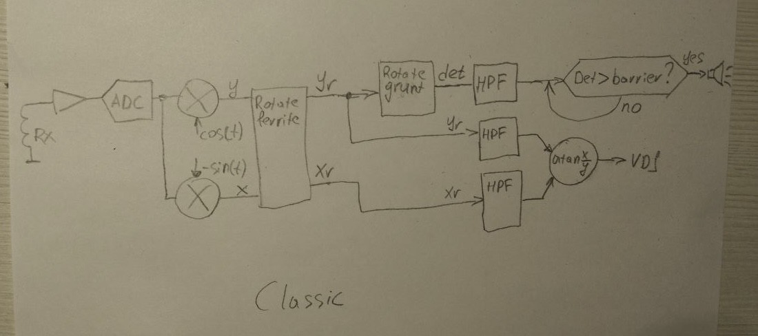

    Maybe I'm wrong, but the rotation of the vector is carried out according to such formulas. I'm not saying, I want to understand))
    x1=x*cos(angle)+y*sin(angle);
    y1=y*cos(angle)-x*sin(angle);​

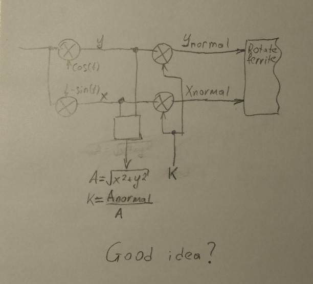

      Is it possible to consider the following method: to pre-normalize the signal amplitude in front of the synchrodetector. That is, there will be no increase or decrease in the amplitude of the signal when the sensor approaches the ground or target.
      Will this approach weaken the impact of the soil?
        There are different ways to implement GB. The most straightforward way is to simply rotate the phase of the demods until the R channel is exactly 90° to the ground phase at which point the ground R signal is zero. That looks like this:
        RGB = mag(GR)*sin(ph(GR) + ph)
        and you adjust ph until the sin() term is zero.

        I'm not sure what you mean about pre-normalizing the signal amplitude. Adjust the preamp gain so the demods always see a constant signal level?
          Maybe it will be clearer this way?
            I think it will get really noisy especially at low signal levels. Digital radio systems sometimes use a similar approach whereby small signals are gained up and large signals attenuated, and an "RSSI" signal is included with the main signal so you can recover the real signal strength later. But these radio systems use phase-modulated encoding where changes in amplitude don't really matter. With a metal detector, the amplitude is used for the audio response so amplitude steps can cause a lot of noise.

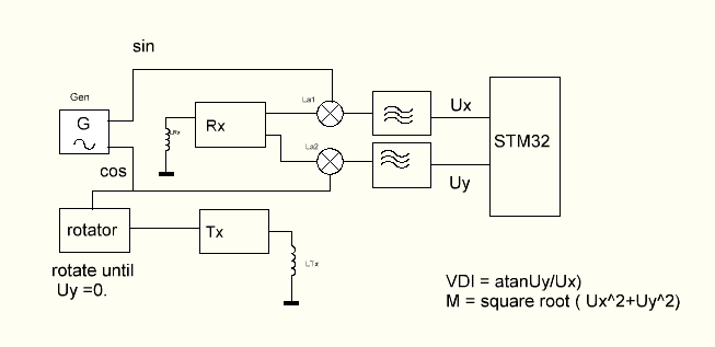

                Thats basically how a VLF detector is done ? So zeroing Uy ground balances the detector?
                  Click image for larger version  Name:	image.png Views:	0 Size:	15.0 KB ID:	435761​​
                  It's a classic. It looks like a Fortune metal detector, only it is built on a PIС.
                    yes, rotator it is a phase shifter
                      Yes, that's right, it has a similarity with the FM receiver: when there is no transmitting station, that is, noise in the dynamics. But, there will always be a signal in the metal detector due to the imbalance in the DD coil.

                        Fortune has enough problems associated with such a scheme.
                          this is not a Fortune, it is my own design and it is working ok, rotator/phase shifting is done by stm32f103
                            What kind of detector do you have? There are not so many of them on stm32f103.
