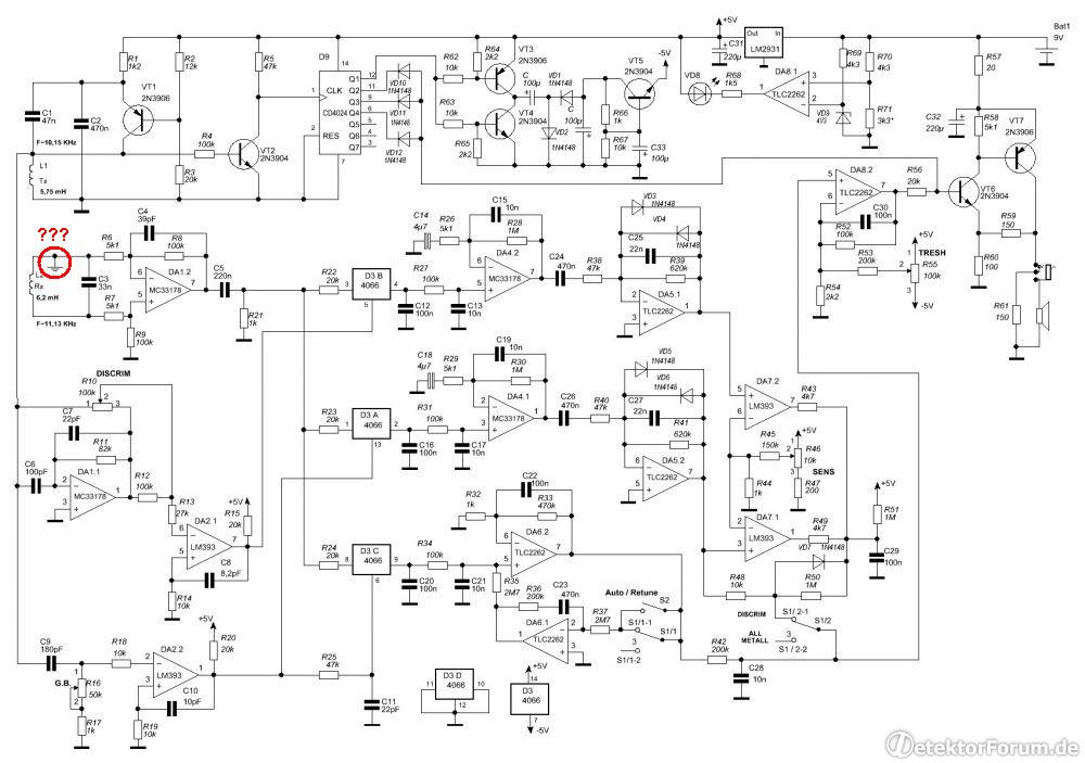

        Does anyone know what is meant by the symbol in the schematic? in RX Side? Must it connected to Ground or Case?
          There is no need to make this connection to ground, as 5-pin Tesoro coils already have this connection made inside the search head.

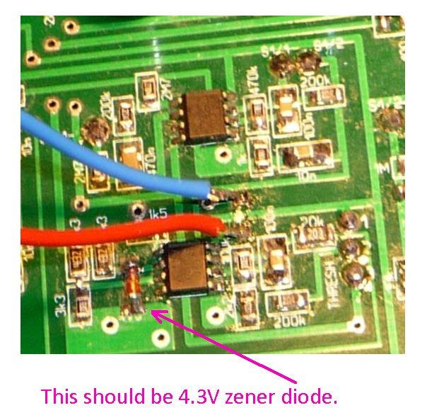

                The other diode is a 4.3V zener. I see it on the PCB located just above the point of the arrow you drew, but I can't really read the designator on your schematic (VD?).

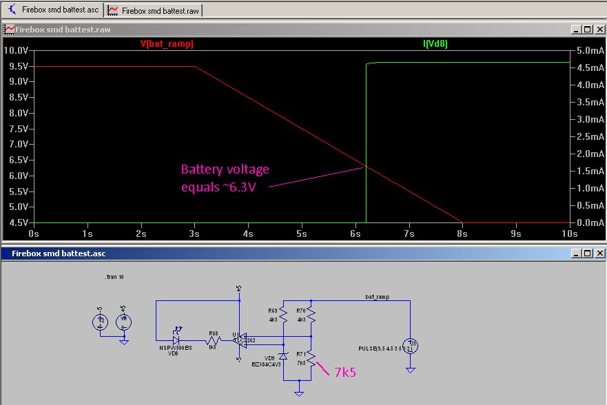

                  The way I think your battery test circuit works: it does not illuminate the LED so long as you have a good battery. The LED illuminates only after the battery has dropped to a predetermined level, set by the 4V3 zener and the resistors R70/R71.
                  Problem: With R70 = 4k3 and R71 = 3k3, your "battery low" indicator would illuminate at Vbat =~ 9.2V which seems awfully high to me.
                  I don't know why your LED won't light, because 9.2V is almost fully charged for a 9V battery... unless maybe you are using 12V?? Or unless your "5V LED" is something wierd. I think the circuit uses a normal red (or maybe yellow) LED.
                  Anyway, if I were you I would replace R71 (3k3* on your circuit diagram). Use maybe 7k5 or 8k2. That would make your VD8 LED trigger at a battery voltage of around ~6.3 or ~6.0V. That would still be enough juice for reliable detection but, that's just a guess. You would adjust R71 up or down if need be.

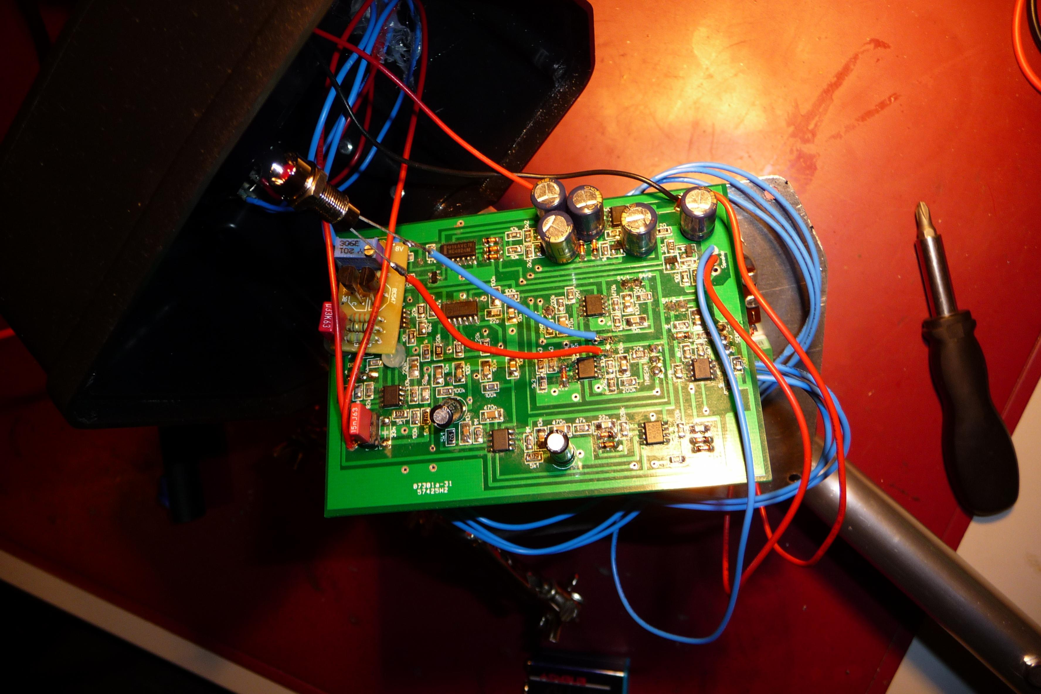

                    I tested as follows:
                    I have connected a power supply for voltage regulation with Bandido. Then I turned the power back slowly. At about 5 volts the Bandido is started "beeping" from speaker. but the soldered LED doesen´t work LED means "light-emitting diode"
                    I have tested the LED with the power supply. It operates on 2 volts! but not in the Bandido Battery Test circuit

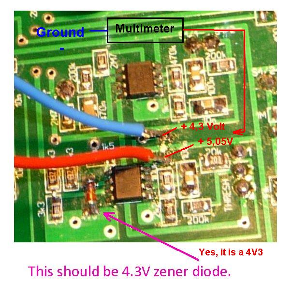

                      If you have a variable power supply you can test the battery-low circuit with a multimeter.
                      Place black meter lead on ground, and the red lead goes to DA8 pin-1 (battery-low output). Start the power supply at 9.5V and then lower it until the DA8 pin-1 output changes
                      The meter voltage should normally be +5V, and then suddenly swings to -5V as the battery voltage decays below the trip point. You should also be able to detect battery-low at the junction of R68 and the LED (that would be your blue wire).
                      Is that a 4.3V zener you have at VD9?
                        Now i have measured as shown in the picture. If I lower the voltage, this voltage is going down too. But there are no -5 volts on pins
                        By the way, yes it is a 4V3 Zener Diode, but it looks like an normal diode
                          I have found the problem. Pin1 from DA8.1 was not correctly soldered to the R68! The LED works now, but the Basic Voltage must be over 9,5 Volt to deactivate the LED and the sound. My 9 Volt Block haven´t enough voltage to do this. If the voltage drops down to 9Volt, the Bandido is beeping and the LED is on ...... so what can i do to reduce this ??? The Bandido can work until 5 Volt. I belive i must reduce one Resistor, but which one ?

                                Replace the 3k3 resistor, R71, with something around 6k8 or 7k5. That will set the trip-point at around 6.7V or 6.3V and maybe it will stop bothering you. Using a higher value for R71 might be better, but you can work on that after any other bugs have been worked out.
