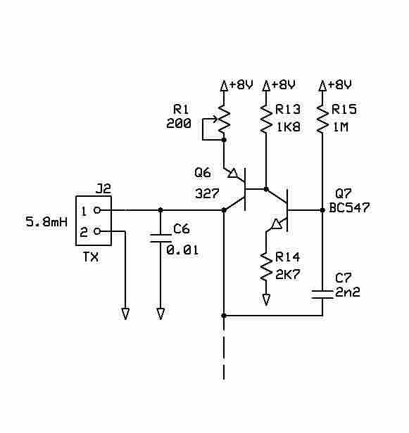

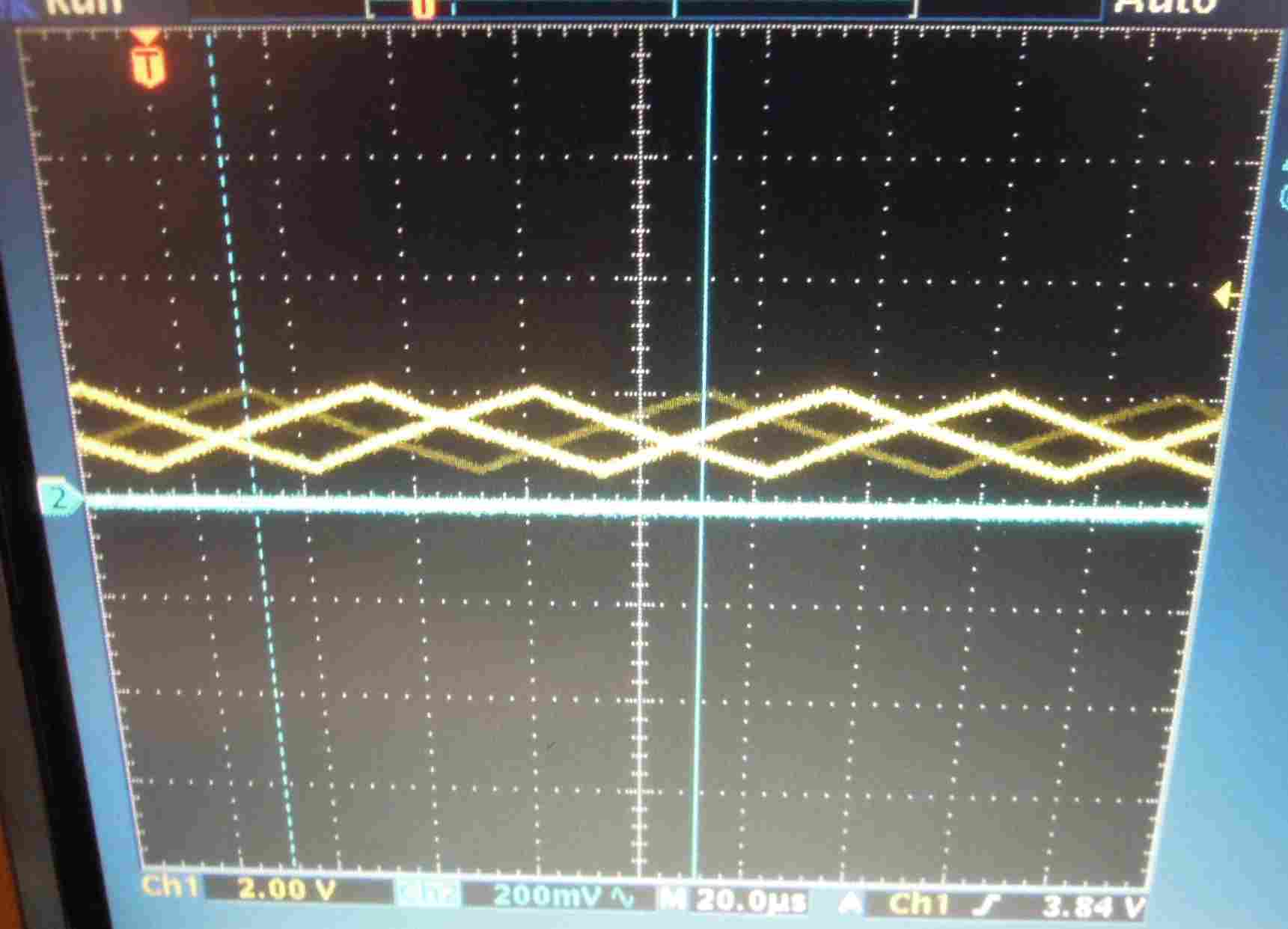

The IDX' oscillator has a fixed emitter degeneration resistor of a PNP transistor. It is a handy place to regulate saturation point of this transistor and consequently Tx signal purity. The only thing missing is a trimmer.
It is OK to leave a fixed resistor if you know the optimum value, and in mass production it requires obtaining transistors with narrow tolerance of beta, something that amateurs will never have.
or you can use a small piece of ferrite and find a sweet spot on the coil body that provides a perfect balance, and fix the ferrite there. You'll find that there is always some remaining minimum you can't make any deeper with either curl or a ferrite, and you can make it deeper by finding a sweet spot with a small chip made of a milk carton (very thin aluminium foil is in there).
