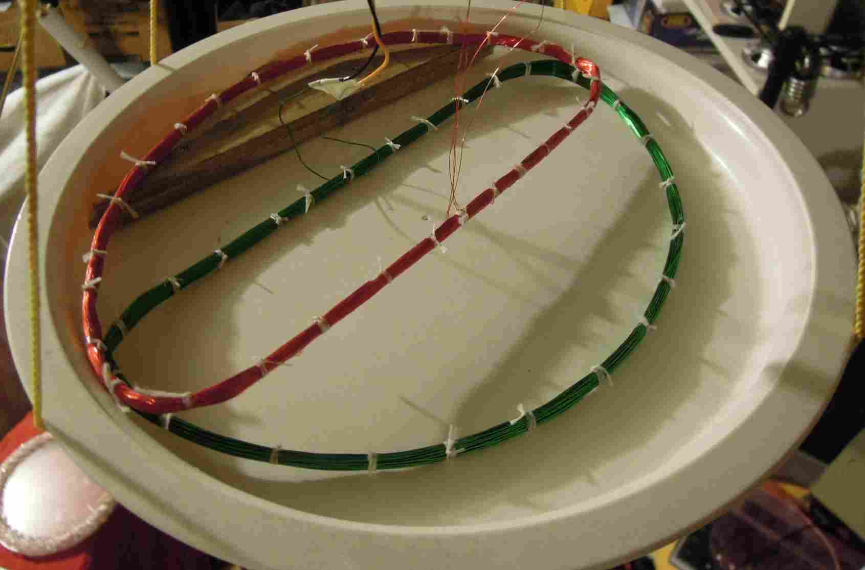

    I'm using the 45T TX and 280T RX that's bifilar wound. This is the first time using those
    so they are not nulled but looking at the signals I don't know how to proceed? Moving
    them around does not change the output much. Is there too much TX getting to the RX?
    I expected a different output! Here's a pic of the coils;

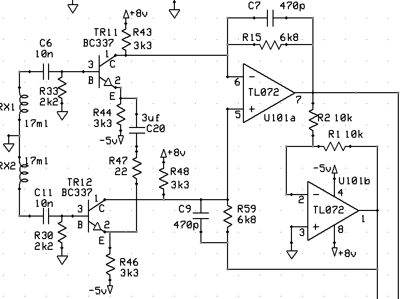

    I'm not sure if I changed the caps in the preamp or not... I think we changed the 470pf to 68pf.
    • Looks like there is way too much overlap.

        I have been away for a while ,,But I see you are moving Onwards to coil connecting -Stage ..
        YES -Nulling !!! I have now Built 4x DD coils & have now gotten the hang of the Nulling ,As DAVOR says you need to fix the coils to stop movement ..
        What I have found is that after I tune the TX-coil for frequency with cap selection,, !![in the IDX case thats close to 6.6KHZ] this done from the unit fired-up ,I fix the TX in place temporally by Hot-Glue in maybe 6 or so spots .
        I then lay the RX over the TX as you well know , & it is usually only about a 3/4'' gap -between the straight d/s leg's ,I then scope the Both for good sinewave , [I have only single scope,But ''STEVE-G/NUT ,showed me a way of using the exturnal feature & that works a treat -You can view each Coil by probing each TX & RX as long as you leave the time alone ]] .Then scope RX only to achieve a nil reading or minimum- reading [I probe the output of the Preamp for this..] .HOT glue the RX in spots but leave the straight D section for further-finer- adjustment , once close I then try fine-tuning the caps on RX . for the offset ,& the redo the Null .. for minimum output on RX [This is when the IDX is fired up]..
        IAM-ONLY a Novice at this but have learned a lot from you members & many hours of practical coil building..my last coil came-out very good ..
        LOOKIN-GOOD-MATE ,All the best with it ,,,,,,,,,,,,,,BARRY..
        • Well I disconnected the RX from the board and nulled it today. It now works in Disc mode but only has a range of 2"!
          There are a couple of things on the board that are not to the schematic. I'll have to verify them and change them to
          match. So a little bit of sucess!

                      Please enlighten me a bit. On U105, what is the purspose of the back to back diodes?

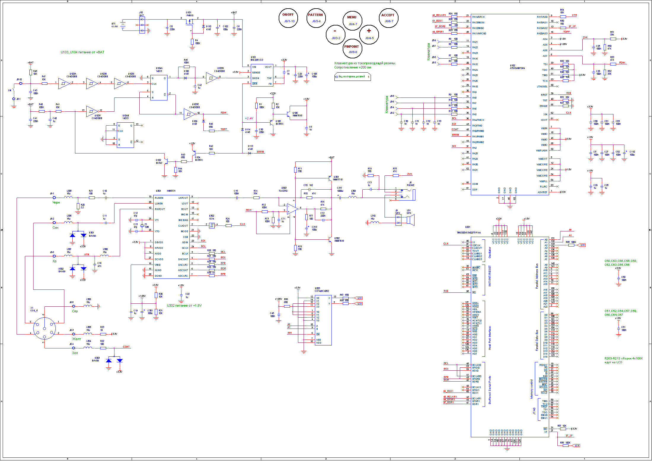

                          • I had some pcb's made to build an ARM M4 with Wolf chip to do something like the Xterra;
                            The processor can do the waveforms with DMA. And direct in and out for low mess and noise.
                            Maybe this winter I will start developing this board. I think it's easier to do analog but you
                            might be able to do some magic and see deeper with a good digital design. If nothing else
                            it's fun to play with!

                              You will have to ask Davor, its his schematic.
                              • It is no mystery. I found that I like proportional audio much better than the common binary beepy response. Because in an intuitive soundspace the volume/depth relationship is too steep for linear law amplification of target responses (the 6th power etc.) I found that equalising the response by means of a log-compression works the best. Hence a diode compressor. As a bonus, I can tolerate more gain for the small signal so my dynamic range is wider.
                                I also kept a similar arrangement for gating, as it keeps the opamps out of saturation. Because all the opamps in a same package draw bias from the common circuitry, and they all share common rails, any saturation would affect all the opamps in a package, at least by introducing a delay after a saturation event. The overall response is dead on punctual with diodes, and I can easily discern multiple tergets.
