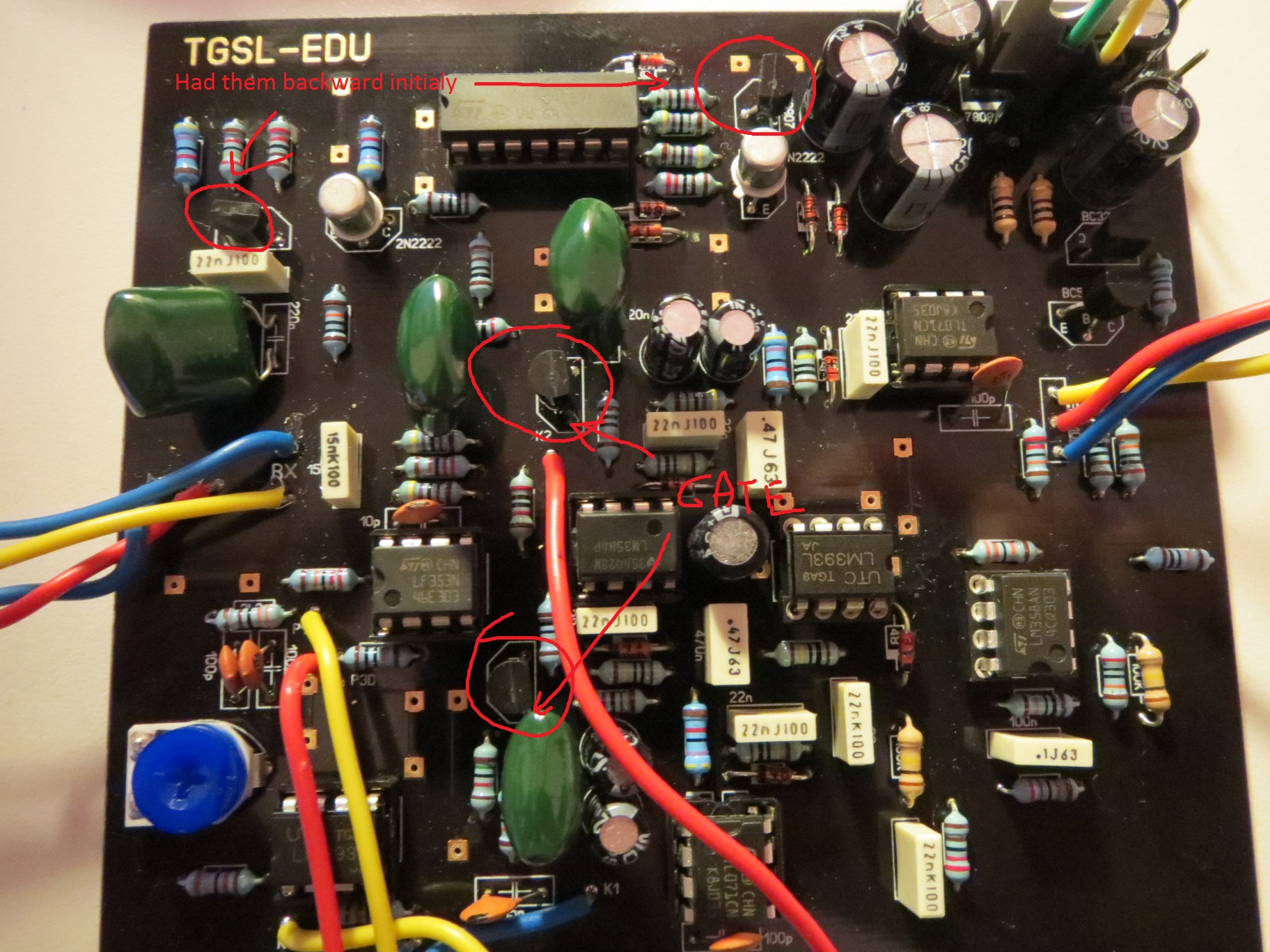

    I'm working on getting TGSL-EDU to run. I use Tesoro 9x8 concentric web coil (white, 5 pin). After initial problems with some of the transistors installed backwards (did not check the datasheet as should have) the board came up. I checked the signals with the scope again the very helpful pdf "TGSL 101" (thanks Don Bowers!). All looked good, just I had pots ends swapped, corrected it.

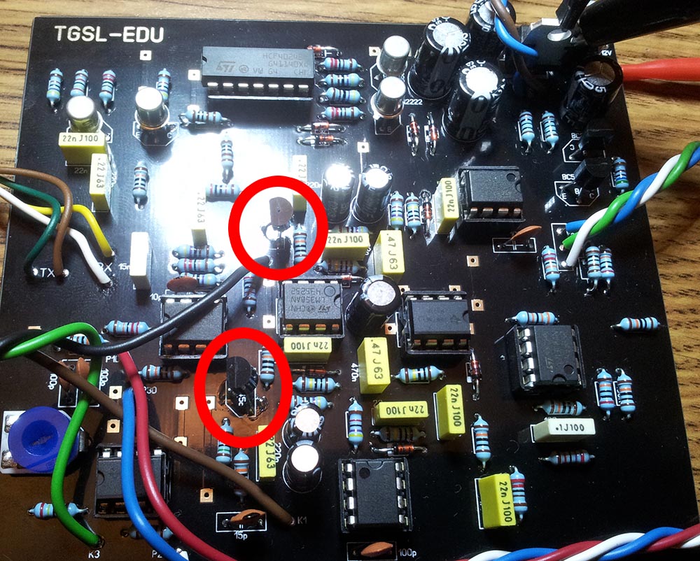

            Bf245 in my silverdog kit was a pain in the a.. I discovered that those fet has to be reversed from the design on the board.
            Check the 2 back to back capacitor too. 22 microfarad with minus in common...
              I rechecked BF245 s; both look correctly installed, Gate is in the correct place (facing "down" when you look at PCB); Source/Drain can be interchanged (I didn't know you can do this, but that what the datasheet says). Once the board starts beeping the setting sensitivity to min does not stop the beep, but if you move a metal in the from of the coil the beeping stops. Very annoying.... I don;t see a "quicky" solution/ I think I will have to learn how the whole circuit works and work through it.
                BF245 in silverdog kit are swapped respect silkscreen of pcb. Anyway for clarity i show how they have to be correctly soldered:

                Anyway if you said that gate is facing down it should be correct...
                Try to re-check every component, diodes direction etc.
                Seems to me a capacitor problem...due to the long times of 15 sec...but really i cant figure it.
                I know very well your situation...it happened to me when i firstly made my tgsl...everything was correct according to silkscreen...but damn BF245 are swapped internally! When i found the error was very happy!
                Hope you find yours very soon!

                      Silkscreen of silverdog boards is correct!
                      BF245 instead are produced from several manifacturer in different pinouts.
                      Mine, furnished by silverdog kits, are inverted internally...
                        The 2n2907 that came with the kit had pinout reversed; I installed them per PCBs silkscreen initaly but it was wrong... The board did pull 100mA then before I fixed it maybe 2n2907 got damaged?? I should be able to put in any general purpose PNP transistor; correct? .The FETs seem fine, the pins are even labeled G S D...

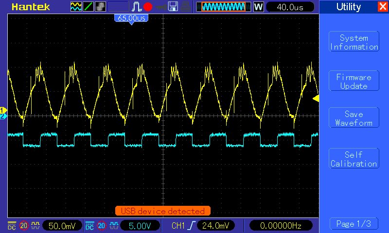

                            Can you check Tx amplitude on coil?
                              its 15V

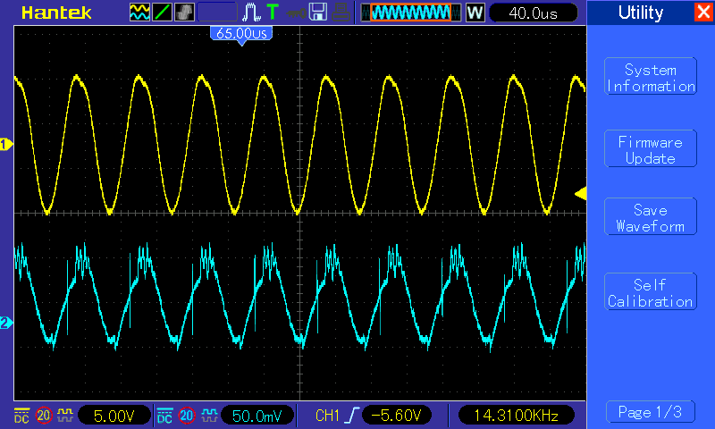

                              I'll upload two images; first signals straight from the coil (yellow is the TX, blue RX) the second is the RX signal from U101 Pin7Click image for larger version
ID:	341033Click image for larger version
                              the TX freq is 14.3KHz not 14.5KHz; I'll try different caps to get closer to 14.5 once they arrive..

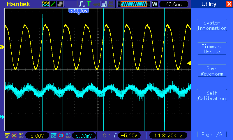

                              I looked at the signal path. What is expected voltage signal at the gate of TR4 and TR5? There are the signal on my board;
                              Yellow is RX from U101 pin 7; blues Gate of TR5. Is this enough to open/close TR5?
