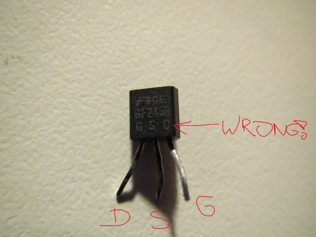

      @Daren, the level is fine for gating FETs, but I see glitches originating from U102 (I guess) that are not supposed to be this big. Could you check U101 and U102 decoupling capacitors?
      These glitches are far too big for mere FET charge injection so there must be something else. In case it is in fact charge injection - your FETs are fried.
        Got it to work! Haven't test it well, but not beeping and the range is fine...
        @manny77: You were right I just did not listen.... I rather refused to believe... The damn FET ARE swapped inside. The marking on them is wrong!!! Had to take them out and test... manny77 thanks.
        Thank you all for the support.
        See the FET here
          Hehe! Very well! This thing drive me crazy that time...not easy to understand the problem because everything is correct. Anyway i point silverdog to this problem...he said that place a paper with information for those fets in tgsl kits...but he don't....
            So the FETs were not fried, but the pins were swapped.
            FETs are easy to check on a multimeter (MOSFETs are not). Using a gate as a common electrode you may observe a diode-like behaviour towards source and drain (just follow the FET symbol arrow).
              Davor, that is exactly what I did (after googling it....); Just tested the two diodes, that clearly proved that that the gate was swapped.
              ( My next step was to replace all active parts one by one... Thankfully never came to that.)

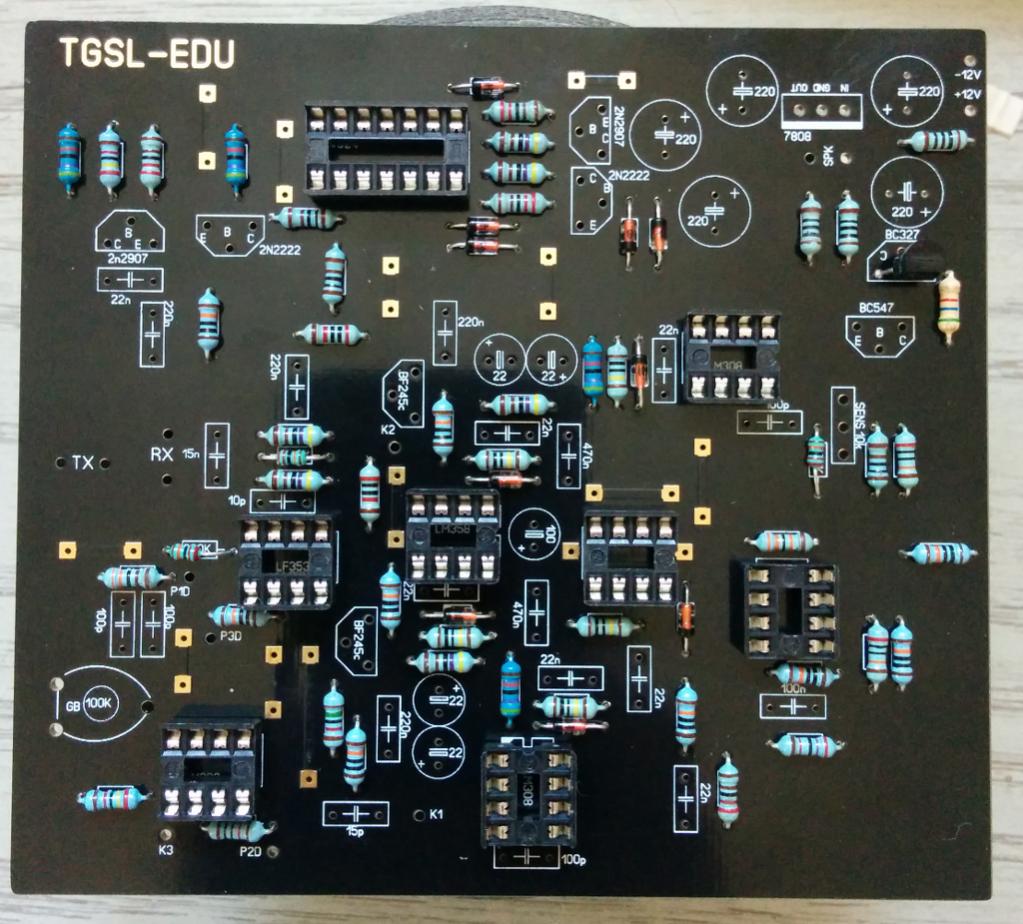

                      Hmm, anybody know if the fet's still reversed ? Or if the PCB silk are wrong ?
                      I got my kit from Silverdog last friday, and start soldering today. It would be nice if i could place
                      the components correct from start.
                      There was no note in the envelope i got.
                      Here's what my PCB looks like:Click image for larger version
                        hello ice
                        just take the datasheets of the parts you are not sure
                        for example in case you take 2n2907 in metal version the emitter ist where the metal pin is
                        if you take the plastic case variant you have to rotate the part compared to the silk screen print
                          Thanks .
                          I have the metal version, and will check how they work tonight.
