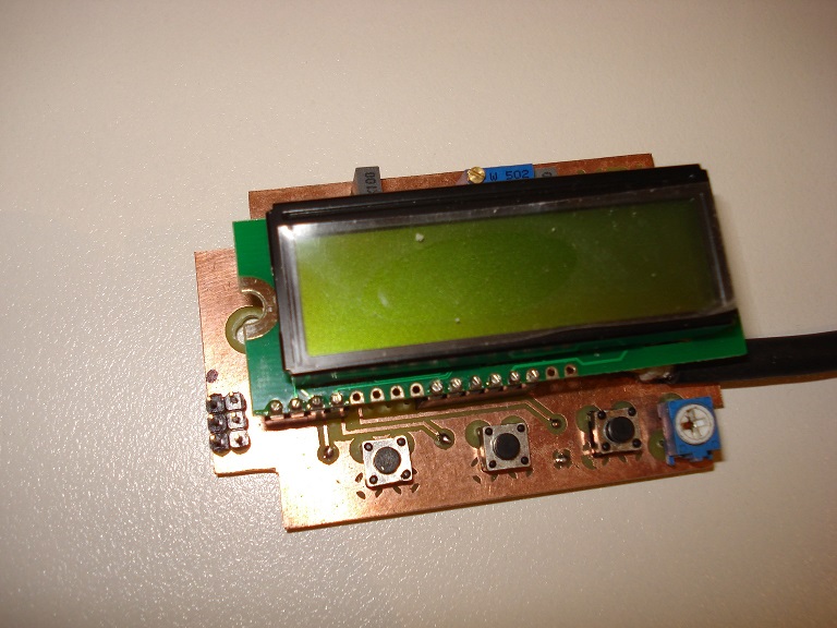

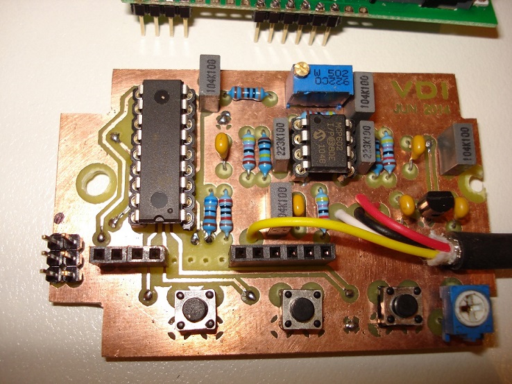

      Hello,
      The VDI is a nice addition to our TGSL units. Points X & Y of VDI are connected to pins 1 & 7 of lm358, shown on schematic as U103. Wish I could give you my version of a double sided pcb of the VDI, but my cad files have become corrupted. The disc. switch must be on when using the vdi and the vdi must be set to zero when the disc. pot is set to blank out light aluminium foil. The tgsl with vdi is great for hunting copper and silver coins. When the vdi gives you a value greater than eighty, you've got a good target.
      As for the two tone switch, I always search in mono tone and only use two tones to identify iron targets. Beer bottle caps give a mixture of a high and low growling tone . In mineralised soil or wet salty sand, it gives a lot of false signals. Don't use the vdi with the two tone on, it is useless.
      The schematic and hex code are all in the IDX-PRO + PRO thread. I think there is a pcb drawing in the thread.

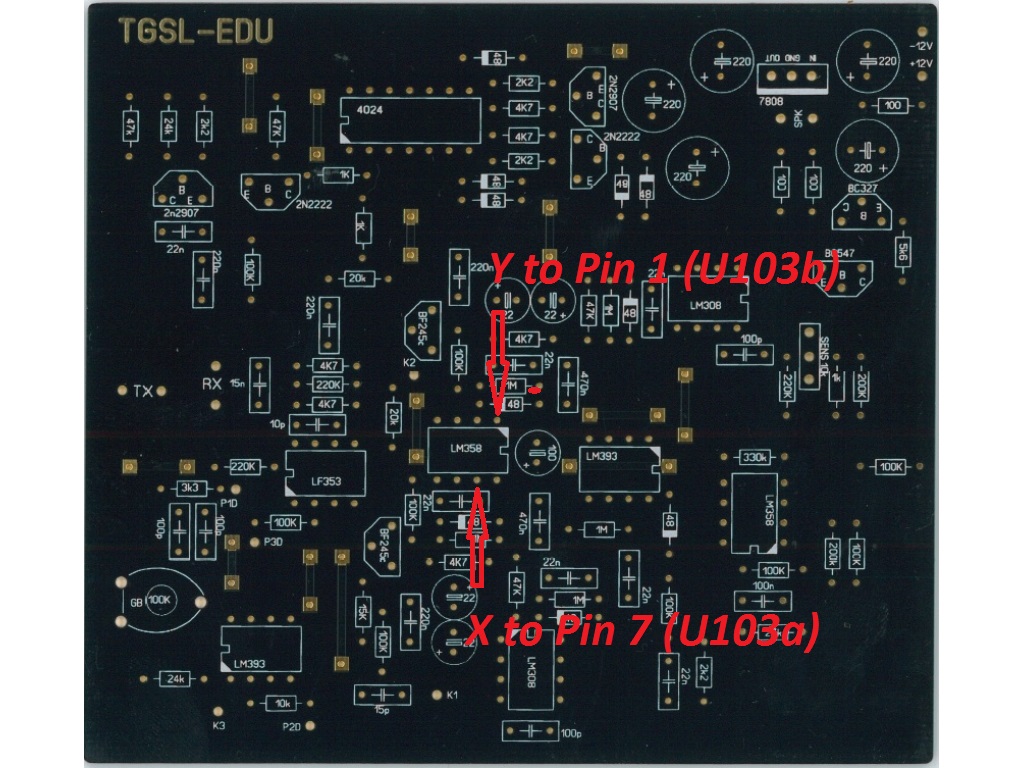

          @Finderskeepers:
          Where are the connecting points on the Tgsl-Board. On both LM308's (pin 6) right???
            @Findskeepers:
            "The VDI is a nice addition to our TGSL units. Points X & Y of VDI are connected to pins 1 & 7 of lm358, shown on schematic as U103". You have given me the Answer above a time ago
              I have finished the Tgsl Board.....it works great. Now i will build the two tone mod. I have tested the Geotech Vdi module, but i have problems with it!
              Pins 1 & 7 of lm358 on Tgsl Pcb dont work with geotech vdi module, i have a -135 signal for all metals and objects, the vdi number dont change at any object. Without swinging objects over the coil the Vdi produces erratic changing signals. Can someone help me with the connection points on Tgsl board????

                did you take the right lm358? i tremind it was the one which is in Center of pcb
                  read here
                  start at posting 1376
                    Thank you Bernte_one! I will proof everything. But I think I have already tested these pins on the right lm358 with no succes. I will proof everything twice;-)
                    Hope i will get the Vdi working fine;-)
                      Ok, the Vdi works. Iron in - ,foil around 0 and good targets at +40 and above. But i think the Arduino-method will make the VDI-numbers more accurate. But im happy now with that first impression of an working Vdi module on Tgsl. Thanks again to finderskeepers and bernte_one for the help;-)

                          Hello again,
                          i connected VDI on following pins on lm358:
                          X to Pin 7 (U103a)
                          Y to Pin 1 (U103b)
                          .....as shown in the attachment.

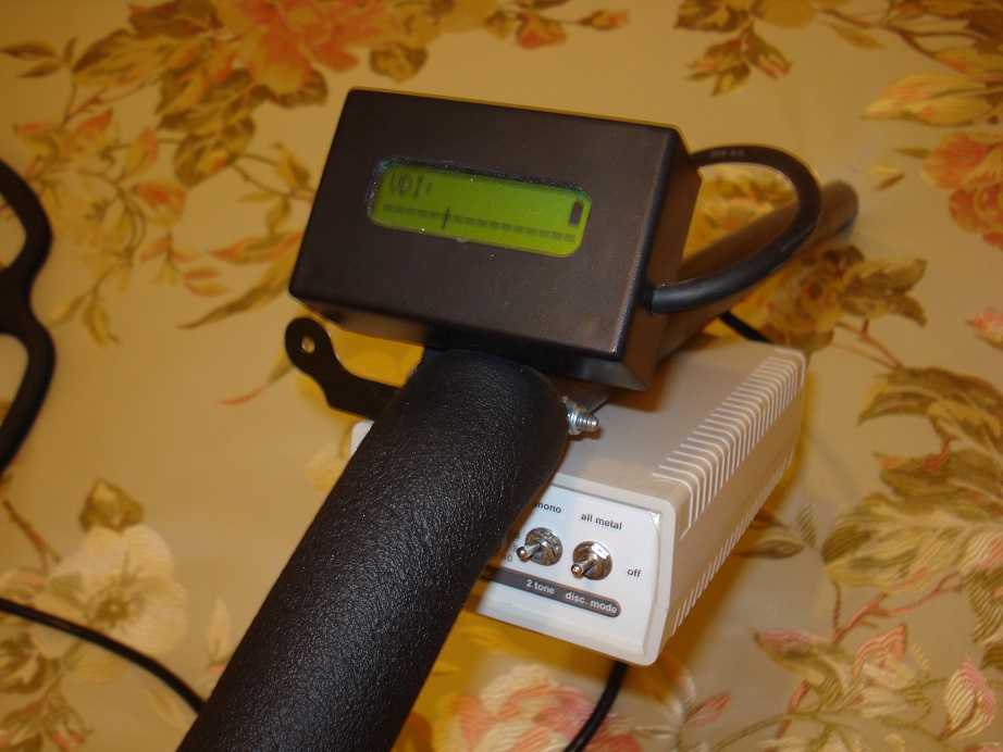

                              Hello,
                              here are some first impressions of my Tgsl......the project is still in progress;-). The device is fittet with neoprene....i saw this idea here in the forum...i dont remember who had this idea, i will thank this person a lot....it works great! I will also thanks daren, silver dollar, Bernte_one and all the people who helped me, ive learned a lot with this project!
