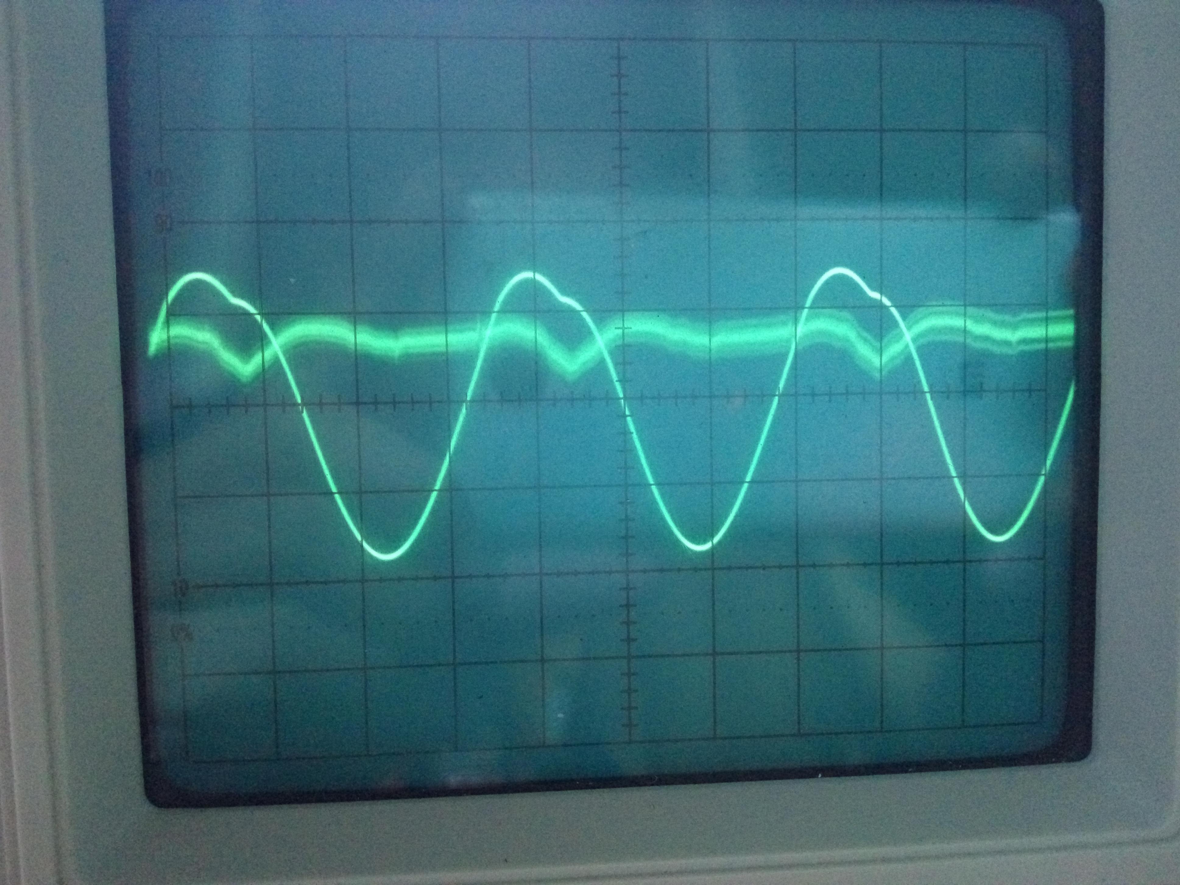

    Now you can check the frequency, when you put the RX coil in TX cirquit. In your case, you should have approximately 14,7 kHz.
    approximately
    That test is do with Rx and Tx connected,
    Let me try without Rx
      Sorry miss reading, let me put Rx to Tx
        Originally posted by blobber View Post
        This is much better.
        approximately
        Tx 14khz 10us 7.12div
        Put Rx to Tx
        Rx 13.4khz 10us 7.42div
          Yes you are right, I was wrong...sorry. That's correct what you have now.
          Well, now you could connect the coil in normal way, and adapt the parallel capacitor C6 in RX tank , to see what's happend, when you change the value in steps of 1 or 2 nf, while watching the RX output. Around 15 nf, you will have probably the highest level of P-P in RX output, later you can do fine tuning here, with iron washer or coin, to get the minimum again.
          Also you will see now, the proper relationship in TX and RX. But do it away of any metall. When you has chosen your value for C6, than you should follow the procedure in your pdf file, while checking all measurement points.

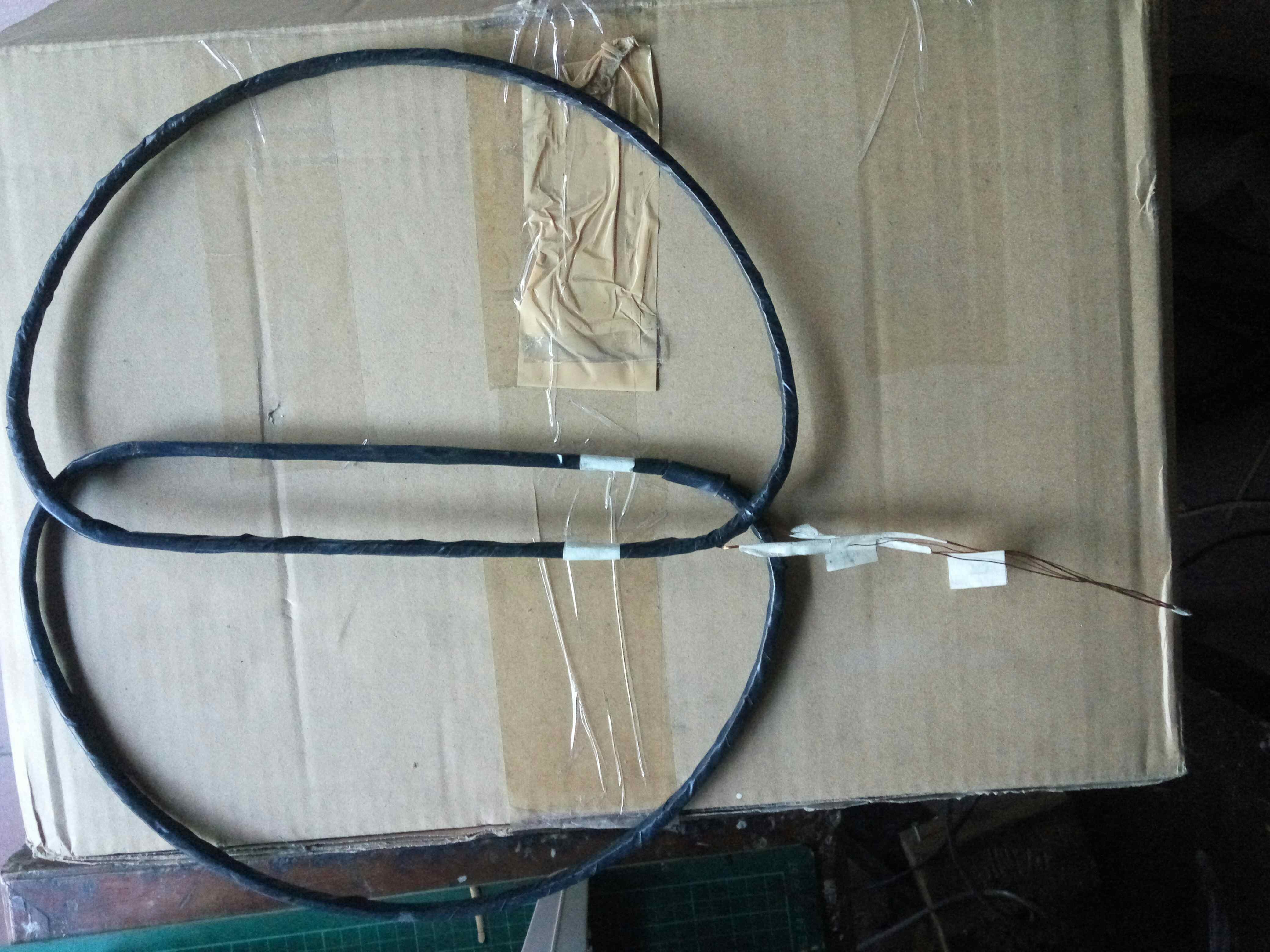

          Your coil is already fixed with epoxy?
            What is the best output should i get when i change in steps of 1 or 2nf?
            I already put epoxy on it, i have non epoxy coil to, should i change it?

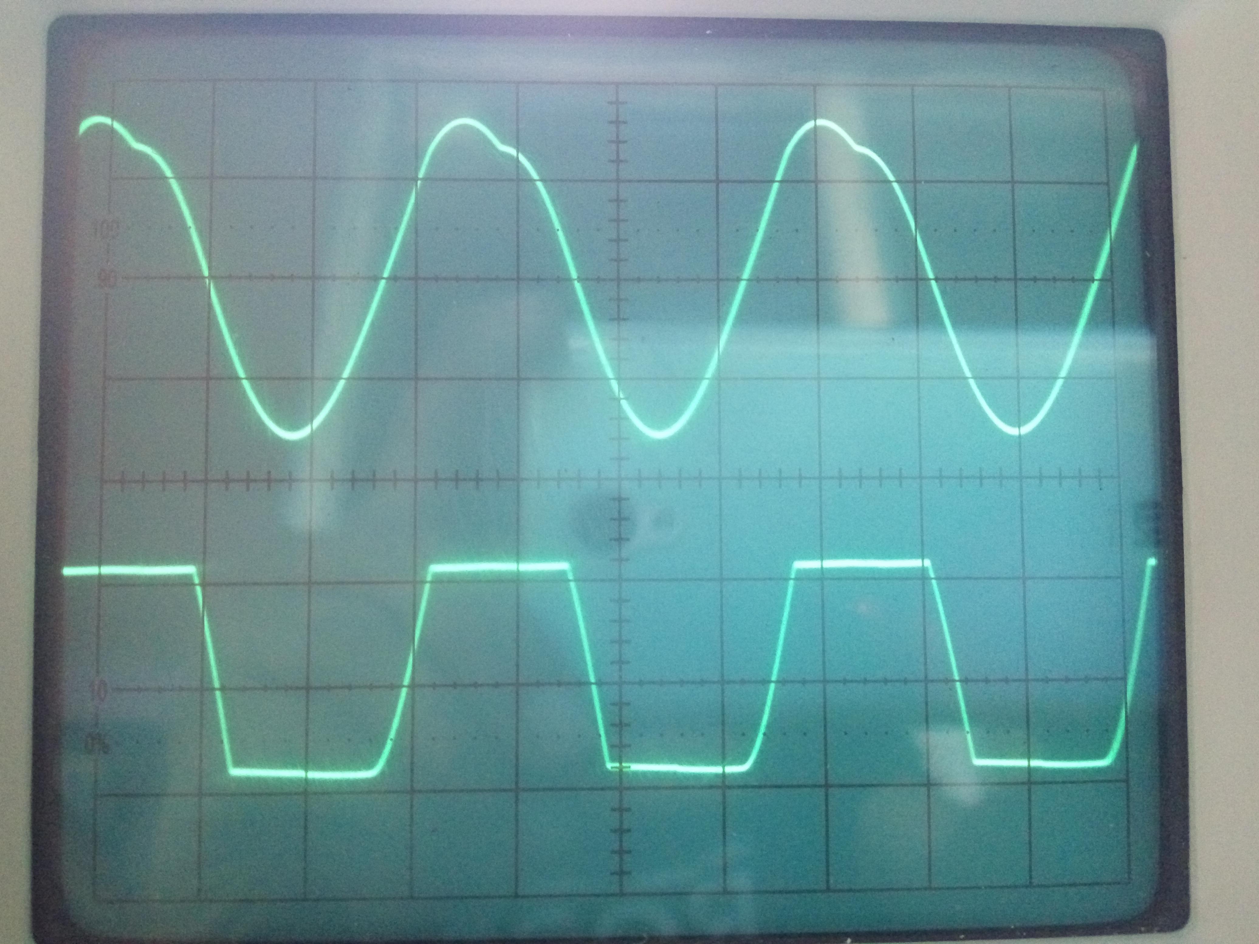

              I get this on step 4 dons pdf
              J1-1 Tx (top) 20us 5v/div
              Pin 7 LF353 (bottom) 20us 5v/div if i go bellow 0.2mv the signal is expand and gone.
              Is this normal

                  What you have for RX output in mV now?
                  Sorry I write on my mobile phone, so I could not see your last post.
                    Forget my last post, im put wrong cable.
                      Okay.
                      When you also change two resistors in TX circuit (yellow marked), you will also have 20 V p-p.

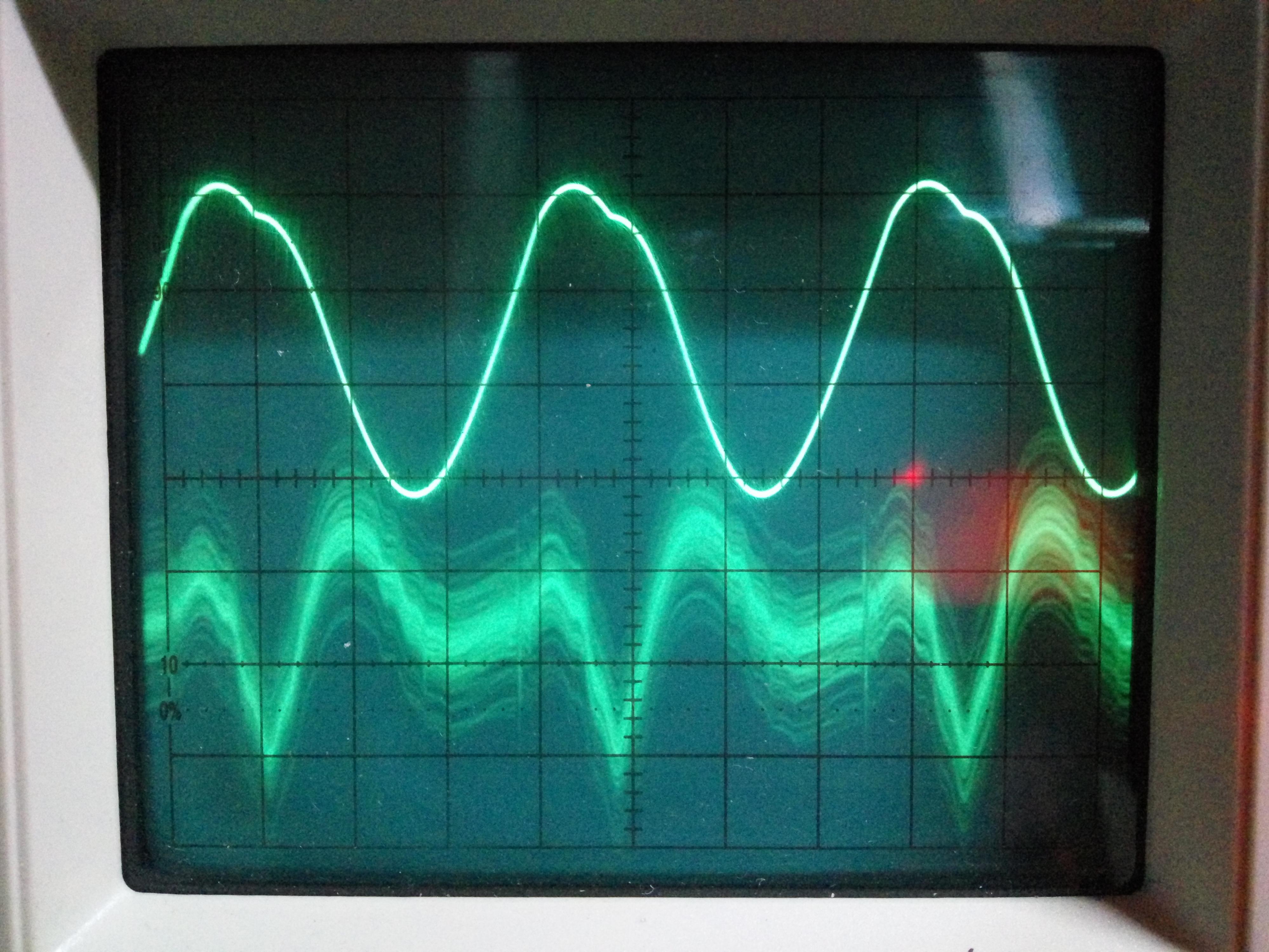

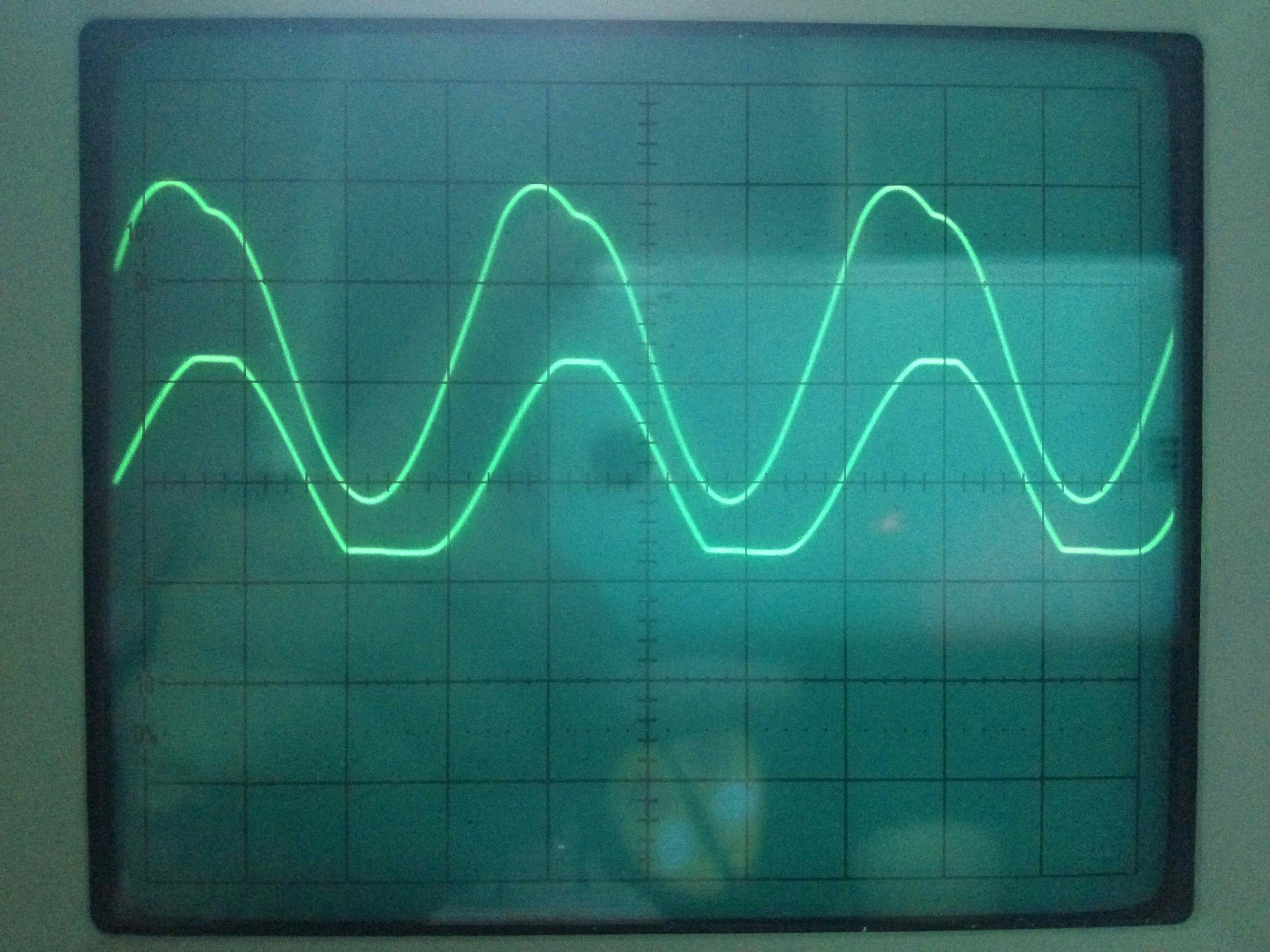

                          J1-1 Tx (5v) vs LF353 pin 7 (50mv) 20us
                          • #43
                            What output voltage you get from Tx and Rx or its vary on the coil? Le me take a bath first....

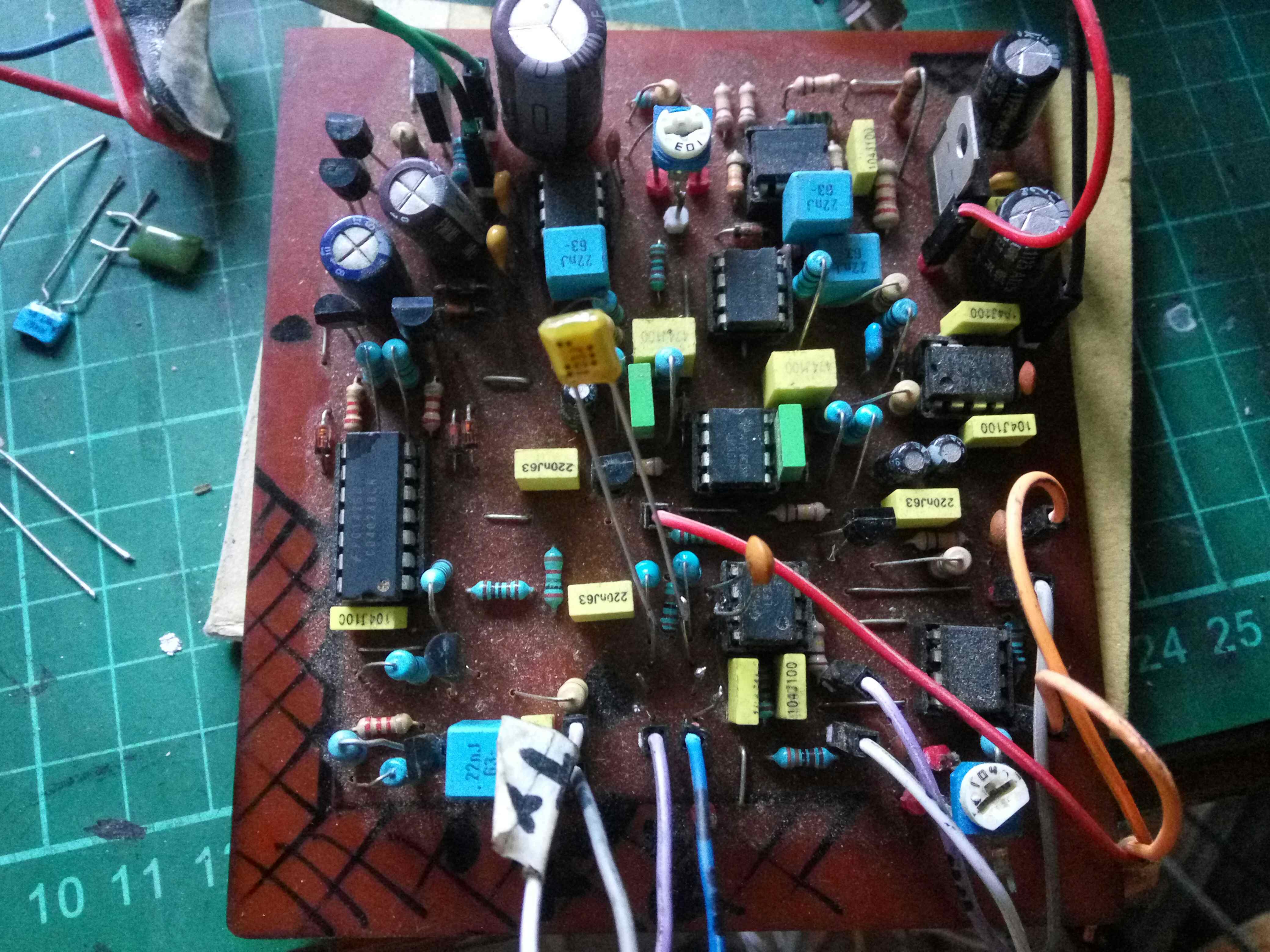

                              This is my setup
                              Coil
                              Board
                              Tx vs Rx at 5v 20us 10nf Rx

                                Okay im done, the best is 30cm with pft...pft sound
                                Btw uaing NE5532 get better result on some trasy coin detecting.
                                Change Tx caps to get 14.5khz, before i just gwt 13.3khz
                                It cant be nulled to 4mv the best is 17-30mv, the pin 7 u101 have sinewave, so it canot be zeroed, maybe i dont know how.
                                Waiting LM8833 as blobber sugested, for now lets use the what i get.
                                Poor me.... Good day all
