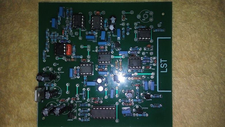

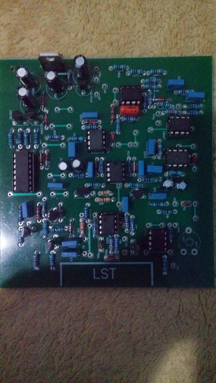

  • Hello friends, good evening, I built the tgsl version of Mr. Ivonico, I saw in a file that I have to have -5v, in D6, block 3, but I can not -5v. My doubt is: There will only be -5v with the coil in place and right? Well I put the whole plate together but I still have not made the coil. And he does not make sound without the coil? I'll only have -5v, with the reel? Sorry if you do not understand, I'm using the Google translator. If you're in the wrong place, excuse me.
    Thank you.

    • Hi, the coils must be connected to the TGSL in order to work, the 14.5kHz oscillator drives the negative voltage supply through the 4024.

                  • Understood friend Nandor, one more doubt, to drive the 4024 the coils have to be at the correct frequency or can I make a next one to be able to test?
                    • Hi, the 4024 is a binary counter and divider, it divides the oscillators frequency by 32. 14.5khz/32=0.453hz so the detector will sound at 453Hz. If you change the Tx freq. the sound that the detector produces will also change.
                      • Good afternoon friends, well, I discovered a mistake, in the project asks for 2n2222 and I bought 2n2222a, I inverted and now I already have -3,70v, but as the inductance does not come out right, of my coils, I believe that this is the coils are With 18 and 20 resistance, but it already exits sound and detects to 5 cm. Well now is to wait until I can measure the inductance lol, Nandor hugs, thanks for the attention.
                        • Try to achive "minus 6 volts" aprox, the opamps need it. Thats why it detects only 5cm. Have luck

                              • Good morning, friends, well I'm finishing my tgsl from Mr. Ivonico, I had some problems, in the project I have seen that the bc107 was replaced by 2n2222, but it was very warm, I noticed that the bc107 pinout in the schematic is CBE, and the 2n2222a is EBC. I reversed it and managed to get -6.30v. In D6. Well I just managed to get the voltage up by reversing the voltage by reversing the TR8 position. Could someone help me with the welding of the shield, I did not get anything on it. Nandor, now detects only 10 cm, my coils were like this, tx 6.10 and Rx 6.70 mh, I was able to buy the capacimeter to measure them. Thank you.
