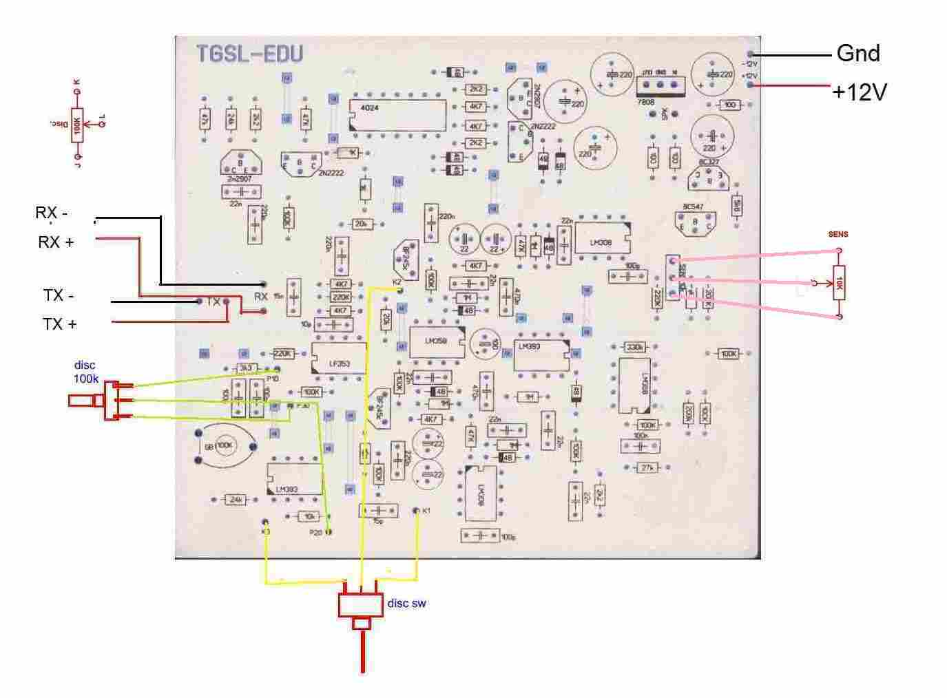

    I think this is all ....Switch+pot[ATTACH]36722[/ATTACH]
    Sorry for the trouble, did my cableing is right, if not can you do some sketch?My pcb is almost full with parts, just one or two more.

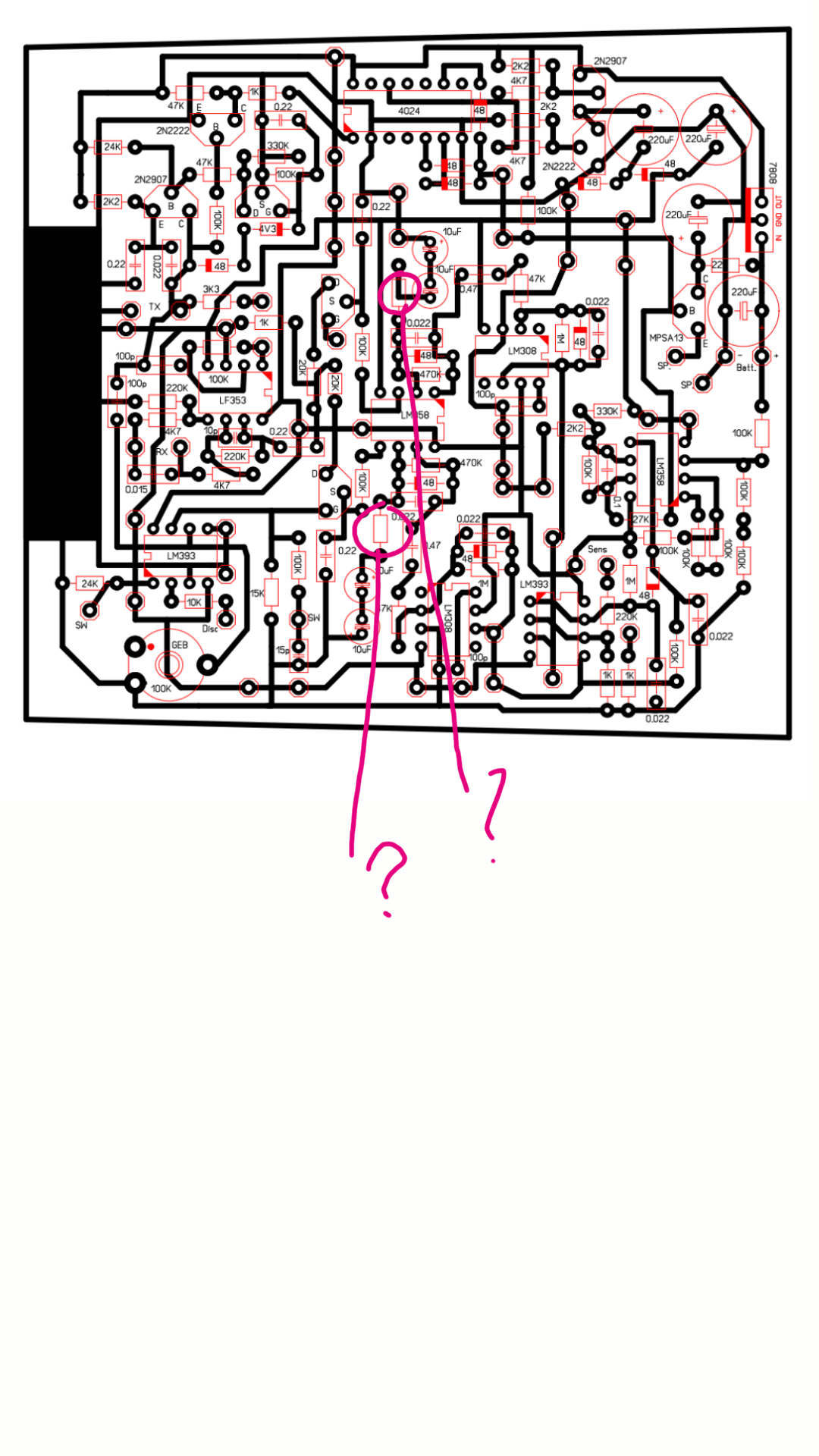

        Two missing R value
        Btw what version is this? I can find only one image in the net with unclear cableing.

            Two missing R value
            4k7 and 4k7

                Two missing R value
                4k7 and 4k7
                Many thanks toros

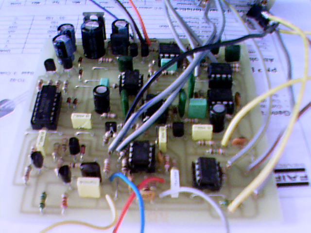

                      Pcb done with UA741 as LM308
                      Lets make the coil.....

                        This is correct i think... it's not that hard, just folow shema and u will find.

                              Did I do wrong? Now no sound at all
                              Using 9v DC adapter
                              https://youtu.be/-7gX0d5ernI
                                Using 9v DC adapter
                                9V adapter? Are u kiding me? u need minimum 11 volts to power unit. Use 2 batteries 9V in series to get 18v or some aku 12v. Using adapters or similiar thing which is powered with 220v is bad idea.
