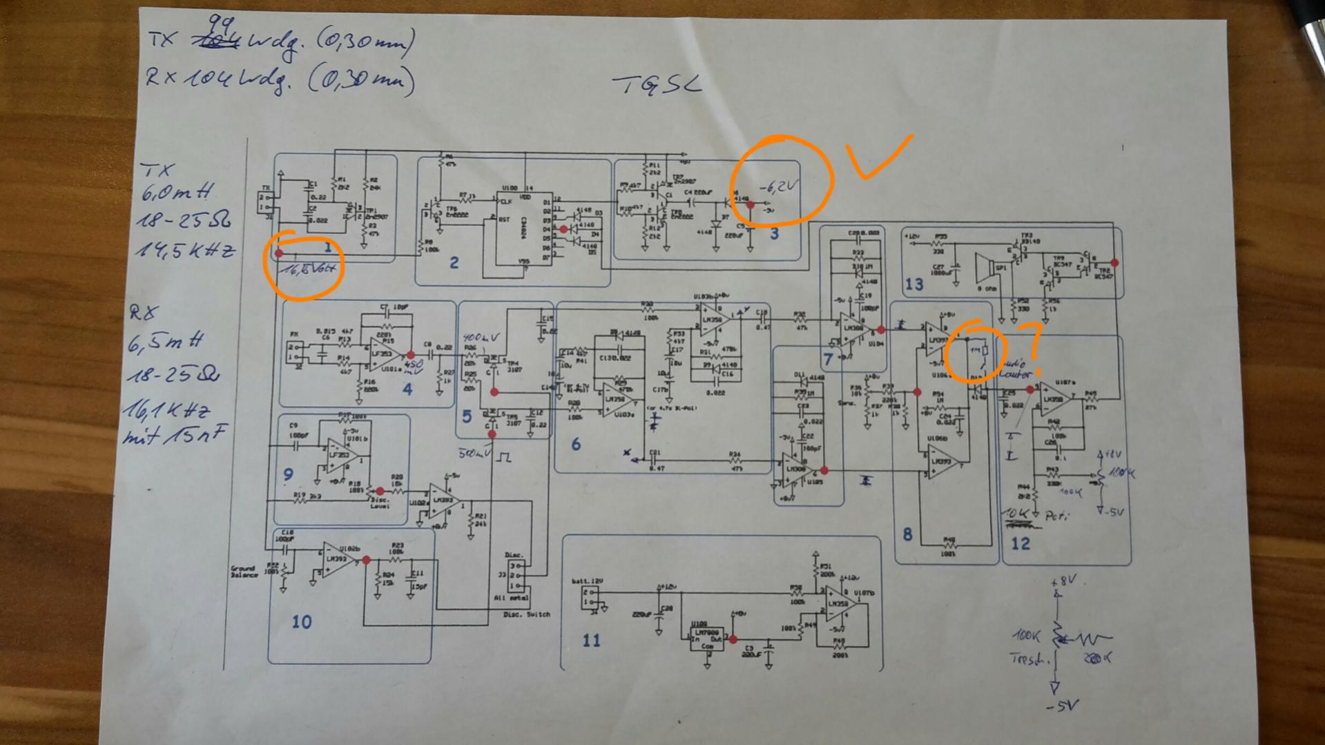

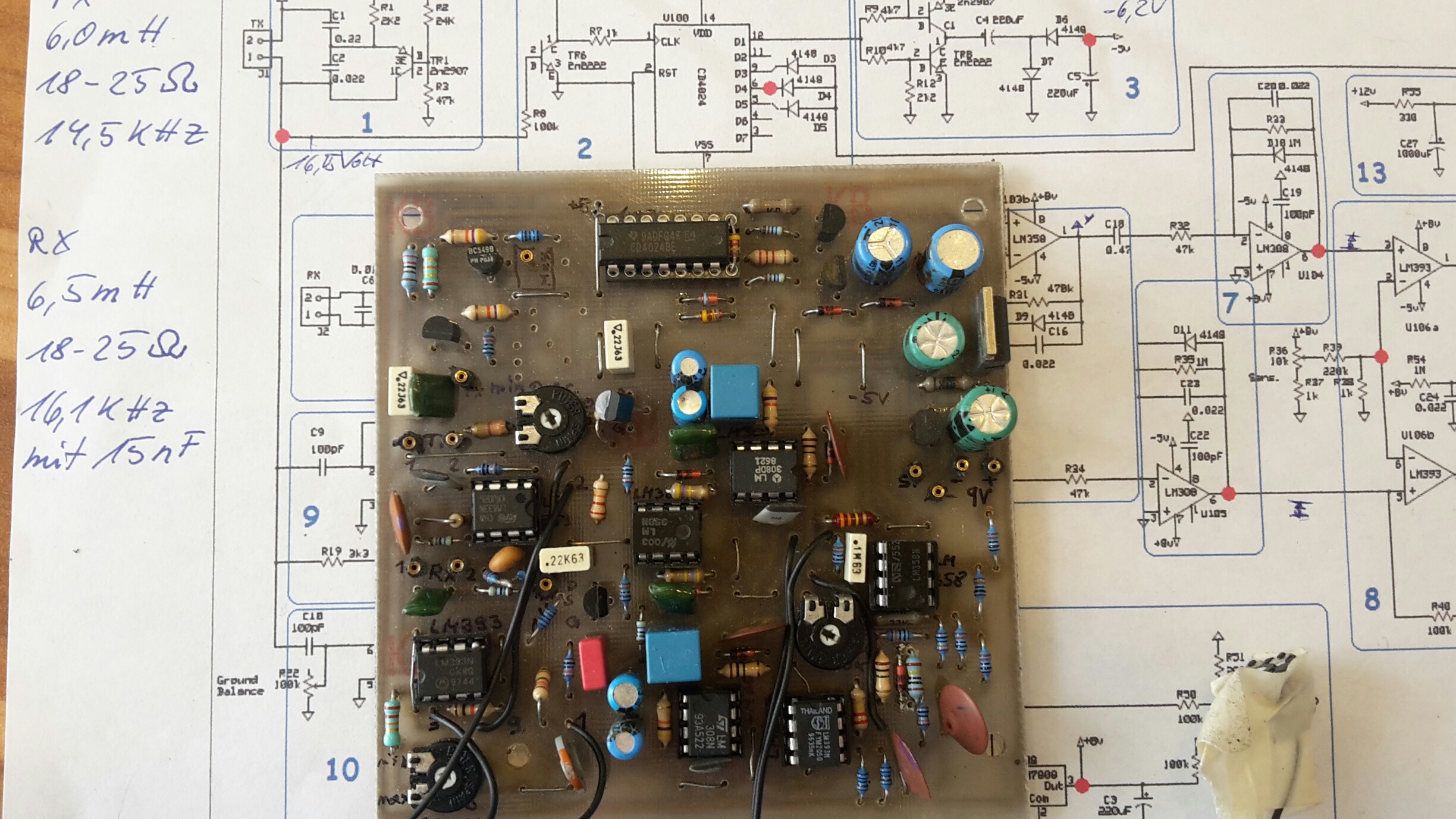

            Bobber, If not troublesome may i have pic of your pcb board and proper voltage reading, i think there is too high voltage about +0.3v somewhere on ic legs, i forgot to screenshot it.

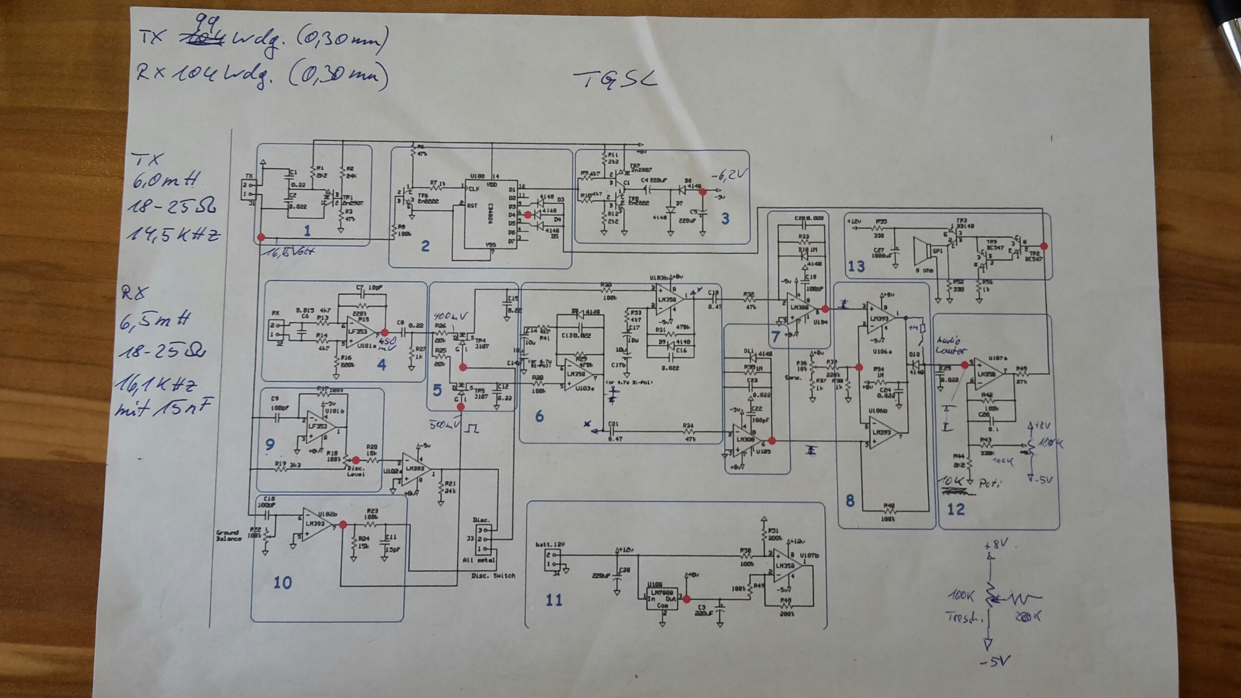

                    For the moment I can give you this. I hope this will help you. As you can see, I use the one resistor oscillator and a lot of bad components, but all is working well.
                    Also VDI from my IDX is working fine, but the holes are not yet drilled. As I said before 40 cm, of course in air, but I think in soil
                    this machine will be fine.

                      • I use 12 V not 9 V, as shown on my board.

                          • Originally posted by blobber View Post
                            [ATTACH]36856[/ATTACH][ATTACH]36857[/ATTACH]
                            Fred..
                            Is this note -5v important? I got -6.3v
                            And this

                              • Originally posted by ripsdevala View Post
                                Fred..
                                [ATTACH]36859[/ATTACH]
                                And this
                                [ATTACH]36861[/ATTACH]
                                -6,2 V I have, look at my shematic, this is what I have
