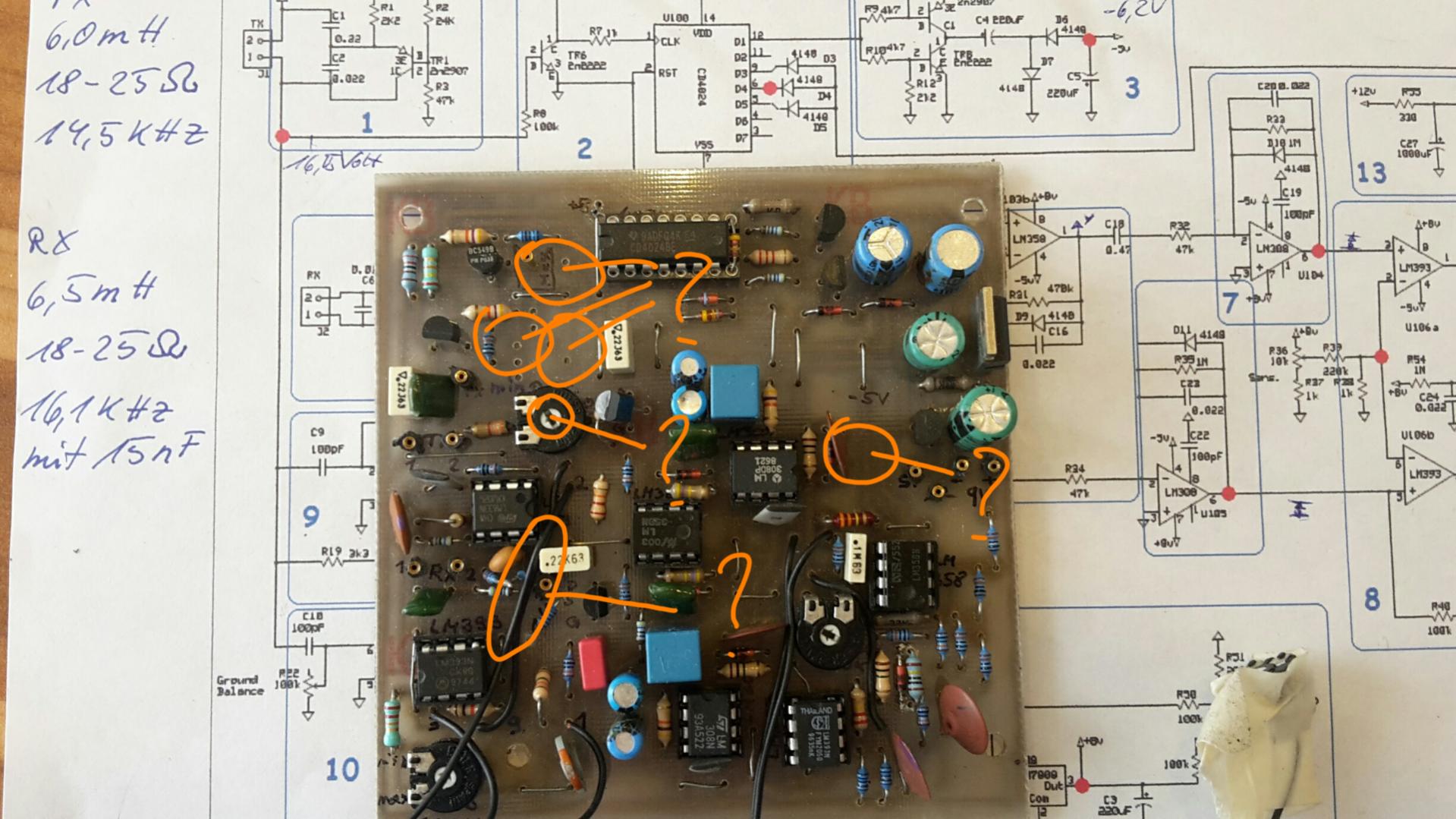

                • Can u please post your picture of finished pcb? I just wanna see transistor's orientation cause something confuse me.
                  • Lots of missing... or this not yet finish?

                    • Originally posted by CDI View Post
                      Hi CDI,
                      look at #100, the second file is my finished board, I use BF245, instead of J107, thats why they have changed orientation.
                      • Originally posted by blobber View Post
                        Hi CDI,
                        I know for BF245, in this case i mean on those unsoldered 2222 and 2907.
                        • I think you mean the oscillator circuit, but I use the osc. with only one transistor , as shown in Don's schematic, because it is good enough. When you reduce R1 2k2, you can get more p-p, but the wave form will be bad.
                          • But yes, I have not adapted my layout file..sorry

                              I have made the pcb in 2011, but I had one problem, with short distance, as I said before.
                              So the project was unfinished in my ,,unfinished projects box''.
                              Some weeks ago, after I finished my Krot2, I was able and happy to found my mistake. It was a missing resistor, 1k R27
                              and a bad choice of IC U106. I'm realy glad to found the fault, this days I build a compact box from ABS plastic sheet 1 mm.
