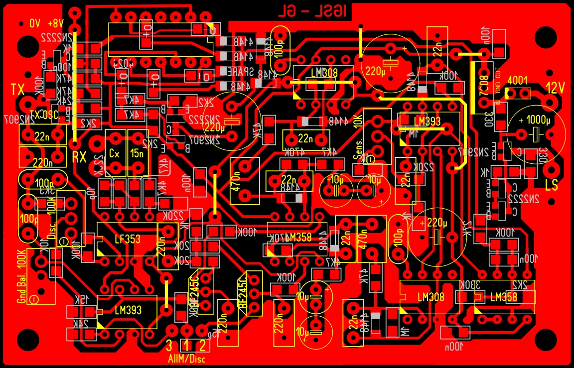

TGSL SMD
    Hello there...
    Board already fill up, with 4024 dip
    Why i not get ussual -6.2v? Only -0.6v
    8v normal
    4024 pin12= 5.5v
      Sorry , i cant help you. But i like this layout.
      How big is it and can you upload the .lay file?
        A little bit big for 4024 smd to dip
        tgsl_smd_V1 rrrrrr.lay6.zip
          Is this IGSL or TGSL? I need one from the IGSL smd.
            Tgsl, same thing with original v1
              Ok, did you use 1206 parts?
                The board using 1206, i use any smd size i find
                  You have to connect TX coil to get correct power supply voltages. Did you try it with Tx coil connected?
                    You're right DB! Now its working, Thanks
                    And i forgot the conection of 4024 gnd, you need to make a link to the nearest gnd supply.
                      Can someone make this layout a little bit smaller?
                      It needs to be 70mm wide or less. A little bit smaller would be better.
                      I have 70mm space in my enclosure.
                      smd_tgsl,obrada.rar

                            [QUOTE=BKY1337;238931]Can someone make this layout a little bit smaller?
                            Is this enough?
                            • #44
                              Thank You , im not sure with the left side , the smd capacitors because the pcb will be in a groove and my enclosure is an aluminium one. I fear that there will be a connection between the 12v rail and the capacitors.
                              I think its still a little bit too big , but thanks.
                              • #45
                                Look at this, it will fit
