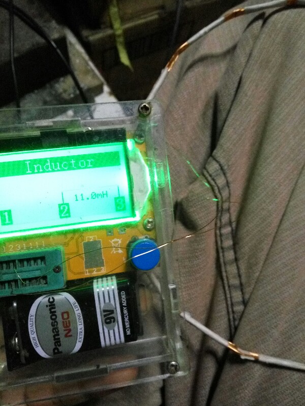

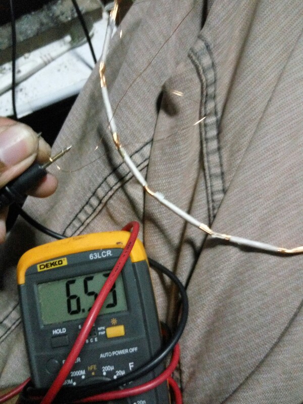

                • #53
                  I'm not sure with ny lcr...
                  What frequency should i get when i attach 3mH inductor to Tx J1, just for test.
                  • #54
                    [ATTACH]41886[/ATTACH]
                    [ATTACH]41887[/ATTACH]
                    Can you measure residual voltage + phase shift after first op amp Rx?
                    For 220n 22n and 3mH it should be 20,539 kHz

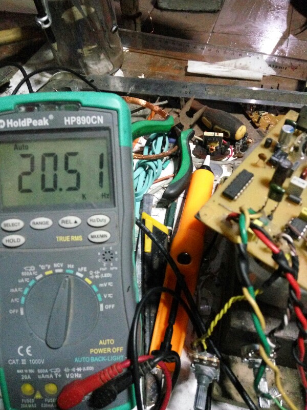

                    • #55
                      Ok, let me check, i only have this freq dmm and hantek scope
                      • #56
                        With 3mH inductor 20.51khz, i think the board is ok.
                        My lcr is crazy, thanks for the support, i need to reduce my coil winding to the required freq
                        • #57
                          My LCR is also big liar when it comes to inductance. I ordered DMM, which can measure inductance well and I was surprised by LCR error size It was in some cases up to 20%.
                          OK, and measure residual voltage after your correction!

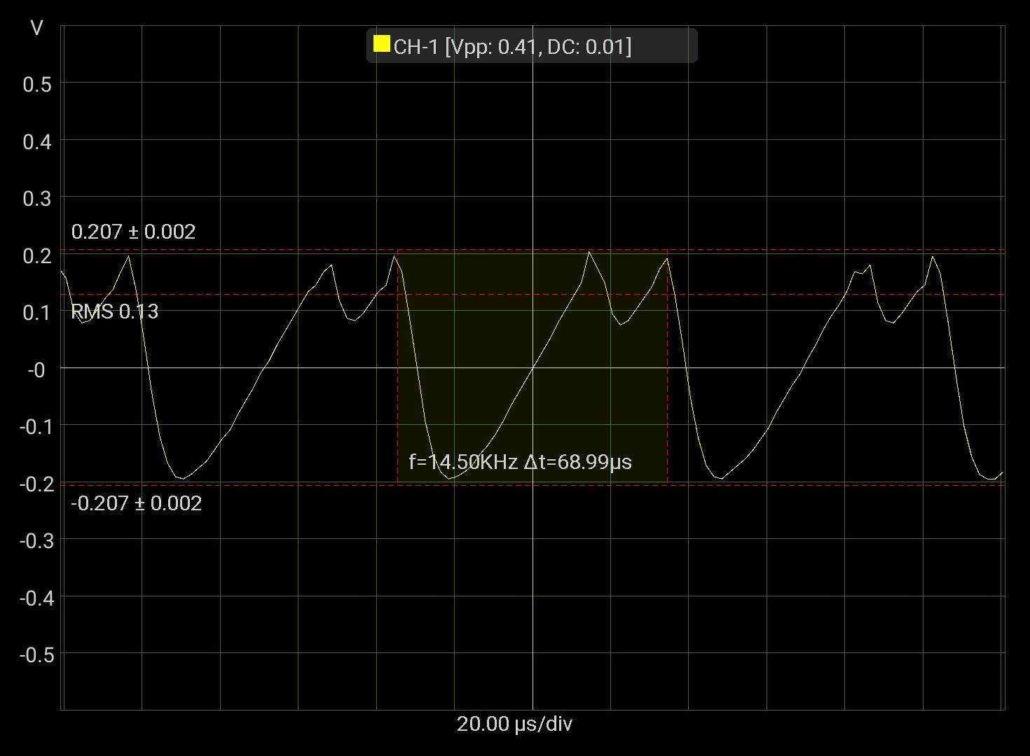

                          • #58
                            Has somebody a partslist for the v1 layout?
                            Because im ordering parts.
                            • #59
                              All freq is correct, pin7 opamp 0.4v, air test only 16cm at max sens
                              Using Ne5532 as lf353 and 2N5485 for bf245
                              Let me try another ic and transistor
