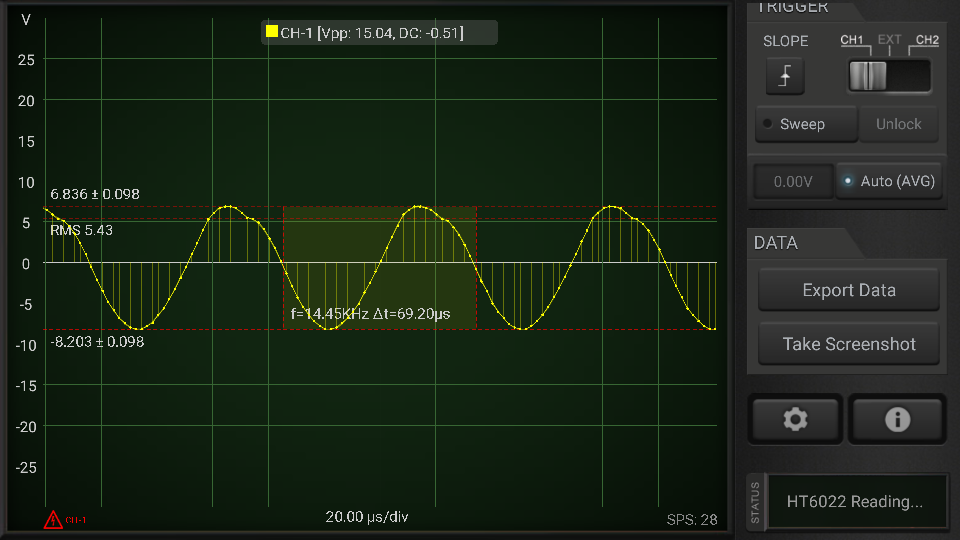

    All freq is correct, pin7 opamp 0.4v, air test only 16cm at max sens
    [ATTACH]41893[/ATTACH]
    Using Ne5532 as lf353 and 2N5485 for bf245
    Let me try another ic and transistor
    That shape is very strange, can you shot Tx?

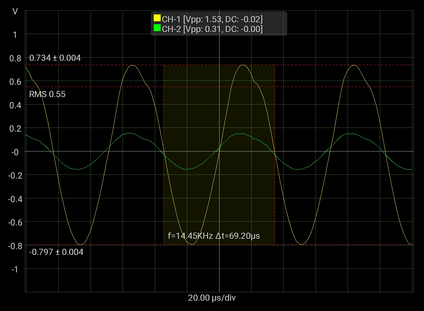

      Please check... Tx yellow, Rx green

      • #63
        waves look good, phase looks off, coil nulling maybe could be better, tx amplitude should be in 16v range
        • #64
          ground balance

            Tx amplitude16v? do you mean the voltage of tx? Its 0.02v
            I need to learn oscilloscope more

            GB is ok, pot at the middle slighty right.
            Nulling, i find the lowest voltage from preamp pin7, is there another way better?
            • #66
              [ATTACH]41895[/ATTACH]
              I bet your problem is in coil as always Vpp on Tx is 15V and it is correct. But the phase shift is really strange. I made only 2 concentrics in the past, but always had 200° phase shift. You have something like 345-350°. Do you get double tone when target is present? Did you try swap Rx cables?
                      No double tone, swap rx make double tone.
                      what voltage are you getting. Anything under 200mv should be good. If the phase is too far out it will affect depth on certain metals. Have you tried lead aluminium silver gold and so on. Are they all bad.?
                      Yes its under 200mv but its to easy, something not right, and i dont get chater noise at all like the ussual, and you right aluminum is not detected in all metal mode...
