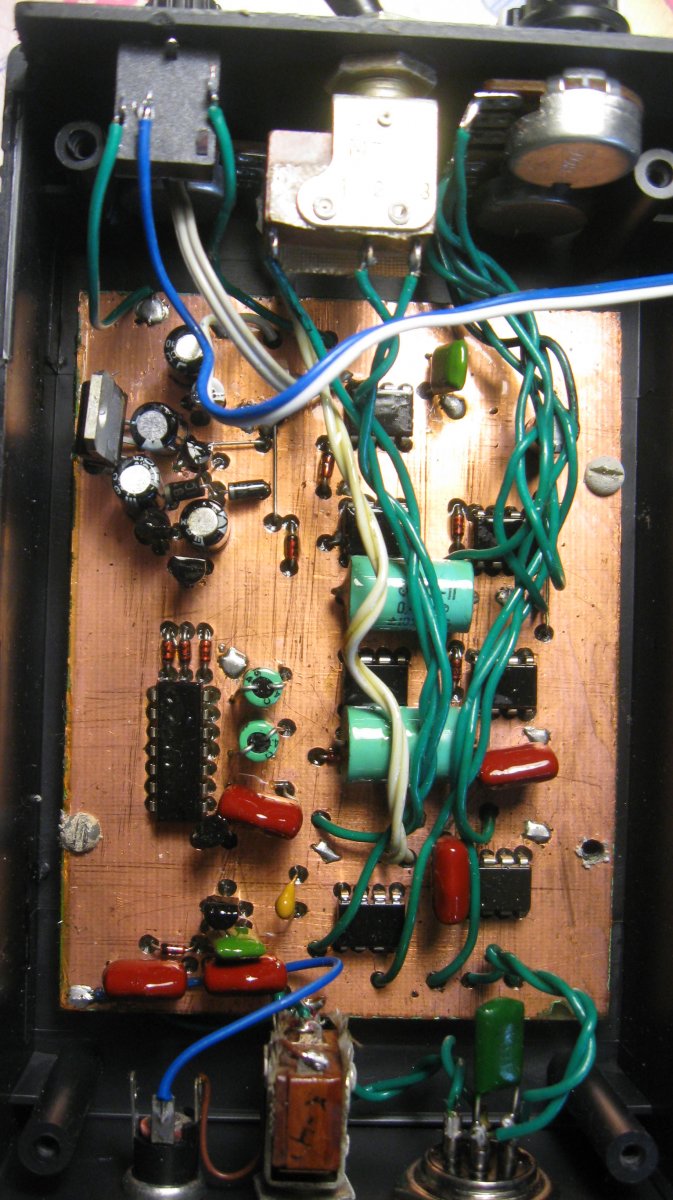

TGSL v3 100mm x 100mm reduced
    Were the prototypes from this schematic? Or do you mean your SMD TGSLs?
    I want to order PCBs from mine when its done. 100 x 70mm is a perfect size.
    I cannot etch a prototype because i will make a few parts of it in double layer.

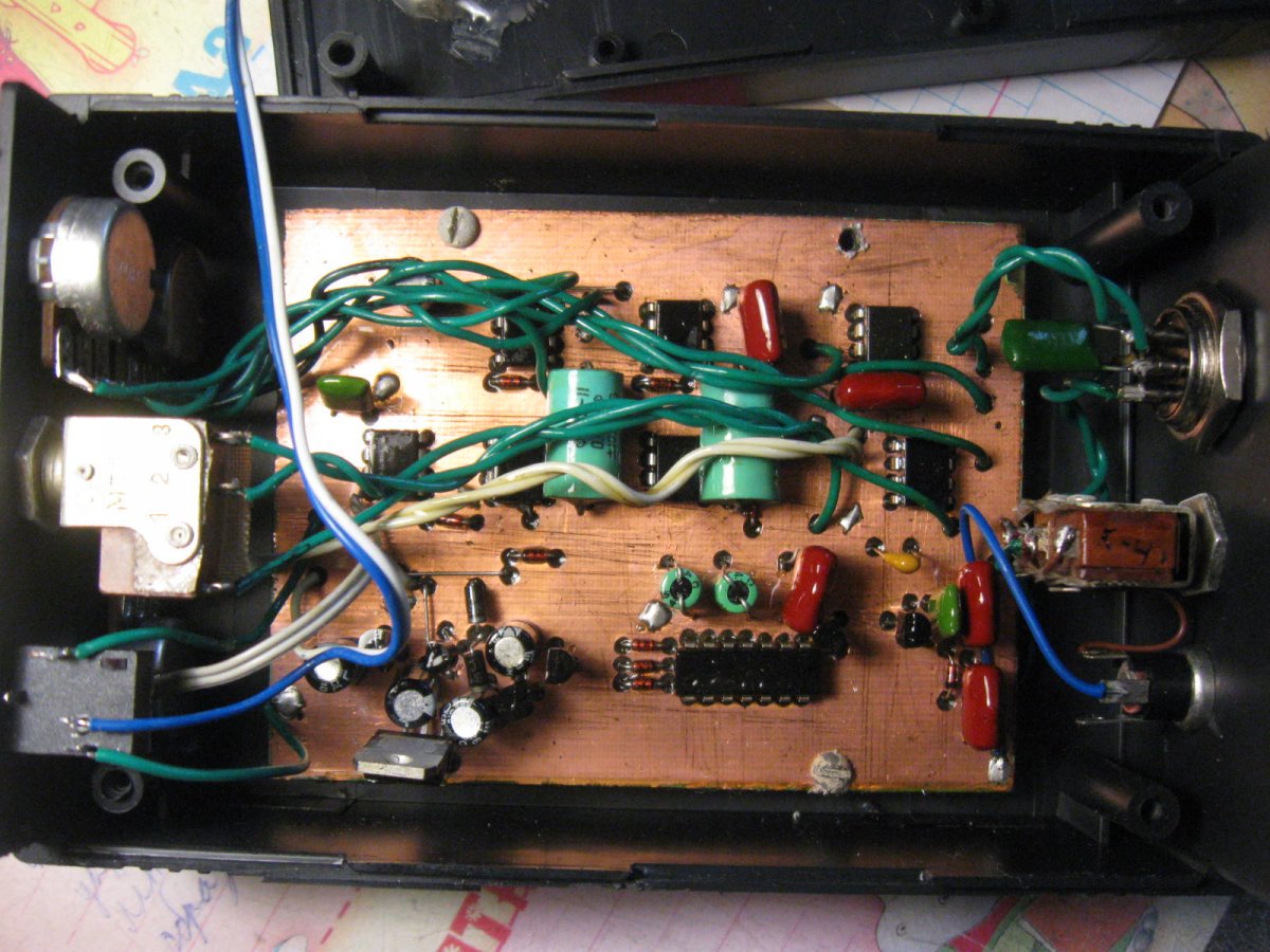

      I have made several TGLS's Ivconics version with some little changes, but they don't work so well. The goal is to experiment, that is the most interesting thing. Some of them work well some of them not, but each of them is another step forward!
        Is ivconics version the 1260? I have already had a silverdog version which worked excellent until i got a short connection. Maybe you should try this one.
        I have thought they are all okay. And i hope my Russian SMD version is ok too.
          Ivconics version is the best. Edu version is almost useless on ground it gives so many falses, you cant use it at maximum sensibility.

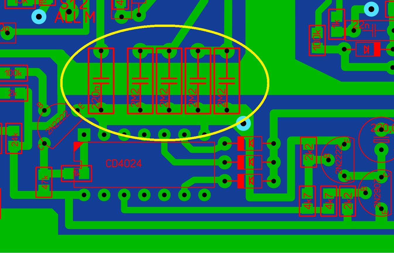

              but i still does not have the lay file. its combined DIP and SMD board.
                Can someone help me, i have a problem with my .lay file.
                I dont know why this blue layer (top copper) is the whole board. I cannot see the blue bridges.
                Has someone this layout file without this blue area or can explain why everything is blue?
                TGSL SMD Russian.rar
                I have spent quite a time to change the resistors and mirror everything and now i saw that there must be more bridges than the red ones.
                  Okay, now i realized that the blue area is GND and the through holes too.
                  I need to replace it with tracks.

                                Do you know what they mean with 2M2 capacitors in my layout where the 4024 is?
                                Could this be a Resistor? Im not sure with the two 470n capacitors too , i dont know which type.
