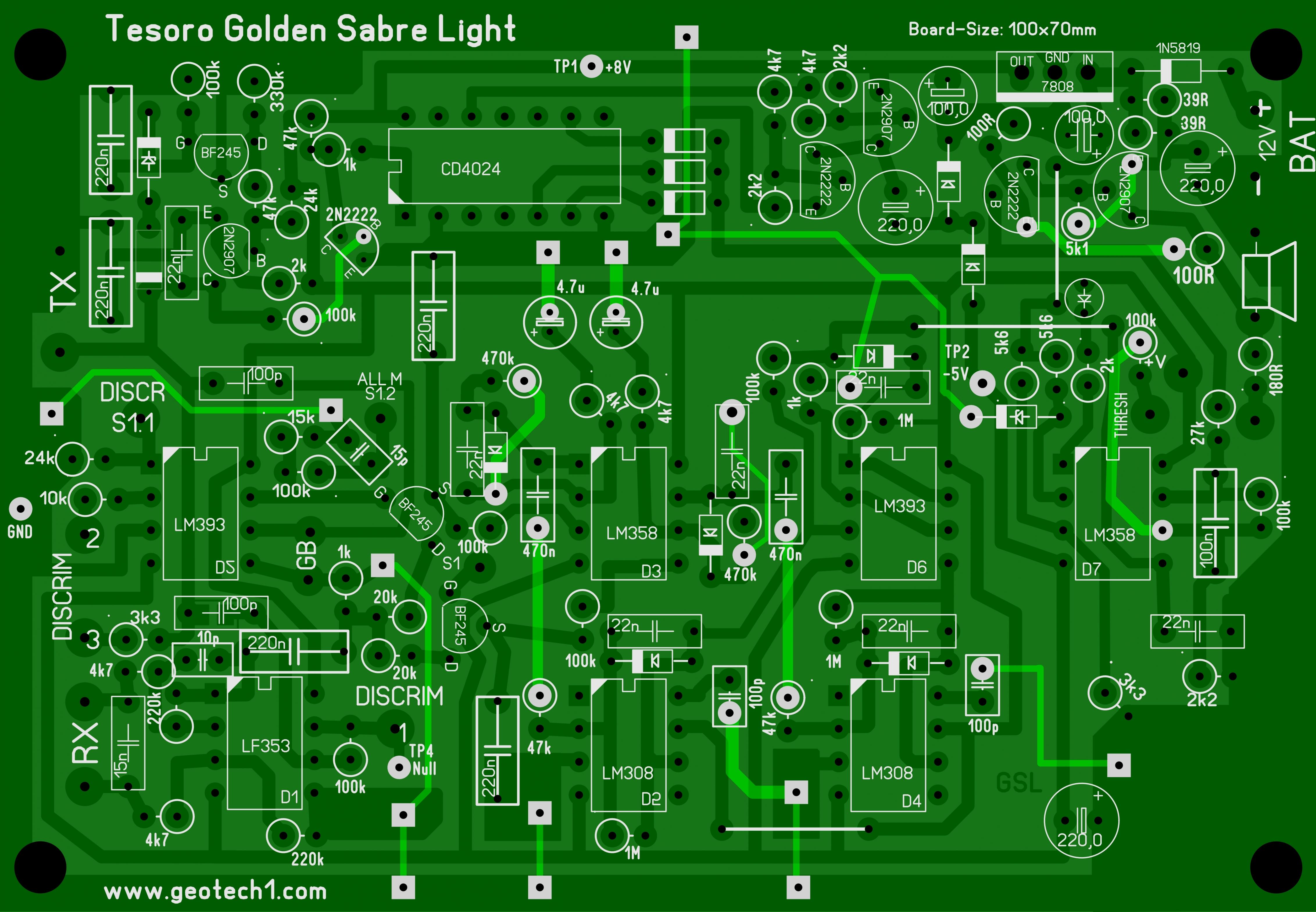

              I need your help again! I saw that this guy used electrolytic capacitors for the 470n.
              Is this a soviet type too? I guess not.
              Should i use elctrolytic capacitors for this or is this a polyester capacitor?

              I hope the space between the parts is enough.

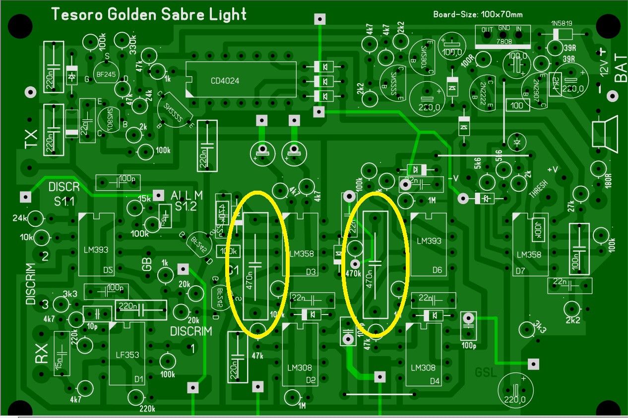

                mkp, mks or fkp type
                RM 15mm ?
                  Yes lead spacing is 15mm in the layout. Maybe axial.
                  Ok then i will make the spacing smaller and i gonna use normal poly caps.

                    The silk on that PCB does NOT indicate Electrolytic caps which would have polarity marked.
                    The older High Quality poly caps were axial and pretty large which is what was probably used.
                    Like this one:
                    http://www.illinoiscapacitor.com/ic_...rtnumber=10112

                      Make the board double-sided. For example, here's how:
                      • #41
                        Use this mounting Size and Take the highest voltage Rating and lowest tolerante. For example 400v 1%
                        • #42
                          It was double sided before and smd. I want to make it as small as possible to save space.
                          400v capacitor is possible when i mount it at the bottom side , but it will increase the height.
                          Im almost done, i only need to mirror the transistors which is very tricky.

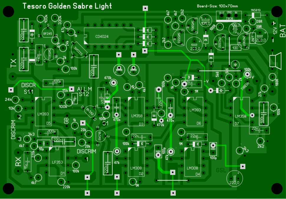

                          I replaced the capacitors with 470n,100V, lead spacing 5mm

                            While your layout may look good all shrunk, I would suggest you print it then place real components through paper holes and test if they fit.
                            As an example the IC footprint may look ok, but will a socket fit and let other components fit beside it ?
                            • #44
                              Yes , i will make it like that. I still need to make the space around the ICs bigger. Unfortunately i dont have the footprint for a socket in sprintlayout.
                              Mirroring the transistors is easy because the 2N2222 and the 2N2907 have their pins in a row.
                              Im not sure about the two 4,7uF electrolytic capacitors and their direction at the 4024.
                              One side is at GND but is this a negative voltage?

                                I think im ready. I still need the orientation of the 4,7u electrolytic capacitors.
                                One capictor is smd. I need the value of it.
                                I will maybe make more space where the lf353 is. I tried sockets, they should fit.
