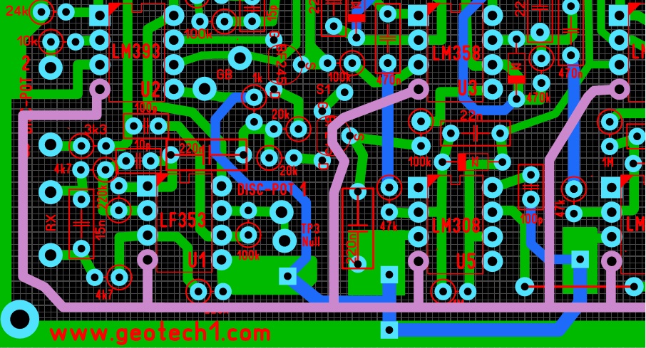

    Hi, for the pot connections you have to see the schematic, it also had been written down many times.
    Continuous voltage is because there is not enough minus voltage.
    • #62
      I think the connections are okay , because i checked the schematic.
      I asked because this is an other version of the tgsl. It uses 100k Potentiometer and i wasnt sure about the connections.
      If a transistor is faulty then i dont know why i had -7.3V without ICs.
      I saw that the tone changed when i swapped a coin over the coils (not yet nulled). I hope its only a transtistor.
      I think i could be possible too that a positive Voltage neutralizes the negative voltage to about 0.6V.
      • #63
        I removed all ics again and had -6,9v , then I saw that it's only -0.7v with LM833 and -0.9v with LF353 instead. I think the Problem must be there.
        Its the Ic at the lower left corner.

          I have negative voltage and steady Tone with LM358 (Audio). I have only one coil (tx) connected.
          When I insert the second ic from the left I have only -2v.
          I forgot that i wasnt sure about the orientation of the Diode at Pin2 LM358 . Battery Check.
          Its connected in the other direction in my schematic. Can this cause the steady tone?
          I think i used a 4V3 Zener.
          • #65
            Same Problem with Diode in other Direction. :-(
            • #66
              Output of LM358 is steady 6.7 V, no other ICs at the board only 4024 and LM358. Pin 5 is about 300mV and Pin 6 is -150mV.
              What is normal? A few mV?
              • #67
                My TGSL consumes 26.5mA steady and 29mA with detection. Are you sure thath the PCB is correct?
                • #68
                  This wasn't my question. I mean the voltage at the last op Amp. I know that something must be wrong. Im not sure with this Layout but I have checked the schematic and the only difference was the wrong orientated Diode. I need to find out from where the high Input for the LM358 comes. But I need to know first what is the normal Input without tone. I think 300mV is too high. I have negative voltage at the other Input, is this normal or do I need 0V there.
                  It could be possible that I accidently connected two points together while soldering. Some holes are really small.
                  • #69
                    Do you have that scope you tolt you told us will buy?
                    • #70
                      I have a DSO 150 yes. But i cannot adjust the thing at the right side of the screen. But it works.
                      But for what? I don't have OPamps at the board. Only Audio. Tx is oscillating.

                        • #72
                          You write above that you use LM833. Which place in the scheme do you use it?
                          • #73
                            LM833 was int the lower left corner instead of the lf353. But it's not at the board at the Moment.
                            Thanks for the tester but I think my OPamps are okay. I think the input is the Problem. I tried to measure the output at my working edu Version and I had -6 V where I have +7 Volts with this board. Output of LM358.
                            I repeat that I have only 4024 and LM358 mounted and all parts are new.
