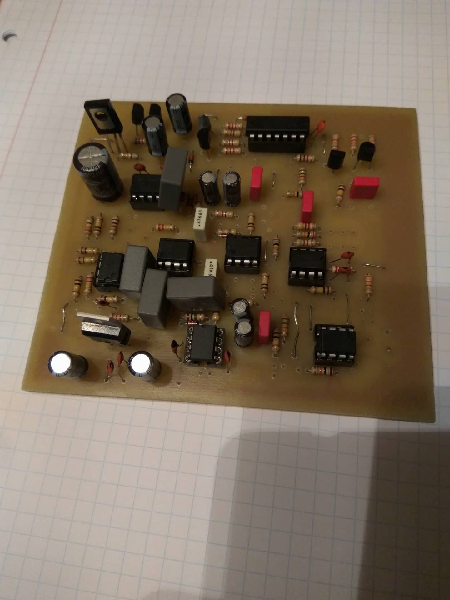

    Hi all, im building this metal detector because i found a lot of information about it (components used OC placement and so on), but i have no formation in electronics. I study geology in Portugal so im facing some "small" problems with this project, so i started this topic so to be able to share my questions and maybe get some answers. So my questions are:

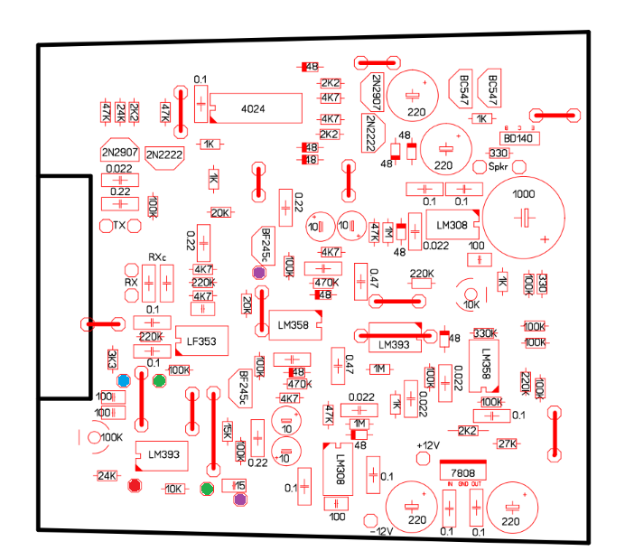

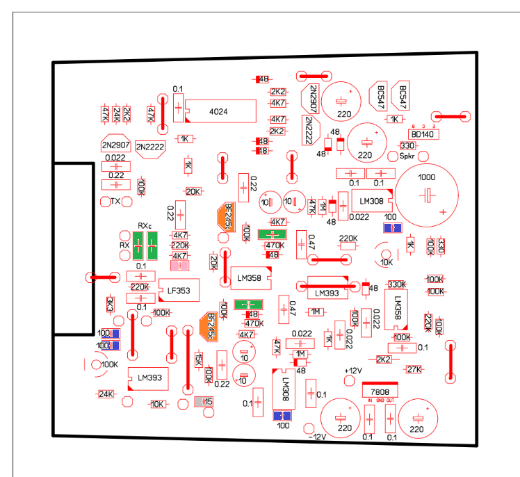

    1- I got a bit confused by the Farad units by looking at others TGSL and comparing with the components pdf (see attachment)
    1_a- Im 99% sure that the value of the blue caps is 100 pF am i right? The same goes for the green ones, 0.022 uF caps?
    1_b- The pink one is either 15 pF or 0.015 uF and the grey one is the other one.
    1_c- Could i use the BF245A instead of the BF245C? I tried to read the datasheet but i can't understand if i could replace the BF245C but i saw somewhere that would be ok, also the J111 is a possible substitute?
    That's it for now, i have a couple more questions, but will leave them for later. "Det.jpg" is what i have done so far.

    Pink .1uf
    Blue 100p
    Green .22uF
    Yes on the BF245A

          kt315, there is a store called mauser (https://mauser.pt/) that sells that J111 and since is near my college (FCUL, Lisbon) i usually buy them some pieces (the ones i don't buy from China).homefire, if the pink is .1uF why is not the same size has the 0.1nF (just want to understand why)so im still left with a 15pF and a 0.015nF acording to the partslist, idea where they go?

            That's a mirrored PCB, it wont work!

                Nándor, thank you for remind me of that Yes i've inverted the circuit and i noticed that when i started to drilling the holes so i inverted all pieces in order to fix that, hope i can continue.

                I still don't understand why the .1uF in that help diagram is so little compared to the others 0.1uF caps. Plus, where im going to put the 15pF cap that is listed in the BOM.pdf (components list). If anyone knows please tell me
                Thank you all.
                  1 C11 478-4845-ND CAP CER 15PF 100V 5% NP0 C 11

                      homefire, you were 100000% right.. but you might know, im still really fresh in this scene to not notice that 15 pF is the same as 0.015nF.

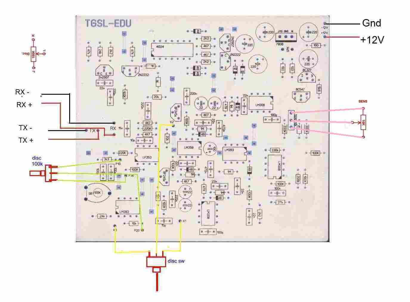

                      I've soldered everything (without the coils + power supply) and i noticed some holes without informations (see attachment), the ones who have the same color i guess are from the same component the other ones i have no idea. Can anyone tell me what components are missing (in those holes) and the values of the pot's.

                        Not the same version but it should still be the same pinout I would think. one is a On Off On toggle switch the other is a 100K pot for the Discrimination

                            Yeah... My bad... Tibuck, that seems correct, can anyone verify it please?
