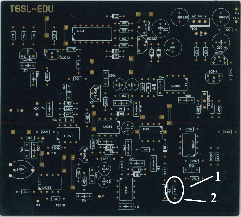

                Can we add a threshold pot to the TGSL ??
                  Sure, my favorite trick - steal it from similar detector, where it already exist in this case IGSL. In TGSL complete schematics it is Resistor R44 2k2 (near U107a - LM358, from pin 6 to GND ). Take it out and place there 10k Potentiometer...
                    Great! thank you . see photo, Does 1 Or 2 go to wiper ?
                      The TGSL doesn't have a pinpoint , how do we set the threshold with the pot?

                        You need to add for example this:
                        and some audio signal or VCO on bottom of image to get pinpoint on TGSL.
                        Threshold we discussed before is for classic disc channel. On one side you get smooth beeps and more "nuance" of sounds. On other side beeps are binary - more sensitive, but not informative. Hard to describe.
