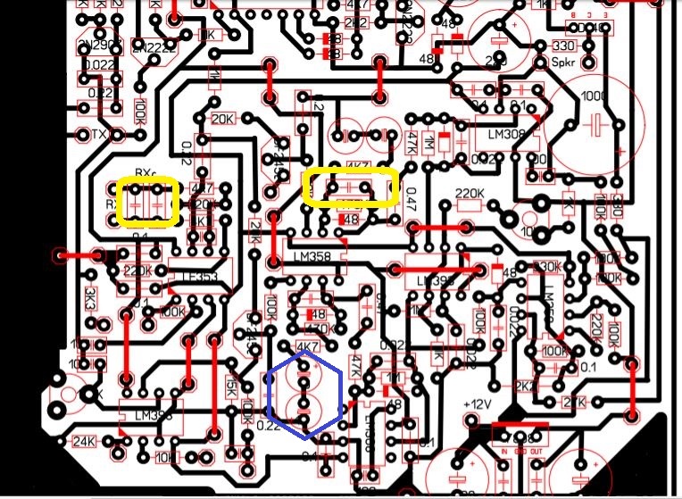

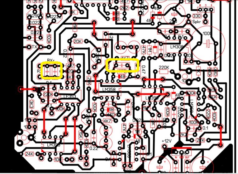

    Whats the value of highlighted capacitor in centre of the picture. Its from sticky post TGSL - complete details - version 3.0

ID:	351582 Also the value of these two capacitor highlighted in Blue is written as 10 but the BOM only has one 10pf capacitor and even then how am i going to find polarity of it
        kt315 thank you for your attention. Please specify the value of the capacitor highlighted in yellow sandwiched between 4k7 and 470k resistors. Is this 15nf or 22nf ??
        15nF. 22nF.

          [ATTACH]43441[/ATTACH] Also the value of these two capacitor highlighted in Blue is written as 10 but the BOM only has one 10pf capacitor and even then how am i going to find polarity of it
          In the original schematic, it is non-polarized capacitor. Since these types of capacitors are more difficult to find laying around, you can substitute by placing two polarized electrolytic caps in series with the two negative terminals connected, as shown on layout. Just remember that the same value can be obtained by using two same value caps divided by two. So two 10uf caps connected this way would be equal to 5uF
            15nF on input of RX preamp. 22nF in feedback. look on the schematic.
              So I should take two polarized 10uf capacitors and join their negative terminals with each other and this will do the job Right ?? I have two 10uf 25V polarized capacitors

                  How to meet this requirement. Next i can see two 220nf polarized caps and I only got these in ceramic with capacitance code as 224

                    Have a look at the schematic. It has two 10uF electrolytic caps connected with the negative terminals back to back, giving the required 4.7uF n.p(non polarized)
