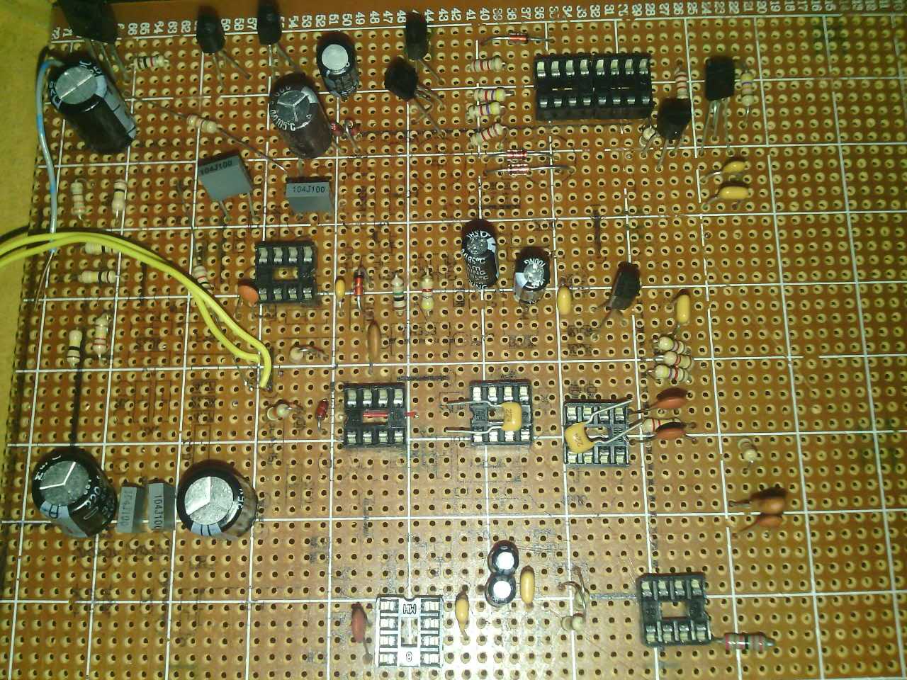

    Here is what i built till now of TGSL. This is the 2nd time i am building this as my first attempt was a disaster. Now i realize that the two 220 caps are polarized as used on top middle of the board. I hope this is correct
      In the original schematic, it is non-polarized capacitor. Since these types of capacitors are more difficult to find laying around, you can substitute by placing two polarized electrolytic caps in series with the two negative terminals connected, as shown on layout. Just remember that the same value can be obtained by using two same value caps divided by two. So two 10uf caps connected this way would be equal to 5uF

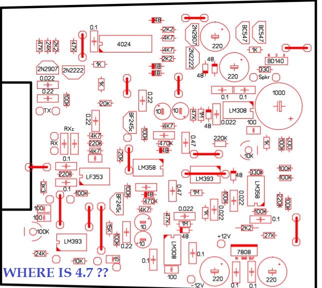

            You recommend buying 4.7uf capacitor but i can't see where it is used in TGSL circuit board

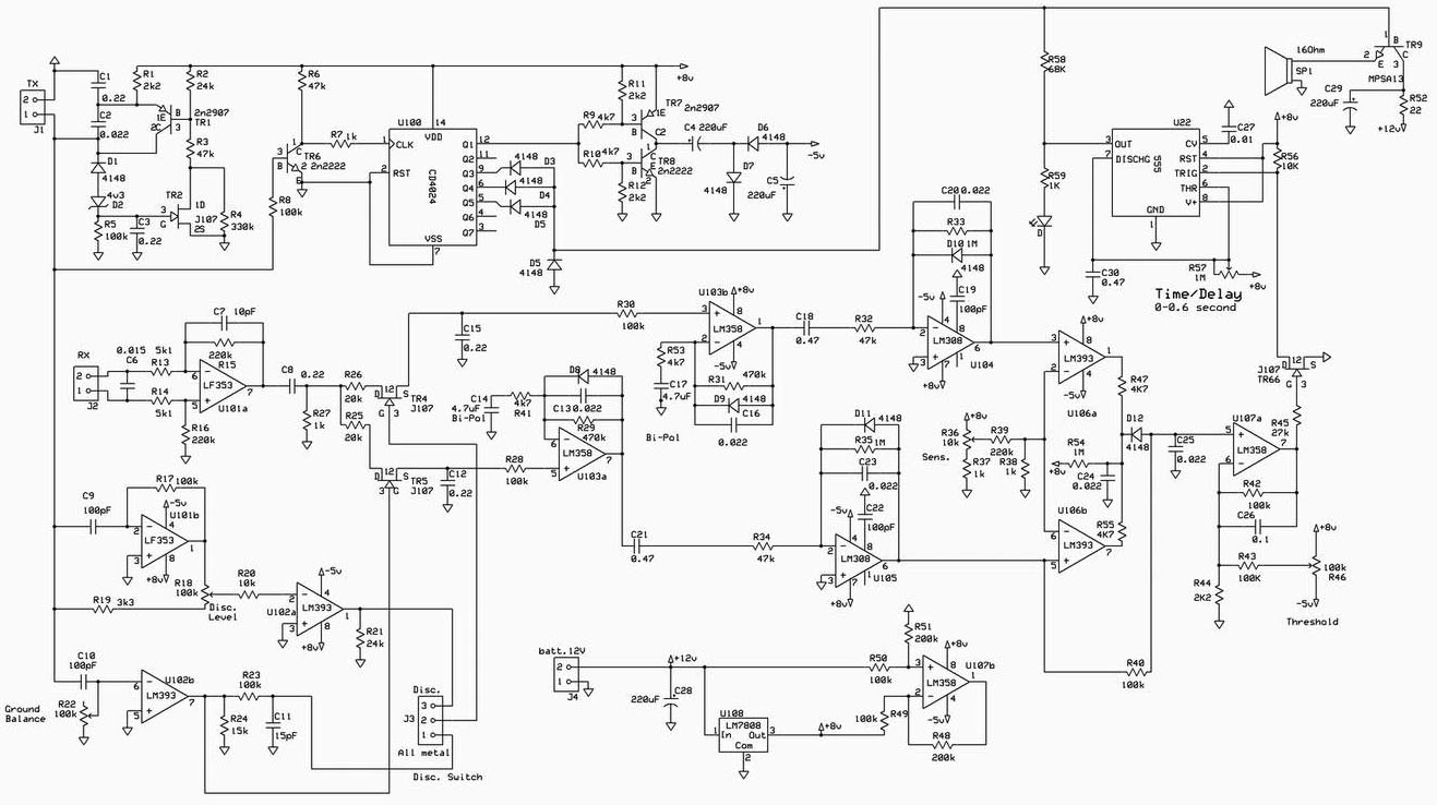

            do you need schematic?? c14 c17
              If i could read schematics then why i asked questions from you. Please highlight location of 4.7 in this picture of Part placement. Click image for larger version
Name:	WHERE GOES 4.7.JPG
                somebody (ivgonik??) changed ONE nonpolar cap on TWO polar caps. idiotic decision. nonpolar caps are not expensive and too accessable.
                  I HAVE 4.7uf CAPACITORS SAME AS EBAY BUT MY CAPACITOR IS 50 VOLTS. IS IT OK TO USE
                    GOD HELP THIS MEN TO DO DETECTOR
                    yes. 50V is ok.
