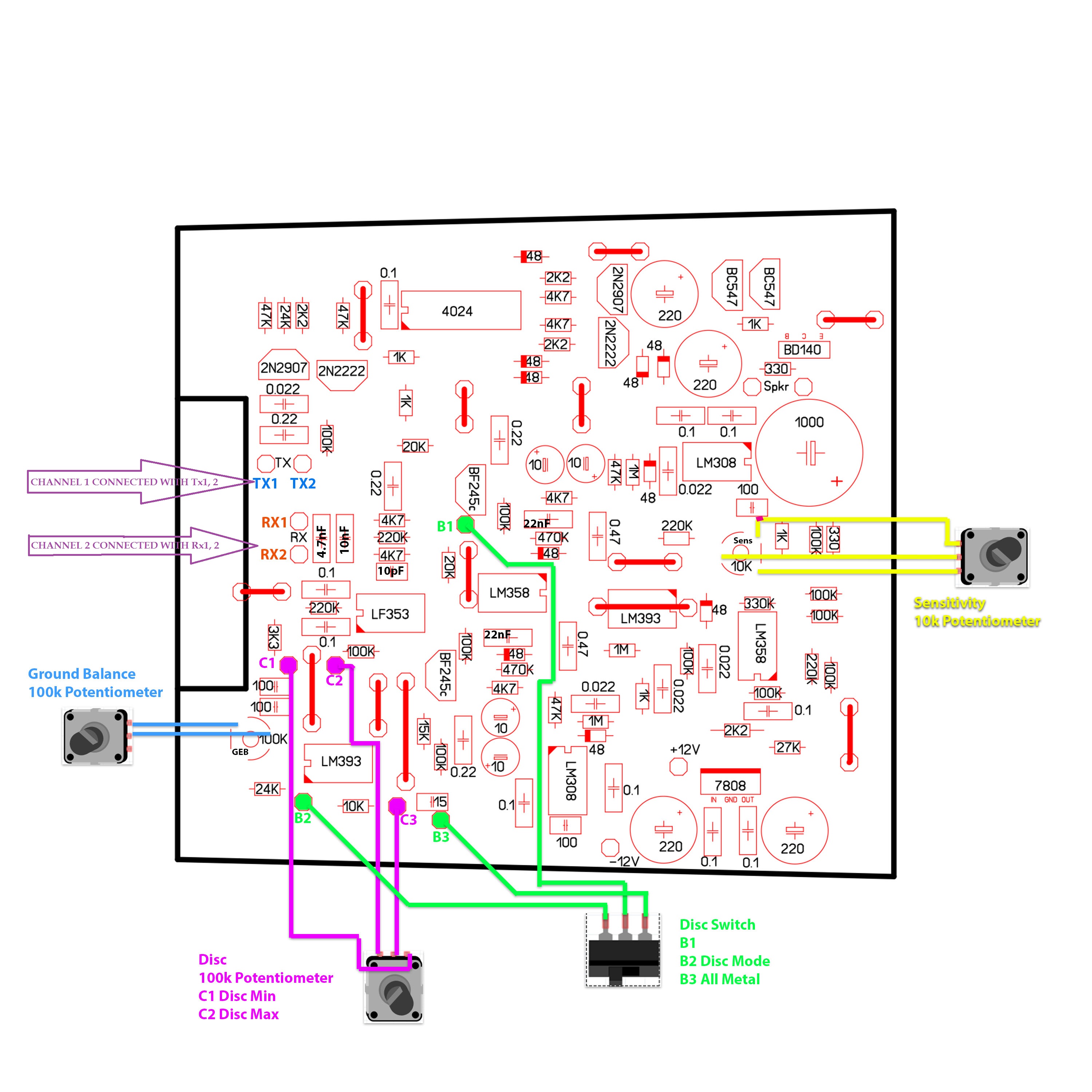

              Today I installed both BF245C. Installed all POTS and buttons but no coil yet. No component are heating. No song or tone whatsoever. Multimeter show 5.5V AC/ 2.5V DC at Tx terminals. Whats wrong? Am i in the wrong continent?
                With no tx coil, the oscillator will not run. With no rx coil, the rx circuits have no signal to work with, and the detector will appear dead. Do you have any test equipment? An oscilloscope is needed to make any real progress in this hobby, and with no real electronics knowledge it may be nearly impossible. Every hobby has an entry requirement.

                  I have a 20MHz analog oscilloscope. How i use at this stage

                    Build the TX and RX coils according to the TGSL_101_Part1 that's in the first post. Then hook them up to your TGSL board and test them.

                        Thank you yatahaze323 and Tibuck19 for very interesting information. I attached the circuit with my oscilloscope and both Tx and Rx terminals produced wave form. I will post the pictures soon for experts like you to see as to whats going on. Time/Div knob was set at 5mS and both Volts/Div knobs were set at 0.2V AC
                          Here is what my Oscilloscope described about Rx (top) and Tx (Down)

                            The scope indicates about 91 Hz. That makes no sense. Are you sure the variable adjustment on the time/division control is in the "set" position? (click stop) Where exactly on the schematic are your probes connected?
                              I AM USING ANALOG OSCILOSCOPE. WHAT I MEANTT WAS THAT THE TIME/ DIV KNOB WAS AT 5mS MARK. SEE PICTURE TO FIND THE POINTS WHERE I HAVE CONNECTED CHANNEL 1 AND CHANNEL 2 PROBES.
Name:	Placement Of pots and switches.jpg
