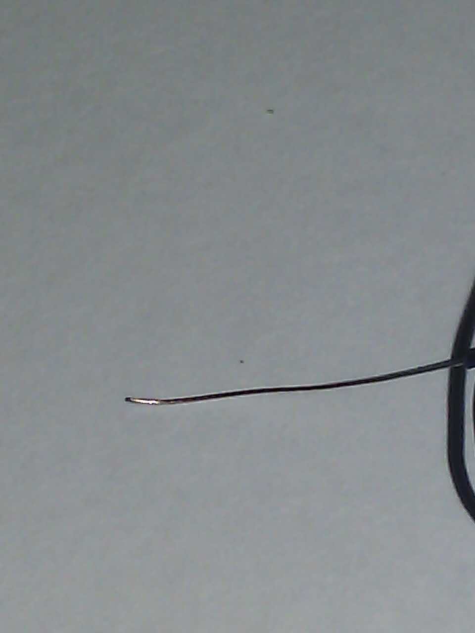

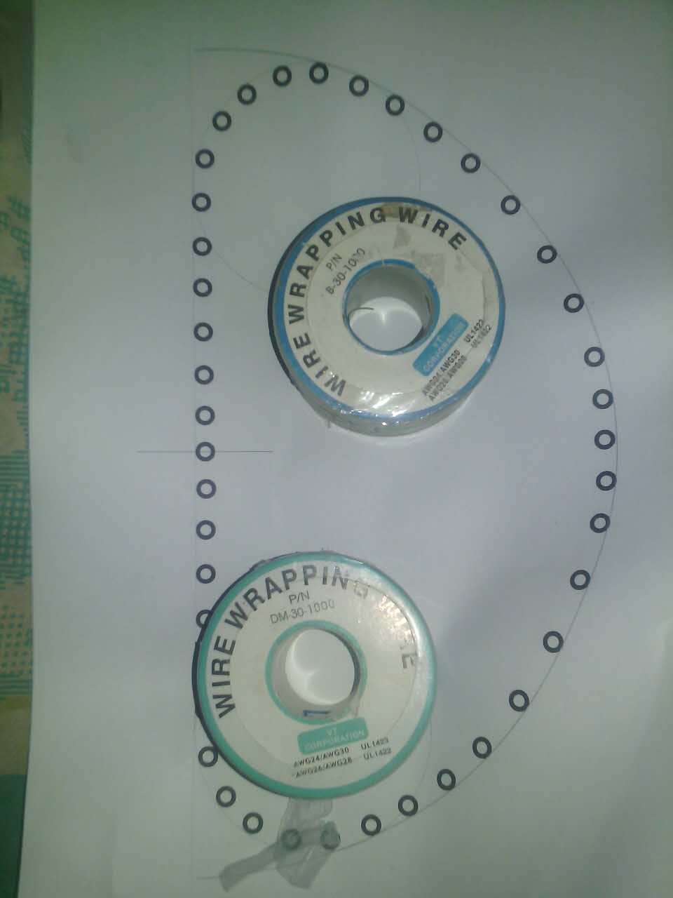

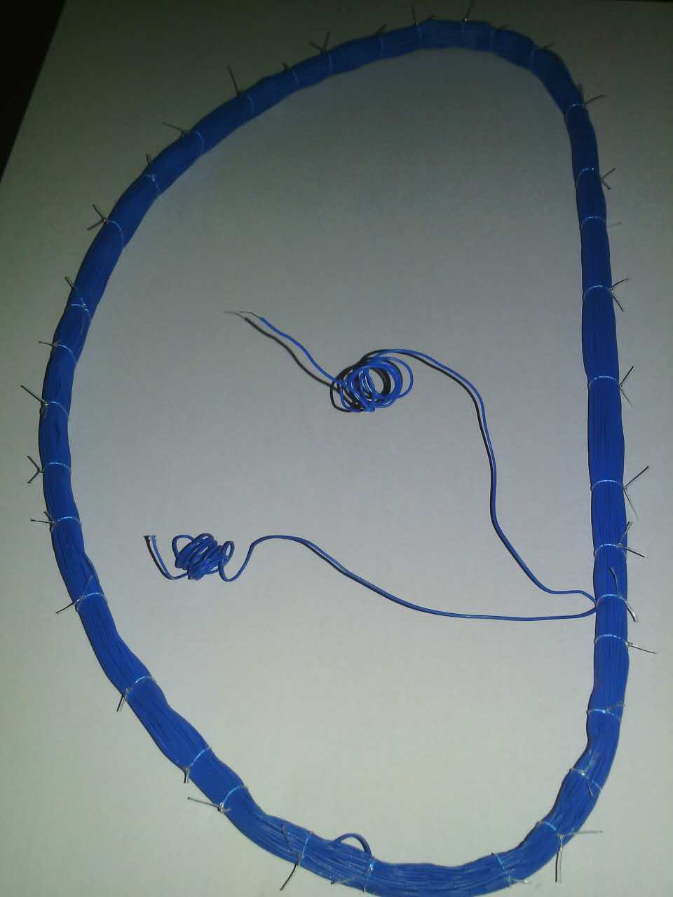

DD coils size 255mm x 137mm, wire is plastic coated wire 0.45mm; inner is tin plated copper wire 0.25mm. Tx 101 turns, Rx 107 turns. It is beeping nice to power connection disconnection. The problems are;
Low distance coverage as it does not detect coins even if placed on coils. Detects 4"x4" copperclad board at 3.5" distance.
Discrimination not working.
GB and DISC pots show changes in scope waves on very ends of their turning.
DISC switch does not seem to be effecting anything but moving the switch produces beep.
In short it is not performing as desired. First it should be sensitive enough to detect coins placed on coil surface.
