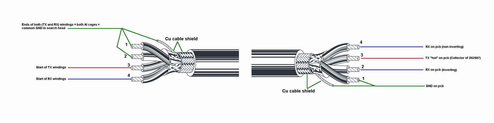

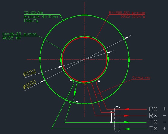

        I would suggest you to make another coil, this time TX~5.7mH and RX~6.2mH, both with 0.25mm.

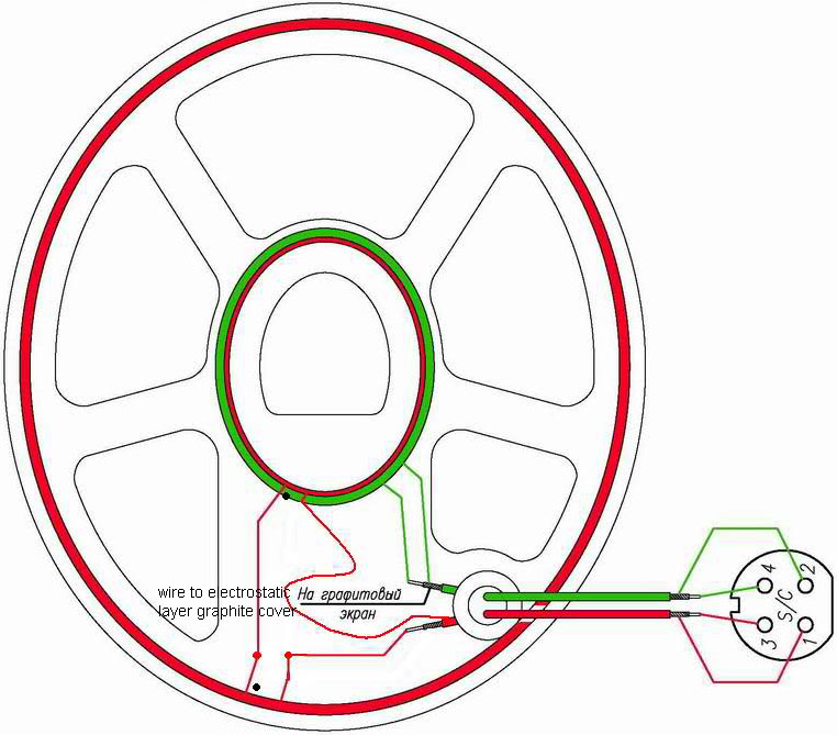

        Also look at this sketch; that's the way how i wired my coils, all of them:
          RX lead that goes to inverting input of LF353; goes to common GND, but down there in coil only, not up there in detector's housing and on pcb.

                  i see you are not able understand my answers to you. read this
                    Here's Ivconics' original coil making document.

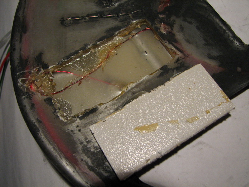

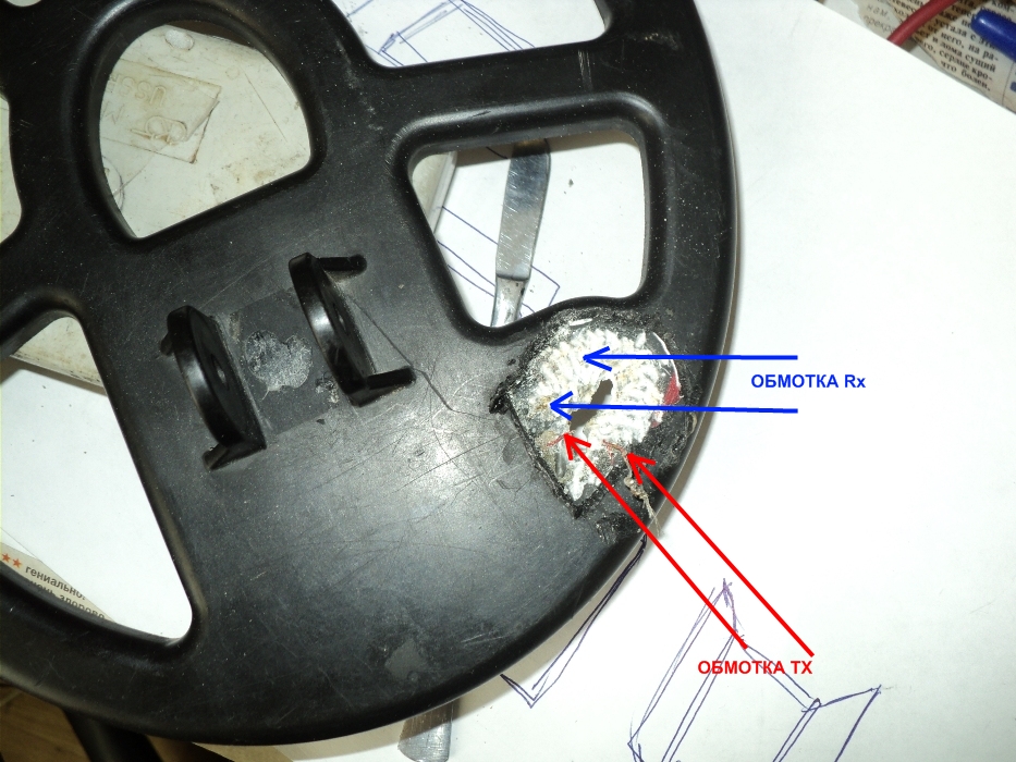

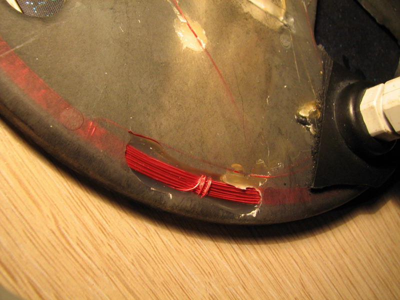

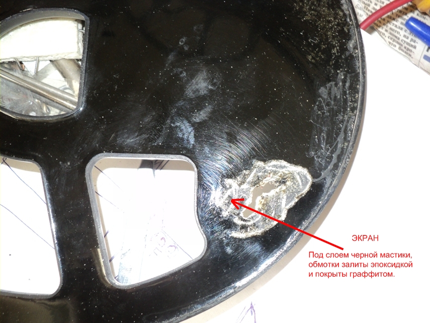

                        if you use a foil for shielding of coil nobody is able to help you to balance the coil.
                        we must see pics of your coil. not naked text from you.
