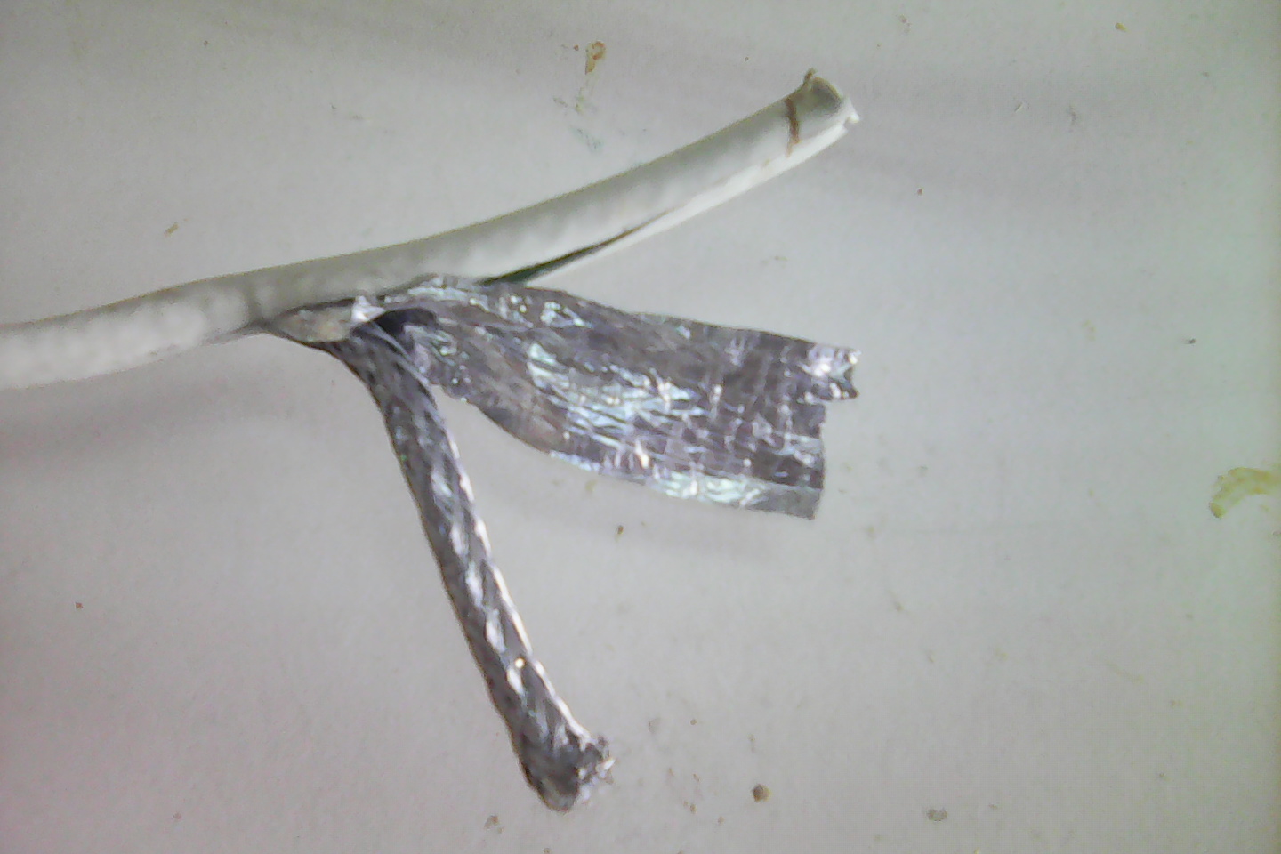

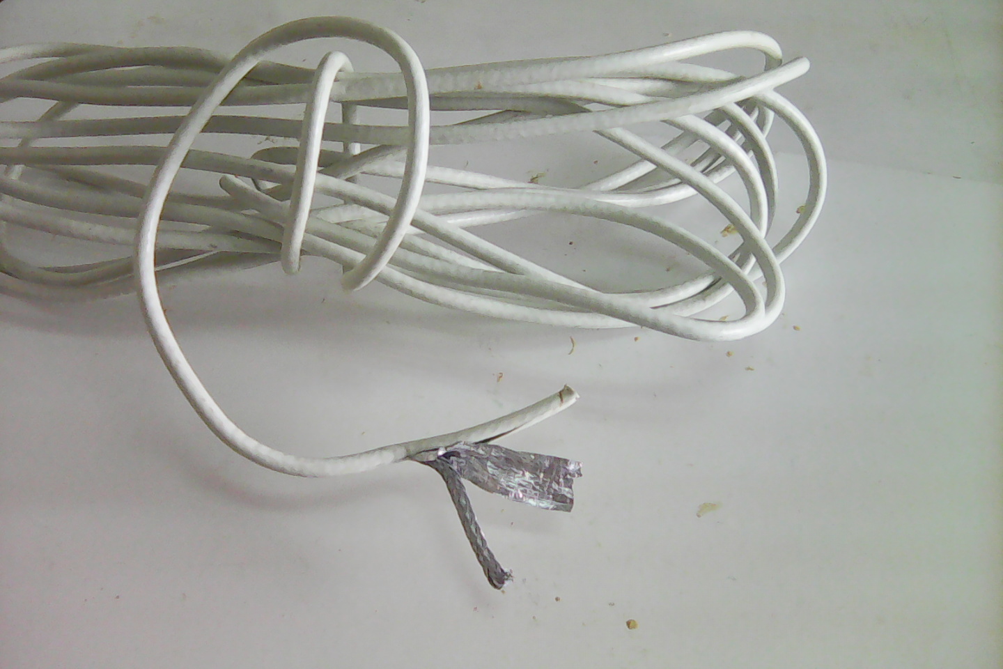

      I can suggest that you read through the various threads on coil shielding , it will give more insight into various experiences by other members. Some even make there own soup concoction containing graphite powder.
      I used the shielding from the cable company wire coming from the road to my house, and it worked for me, so I looked no further!!
      I'll post a photo of the cable stripped to reveal the shield.

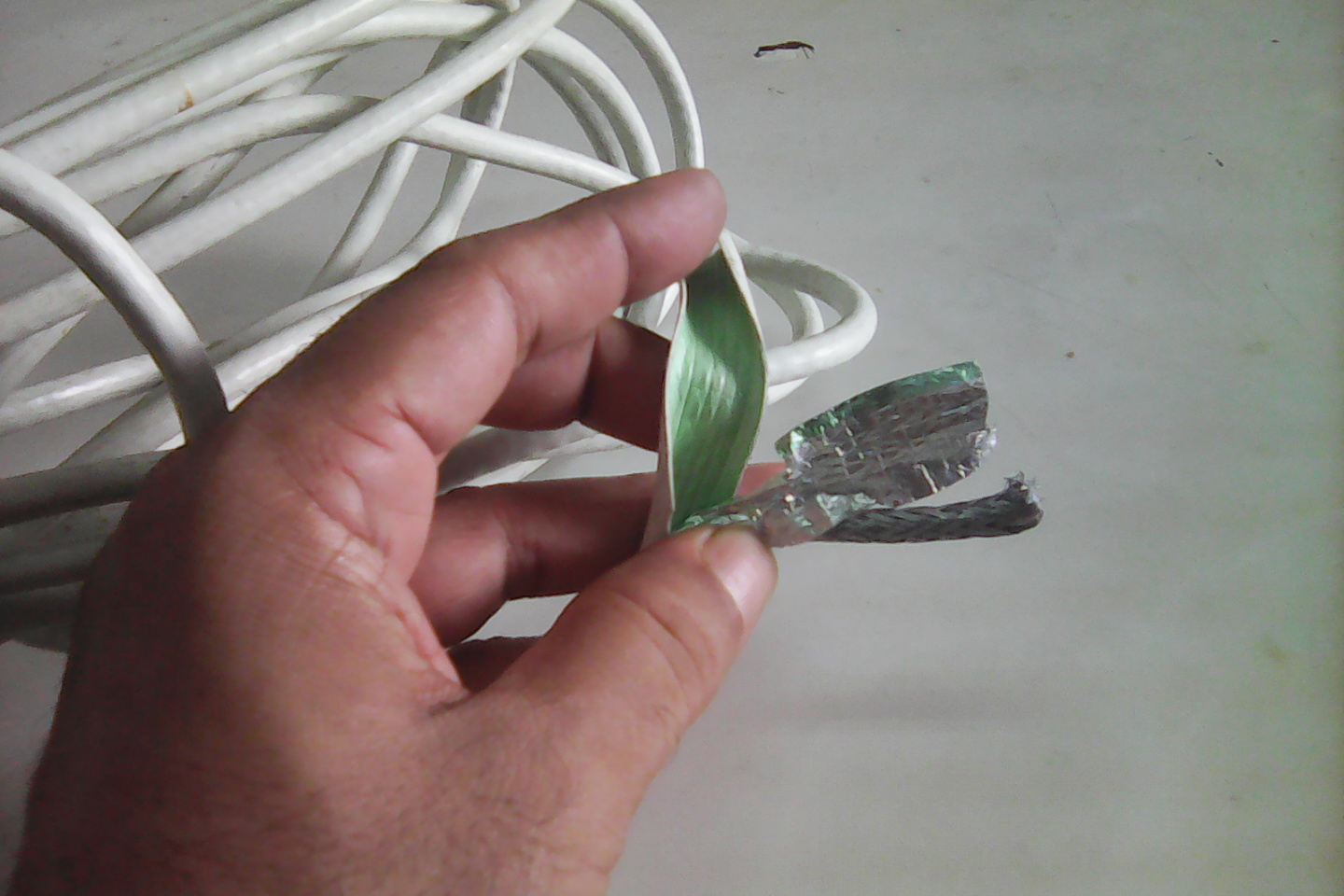

      • #48
        I noticed that there is a green coating on the inside of the outer tubing. I wonder now if this is the actual mylar coating and the other is aluminum. Yikes!
        Anyway, the big boys use graphite for shielding coil housing, so in the end, this is the best way for shield. Remember, it is for shielding the coil from the ELECTROSTATIC EFFECTS of proximity of coils to the ground.
