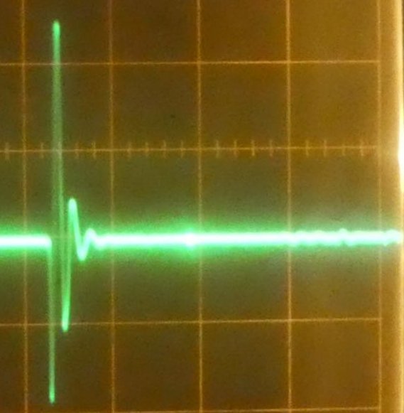

    That looks like a rapidly decaying pulse.

            I am thinking the same. I did expect the noise to decrease with C6 shorted.
            The noise I get at U104 & 105 is not a singlur pulse but a steady Waverly at low frequency (in filter pass band).
            I use the TL081 which are nearly the same as the TL071.
            Next was to see what your RX to GB sample looks like which is set with coils. This is where I had a hard time and reduced distance.

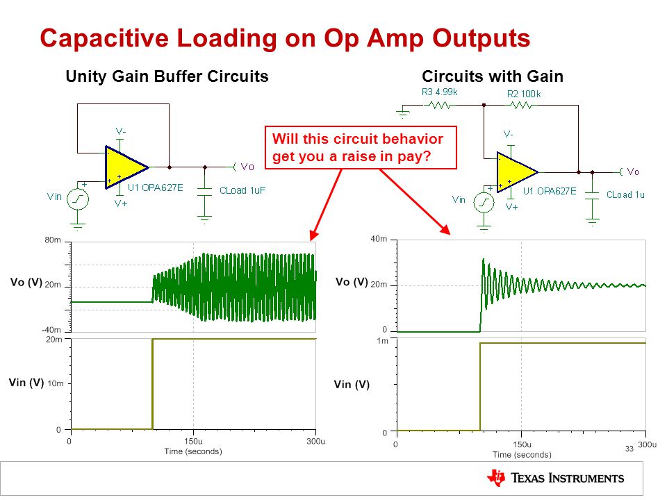

              The scope shot shows a distinct pulse which has a decaying oscillation. It looks strangely similar to oscillation of op amp due to capacitive loading. The 308 chips may be the culprit. Check to make sure you have correct component values in the feedback loop of these op amps.
              Maybe try 072 or 082.
              There is always the possibilty that you have fake 308 chips. So they are op amps, yes, but they're not 308. See?
              Here is a pic of what it looks like(oscillation due to capacitive loading). Look familiar? Maybe, Maybe not. Anyway, exploring possibilities from afar is fun, I get to read some stuff for research.
                If you zoom in, you can see on scope that at U105 output, the oscillations continue on much longer. It looks like RINGING. Op amp oscillation due to capacitive loading? What do experts say?????????
                All this is just throwing things out there, like guesswork. But it does make for interesting learning.

                      I tried to replace the LM308 with TL081 and I also replaced C14ab and C17ab with 22 uF electrolyte capacitors. I rebalanced the coil and now 1 euro coin has gone from 13 to 18 CM!!! Everything here thank to YOU. Now I would like to try to change the shielding of coils using graphite paint but I do not have the material at home; as soon as possible.

                              If the scope sweep can't stop it, then it's because the triggering threshold exceeds the noise threshold.
                              That means the amplitude of the noise you were seeing before(which I suspected to be op amp ringing) is now greatly reduced or gone.
                              Changing the chips has made the difference.
