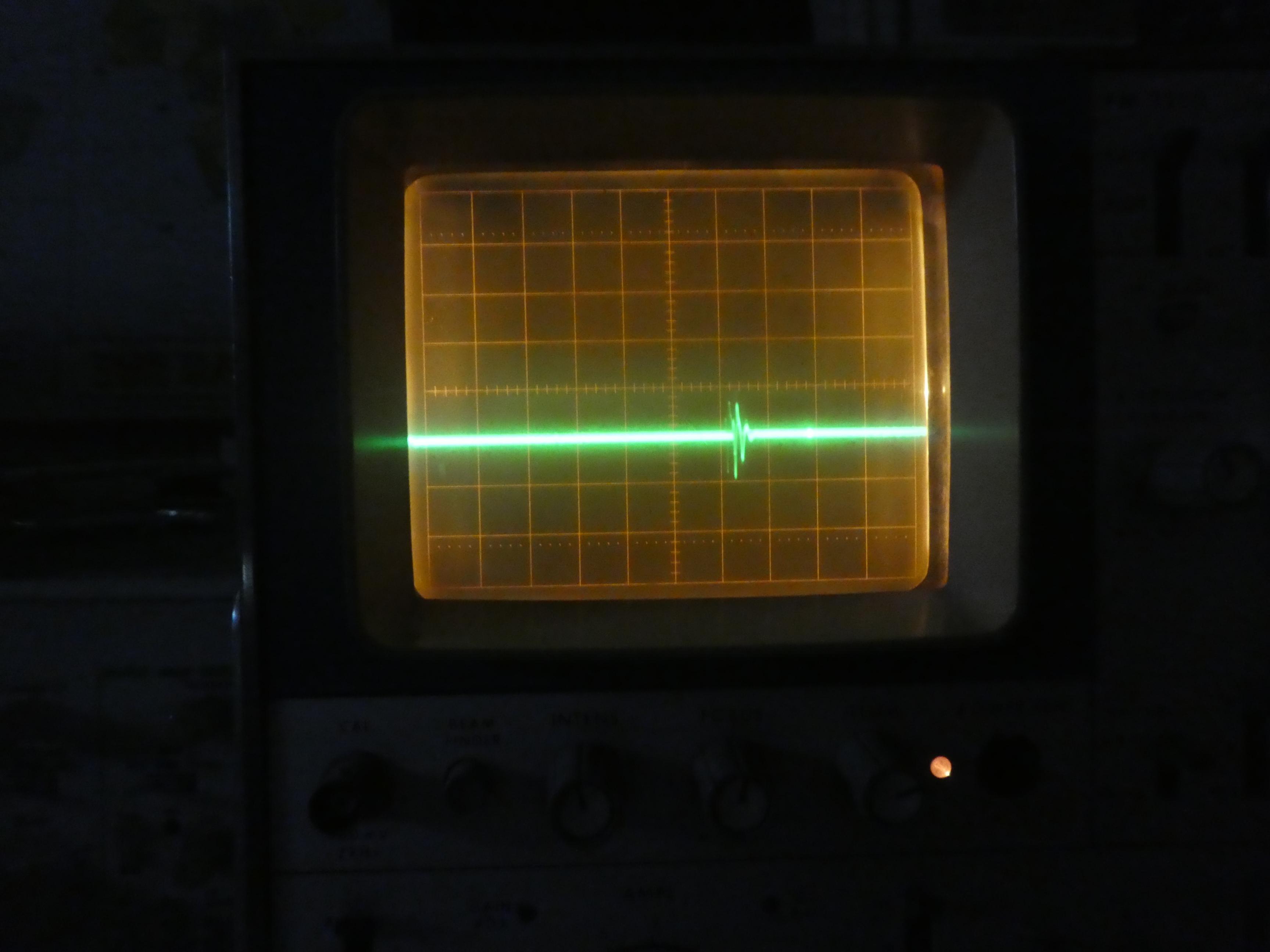

    Another test to try.
    Measure the Vpp of the outputs of U104 & 105 but put a Short across the RX input at C6. If the Noise at U104, 105 drops to ~5-10mVpp then you know the coil is picking up electrical noise and your circuit is working fine.
    I just checked this and noise went from ~50mVpp to under 5mVpp when shorted C6.
    There are so many item that produce electrical noise. Almost ALL of the wall-warts (AC to DC power bricks) run switching PS at 10's of kHz. Also computers and monitors put out lots of noise.
    If this test results in low noise at U104, 105 then you MUST get the TGSL outside away fro electrical noise to evaluate detection distance.
    Lets us know how this test goes.

        Good morning Waltr,
        as you suggested I tried measure the noise with the RX coil short but the values have not changed; in the afternoon I'll try to take him out then we'll see.
        Thank you and have a good week
        Tony60.
          Ok, that seems to indicate the Noise is within the circuit.
          What are you using to power the TGSL? A battery is best.

                    Did you re-measure the noise at the outputs of U104 & 105 while shorting the RX input (C6) and powered from a battery?
                    If the noise at these two op-amp outputs is too high then you will not get good detection distance.
                    Shorting the RX input removes any effects due to the coil. Do be sure to make a very short jumper across C6.

                          thenk you for your words of courage and help you and other friends. This morning I still performed a noise measurement in these conditions: battery 12.1V RX input on short, neon, router and cellulars on off but nothing has changed; I would like to try to replace LM308 TL070 I don't know.

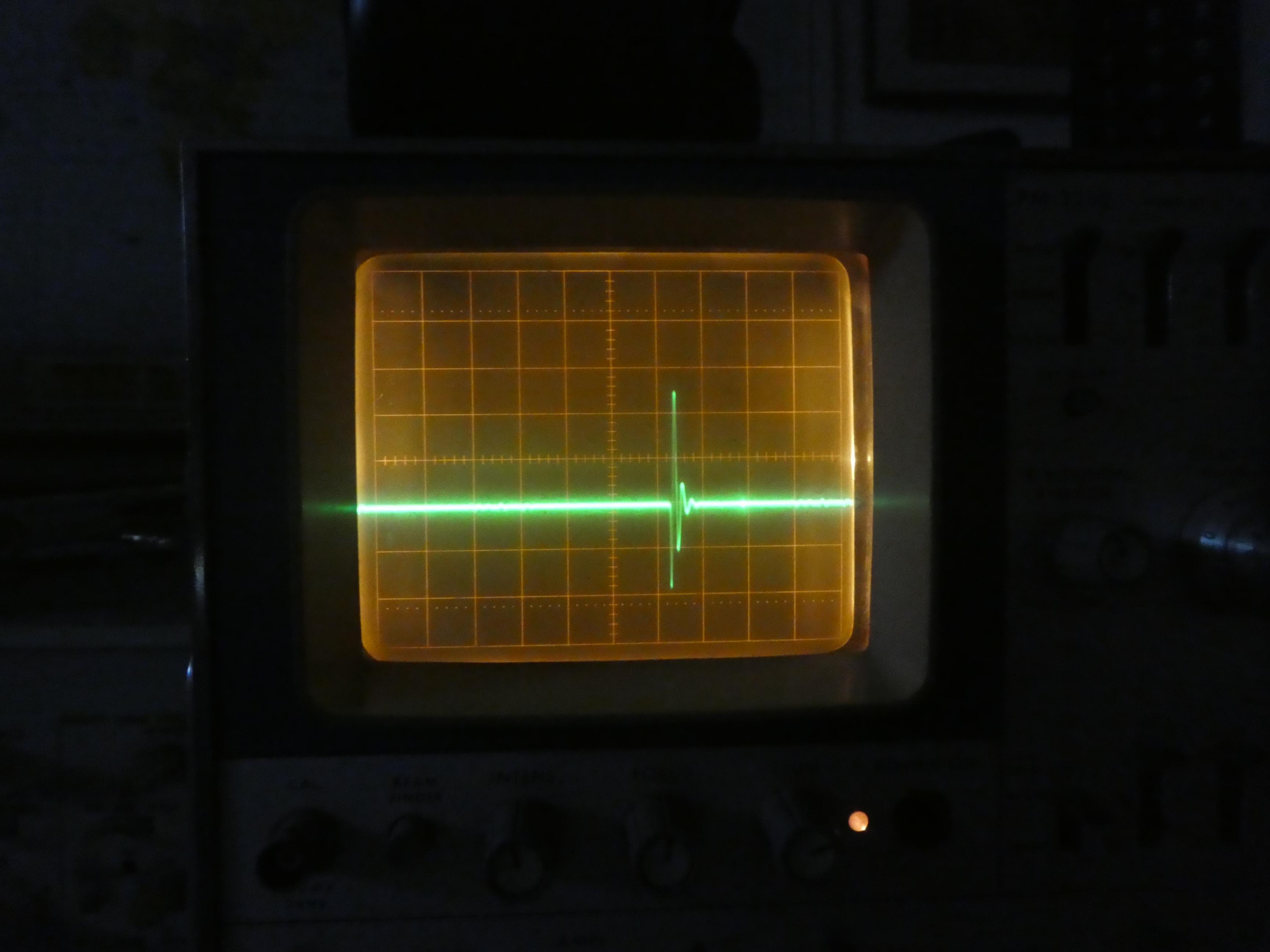

                              Excuse me Waltr,
                              for the this morning measurements I have two pictures; scope are setting 50mV/div - 10uS.Click image for larger version
ID:	355461Click image for larger version
                                That looks like a rapidly decaying pulse.
