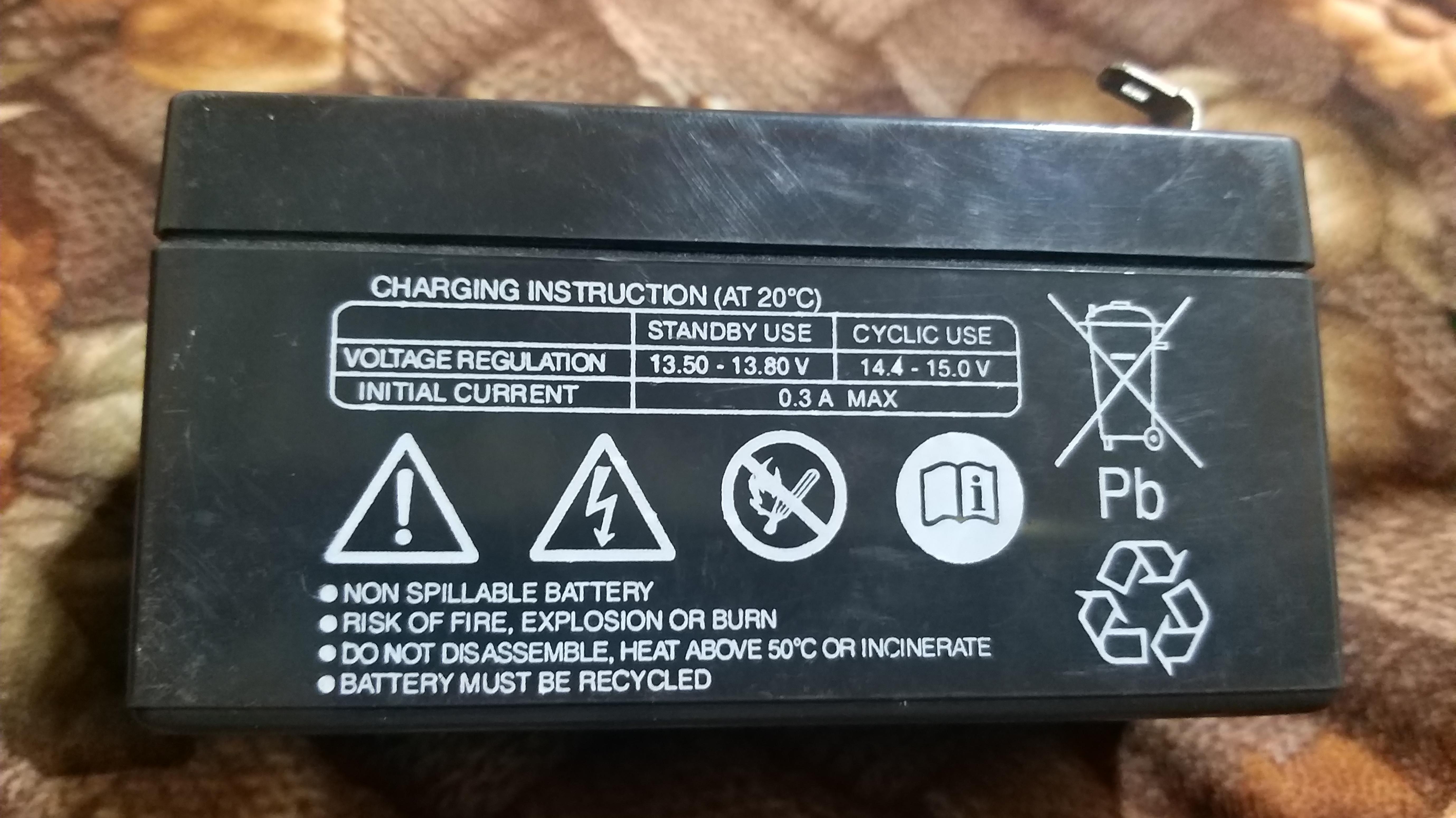

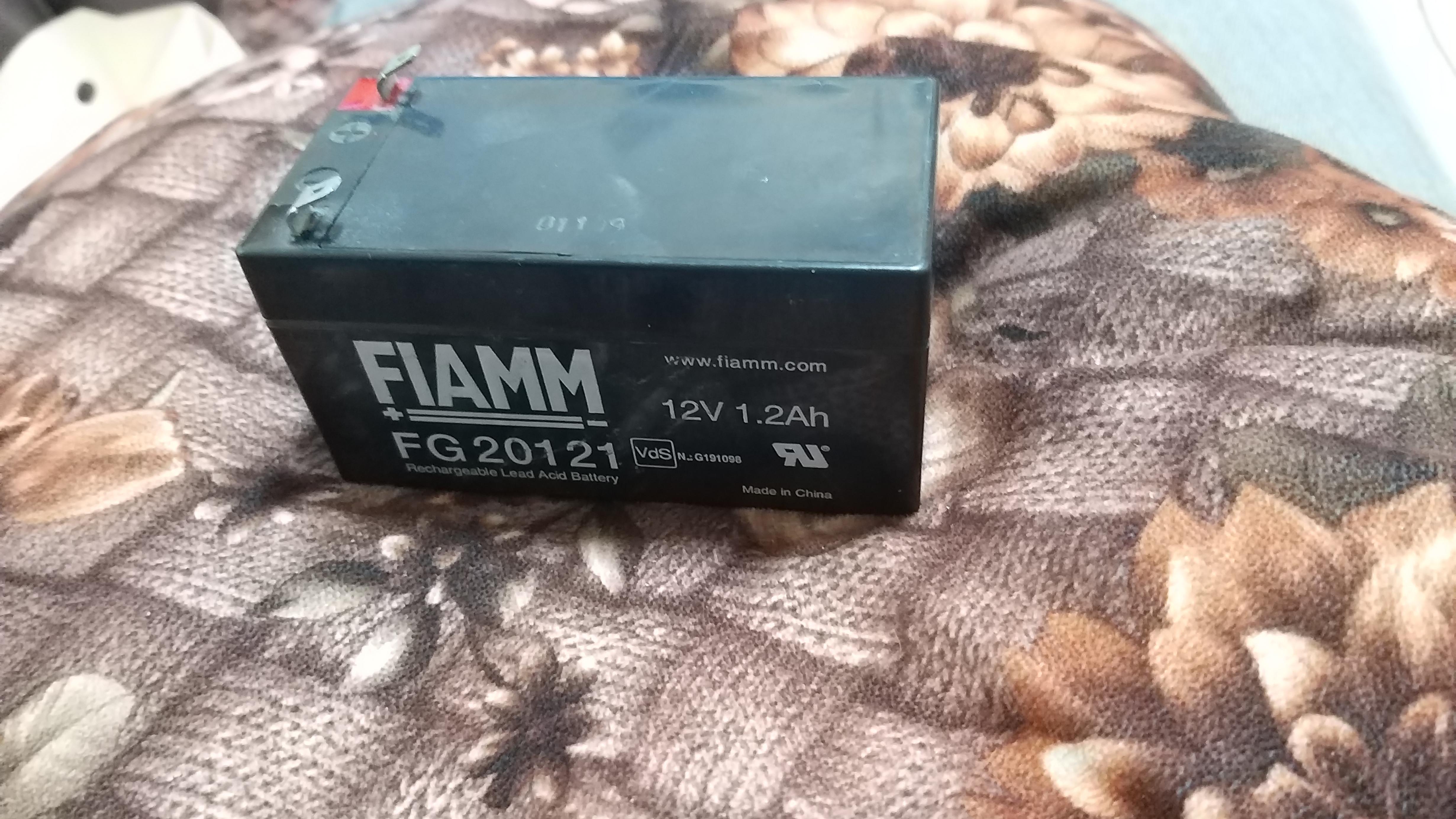

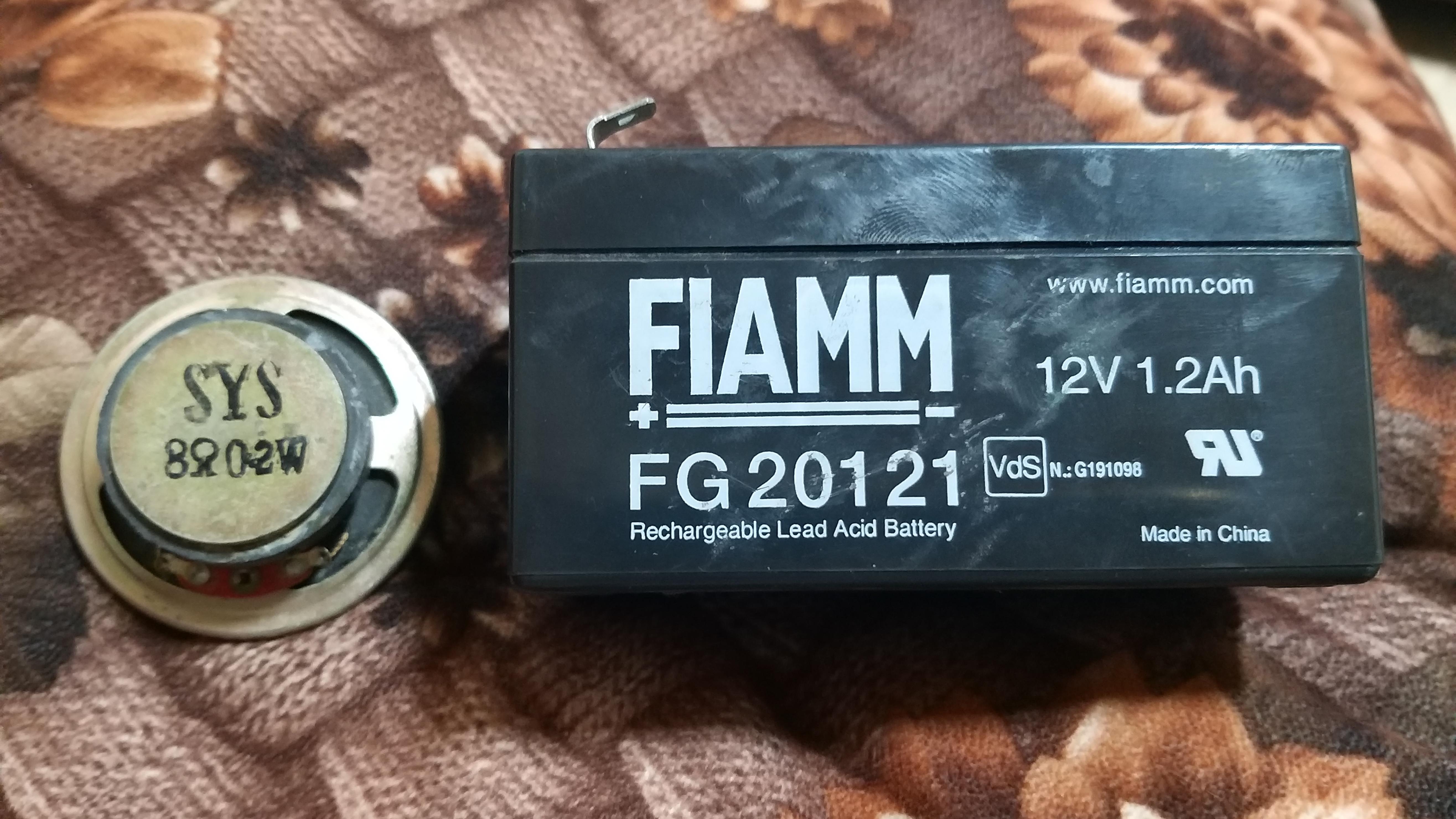

    Hello everyone. I'm building a tgsl md and I'm wondering what type of battery and speaker I should use? Check the image below and tell me if it is fine to use those ones or I have to get another bat and spk? .thanks for helping
    That battery will work for many, many hours but it will be heavy to carry.
    The TGSL draws about 30mA without sound and about 50-80mA with sound.
    So at 50mA average draw that battery will last for 1200/50 = 24 hours.
    Other than weight the battery will work fine.
    I use a small 3-cell LiPo battery that is about 2x3x4cm. This runs the TGSL for over 12 hours.
    Speakers are a little harder to tell if they will work. Many have complained of bad sound with some speakers.
    I use a similar speaker on my TGSL-EDU (PCB from Silver dog) and it works.
    You will need to connect it and listen to how it sounds. If not sounding good then try putting a 100 Ohm resistor in series with the speaker.
    There are many posts about this detector since it is very popular. Try reading them for ideas, issues and fixes.
    I like how the one I built works.
    good luck and please post pics of your build and how it works.
      i use 3 18650 that last for a very very very very long time. As for the speaker a .2watt 8 ohm speaker is more than loud enough for parks but not for places along a highway, headphones are better.
        use 32 Ohm or 50 Ohm speaker for low-current VLF. https://www.aliexpress.com/item/4000...chweb201603_55
          use 16 Ohm headphones. connected it in series (GND wire is not used), mono-, gives you 32 Ohm general value.
